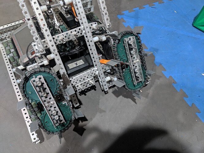

How were you able to make the intakes move inward to “clamp” on the stack of cubes. I have a design in mind but it would be a lot better with the capability to move out. If possible could you show pictures?
I’m not sure how he did it, but you could use rubber bands to pull them towards the center and they would stretch as the intake expands
The rollers are mounted on joints on both sides. They are tensioned inwards by rubber bands, but when the tray pivots forward, paracord tightens and pulls it apart.

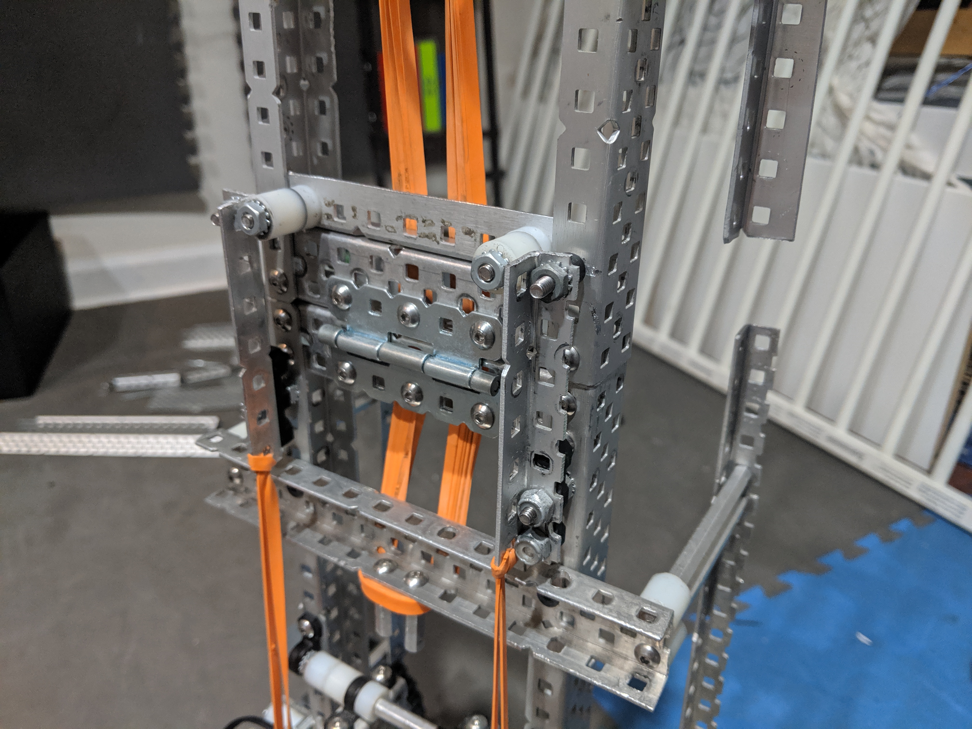

What locking mechanism do you use for the tray?
Here’s a close-up of the lock. The two pieces of half c channel pivot out of the way to allow the tray to fold back for starting position.
