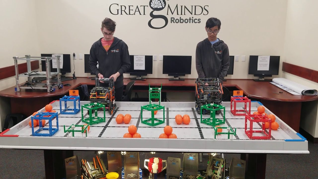

Since near-perfect or perfect scores were possible in the past two years, this granularity of scoring, along with LOTS of big elements (27) that will likely need to be manipulated one at a time, is a welcome change.
A perfect score of 170 was achieved and video documented for Squared Away (not in an actual competition, but still).
But this year’s perfect score of 321 does not seem achievable. All 27 risers would need to be manipulated, and 18 of them stacked, and roughly half of them carried fully across the field. To be able to correctly place one every 2.2 seconds seems impossible.

Yes, that’s the video that I saw too as proof of a perfect score. Pretty insane! Also really nice that the two robots had very different designs. That scoop is elegant as heck.
