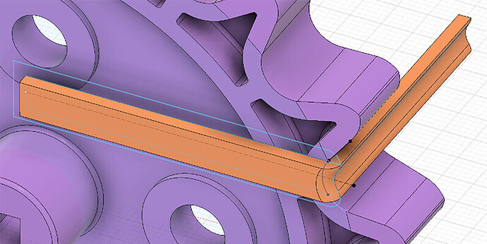

Does anyone know how to create a rubber band roller in CAD? I created the roller but how do I put rubber bands on it in Fusion360?
Sketch on the face of the sprocket to the cup of a tooth, expand that by a mm or so, extrude the two sections, loft to join the two sections, mirror to the other side of the sprocket, mirror round the other sprocket, then make a circular pattern.
wait, what? How do I create a sketch on the sprocket that folds the same shape as the curve and how do I angle it at each groove so that it is the correct angle?
Create a sketch on the face of the gear (circle with Y shapes off it). Project the necessary bits of the tooth curves into the sketch. Draw the straight lines. I guess ideally I (or whoever) would record a screen cap tute of the process if it’s a Fusion familiarity thing. I can’t do that just now, and won’t promise. Maybe that should be its own post somewhere off the TP specific stuff. In the meantime, just drop in a cylinder that indicates the swept surface of the bands. Set its transparency to something helpful, possibly in the region of 30%. You could equally drop thin cylinders roughtly where the bands would be between the gears in a circular pattern. They don’t have to be flat straps for illustration purposes.
