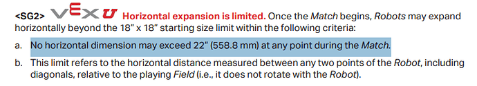

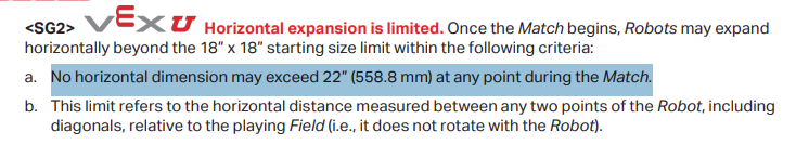

@VEX_GDC sg2 is (hopefully) written wrong. The diagonal of a 18x18 bot is 25 inches so it literally requires cutting the corrners for a bot to fit in the 22 inch circle created by sg2b.
If this is intentional for some reason this vastly changes robot (specifically drivetrain) design and I am very interested what caused this change.
hey any thoughts on SG2 in the .1 rulebook? it seems so limiting to have the expansion box limited by field orientation, right? also, the way it’s worded it sounds like the robot will not be able to exceed a 22" circle all the time, with the words
;;No horizontal dimension may exceed 22” (558.8 mm) at any point during the Match.;;
and with the way it talks about it in the rulebook it seems like that includes diagonals too. so having an 18 x18 ‘’ robot is illegal, because the diagonal would be 25.456’'.
soooo any thoughts?

About the expansion rules, since the horizontal expansion does not rotate with the robot, does that mean your robot can not be exactly 18*18, since when rotated, it will exceed 22 inches??
You were correct. Expansion rules, as written in the v0.1 of the manual, really have profound effect on the game.
For example, they make your 18x18x18" hero bot in violation the very second the match starts.
Yeah, that is pretty much what I thought too.
