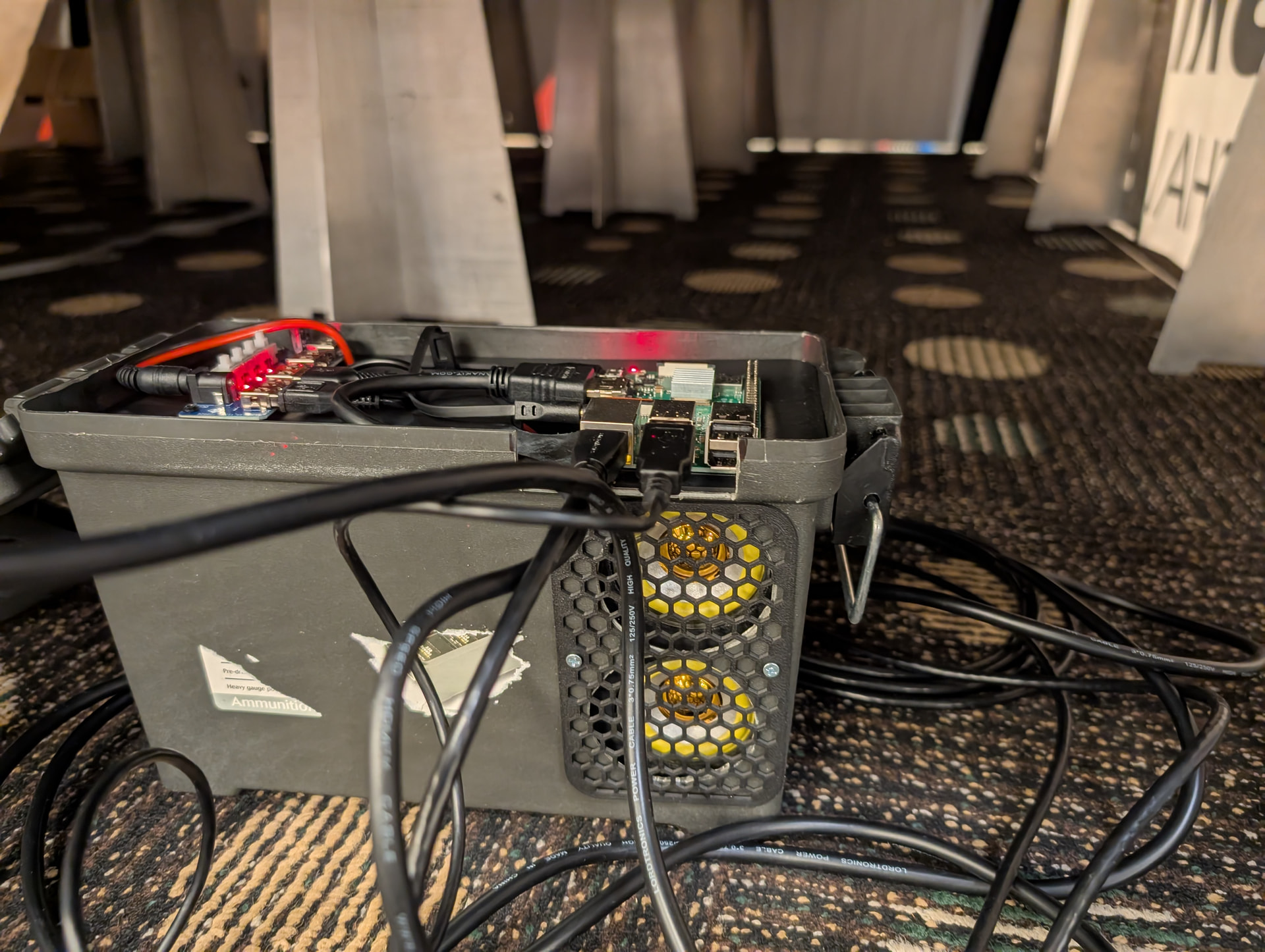

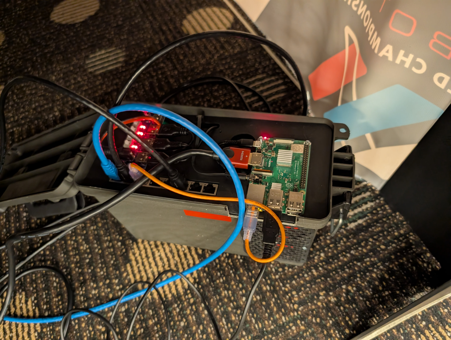

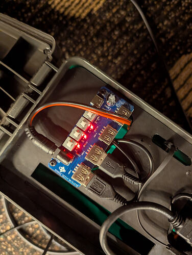

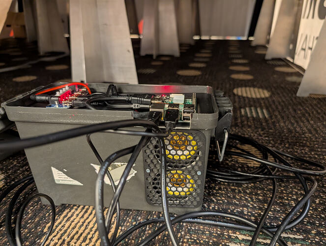

Does anyone know who put together the field controller boxes for Worlds this year? They’re a plastic ammo box with a Raspberry Pi, USB power module, a small ethernet hub and speakers. I’m assuming they’re a homemade item? I’m curious if they’d be willing to share the parts list and specs.

Ethernet cables to everything. There was a difference in design between competition and skills fields: Skills field sets had a small ethernet hub/switch so that the fields could be daisy-chained. Competition fields did not have the hub and were hard-wired directly to the control table.

Here’s a couple of photos I grabbed. These are the skills boxes with the switch. I like the little USB Power module, but I have a couple of EPs in our area that have moved to PoE switches to provide power to the fields. I’m going to have to do some research to see which is more stable.
