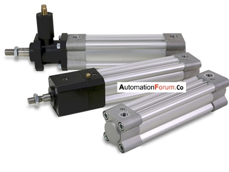

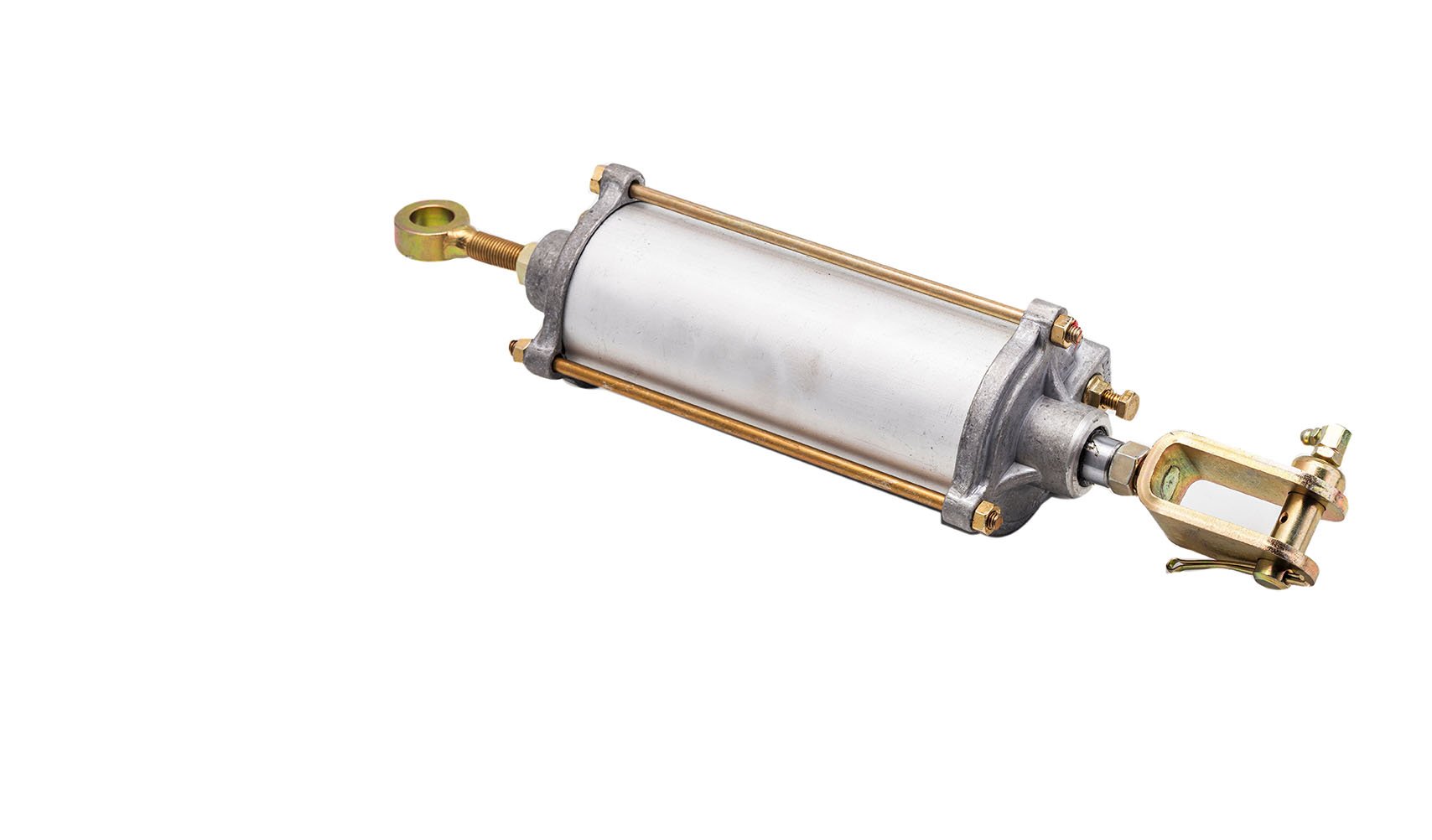

Would it work with single acting Pistons?
There shouldn’t be a problem adapting single-acting AIR CYLINDERS. The issue is just a direction of force. A double-acting AIR CYLINDER can provide up to 12 lbs in either direction, while a single acting AIR CYLINDER can extend with a force of 12 lbs, but retracts with only it’s internal spring force, which is pretty minimal.
But he was asking about pistons! :wink:
FWIW, the vex product site never describes them as air cylinders, just cylinders. Despite the nomenclature choice of vex, the items in question do definitely include a piston. IMO, piston is a reasonable way to refer to the item, as that is the moving part.
The main question I was asking about the single acting cylinders was if the actuation direction could work with this mechanism. This video shows double acting pistons pulling in. So I was wondering if, with the nature of the single acting cylinders only exerting a reasonable amount force by pushing, could they still work with this mechanism? And if so, how?
@2775Josh
You would install the cylinders into the mechanism so that they extend to lift the mechanism.
As both an engineer and an educator, I think it is important that we teach our students industry standard terms for the components that they use. Those of our students going on in engineering and automation careers will benefit. To someone who works with hydraulic and pneumatic cylinders, referring to a cylinder as a “piston” sounds just as silly as if you referred to a motor as an “armature”
Thanks for the detail, the armature/motor distinction is apt and clarifies this for me. My background is architecture, not engineering. Rubs me the wrong way when people call joists “beams” and lazy authors call every sort of structural element a “strut.”
I’m pretty sure this is wrong, even though it doesn’t have a spring as air expands to fill the piston it loses pressure and thereby force throughout the stroke.
But like you said, the approximation is really good enough lol.
Vocabulary aside, this mechanism is really really simple to build with a double acting piston but a bit harder with a single acting. Off the top of my head, you could make a lever that’s pushed by the piston on the bottom and thereby pulls on the top. Or just use a 1 piston claw 2 piston tilter :man_shrugging:
