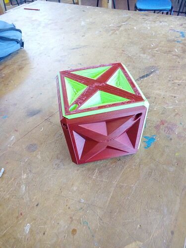

Just finished printing the OP’s hollow one
@matthewb Is that full scale? Also, did you print with/out supports? Any tips for printing this cube that you could suggest? Thanks!!
Yup full size. Our mentor put the print on so I’m not entirely sure but I don’t think there was any support material (maybe some in the triangular dimples on the bottom). I’ll check with him tomorrow but afaik it was pretty standard. Thanks for putting the model on thingiverse btw!
So apparently it got printed on very low resolution (3.25 somethings?) which messed up the holes that lock the two halves together. They needed to be drilled out to connect. The hex holes that the nuts are supposed to fit in also bulged slightly and make them difficult to insert. So if you’re going to print it, go for a fairly high density.
A small amount of support material was used on the bottom side of the cube to support the inset triangular bits.
