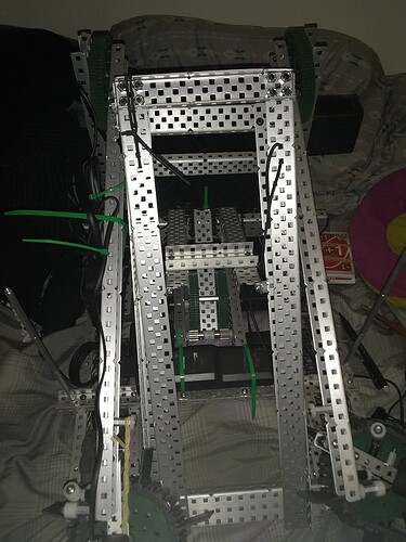

You need to have a cube partly sticking out of your intake for this to be true, but you also lose time from having to tilt the tray, while a passive intake can just open and back up.
I can reassuringly say that a 1 motor intake is definitely possible as we have implemented it onto our robot. It is difficult to fit but it is definitely possible. Hover, it had to be a torque motor since it was only one motor.
My team has been doing something very similar to yours. We saw your video and said “That’s what we’re doing.”
I still don’t understand how the intake is able to flip out and lock using the standoff. Can someone explain it to me please?

I do not know if this question has already been asked but how does your deploy fro your ramp work? I understand that the rubber bands will cause the ramp to fly out but how does it lock once it is flipped out?
It doesn’t lock. It’s just stopped by the C-channels hitting each other.
So me and my team are struggling to make the arms to be able to lift up and down; our arms won’t move and the Axel’s we’ve use aren’t as thick as your axels on your team bot and we thought it could be our axels or not but we was wondering if you guys know what’s wrong with it?
P I C T U R E S are a must for us to help you. The regular axle will bend under all the weight which is why most if not all teams use HS axles.

I’m making a digital sketch on Onshape for tryouts. We were provided with a video only and we are expected to download parts and put them together using onshape and copy this design.
I’m making a digital sketch on a program called onshape for robotics tryouts. I am not trying to copy this piece by piece for the real thing, but I just want to know which parts to design or download for the program so I can put it together.
