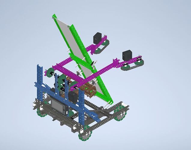

Like so?
I suppose, but we’re using Onshape. We have to download parts from vexrobotics products CAD files and fasten/mate them.
I have a library full of .ipt files of ALL the VEX parts. Would those work?
I think they would work and that would be super helpful.

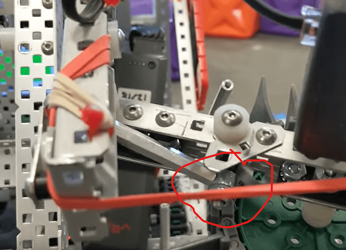

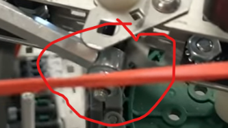

This might be a dumb question but what is the round pivot thing that Goofy attaches to its standoff so that it locks the claw in? I see this everywhere but when I look in the Vex Store I cannot find this part. To me it looks like a shaft collar, but I don’t see how you could attach it to a standoff.

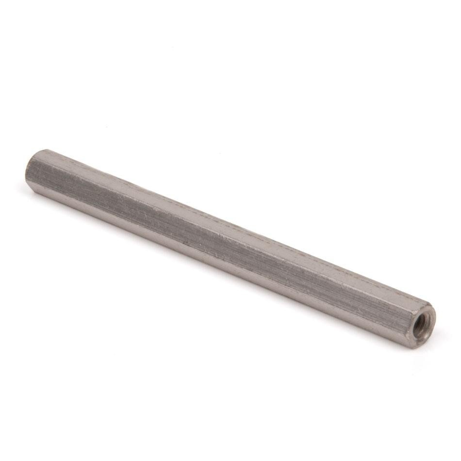

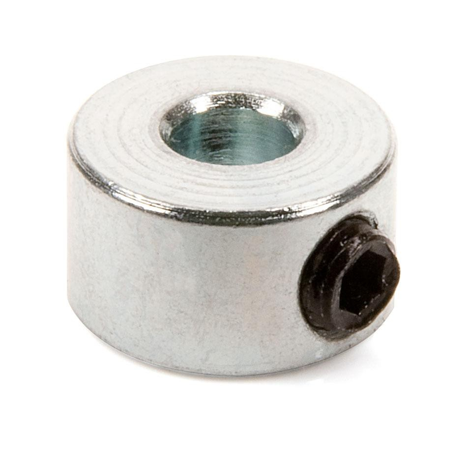

It is a shaft collar, you would need a coupler that can go into the standoff, but would need to be small enough so that it doesn’t go all the way into the shaft collar
ahhh thanks very much

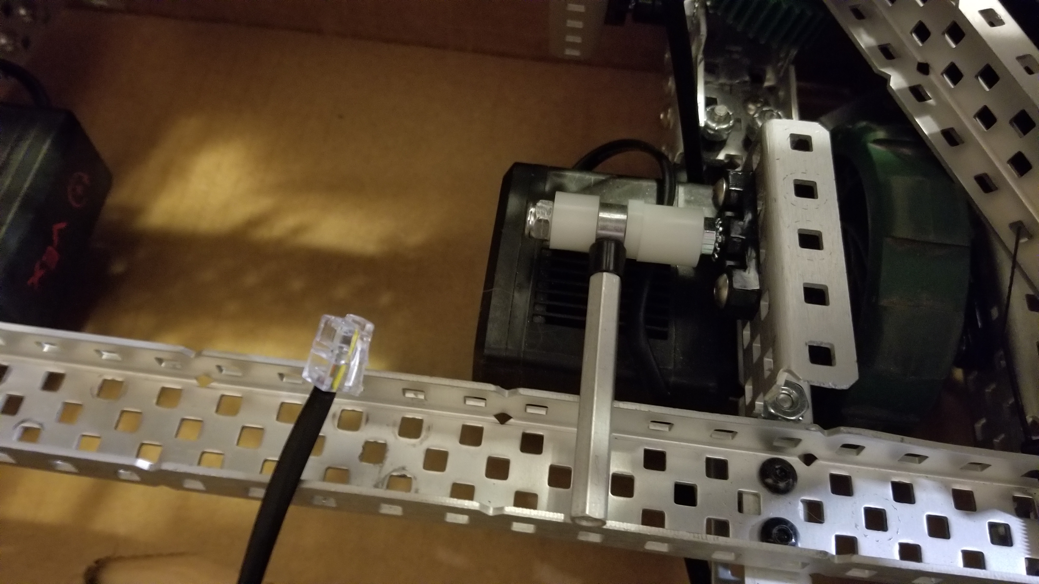

Something like this
you can put a standoff connector in a shaft collar and then put the standoff onto the connector
