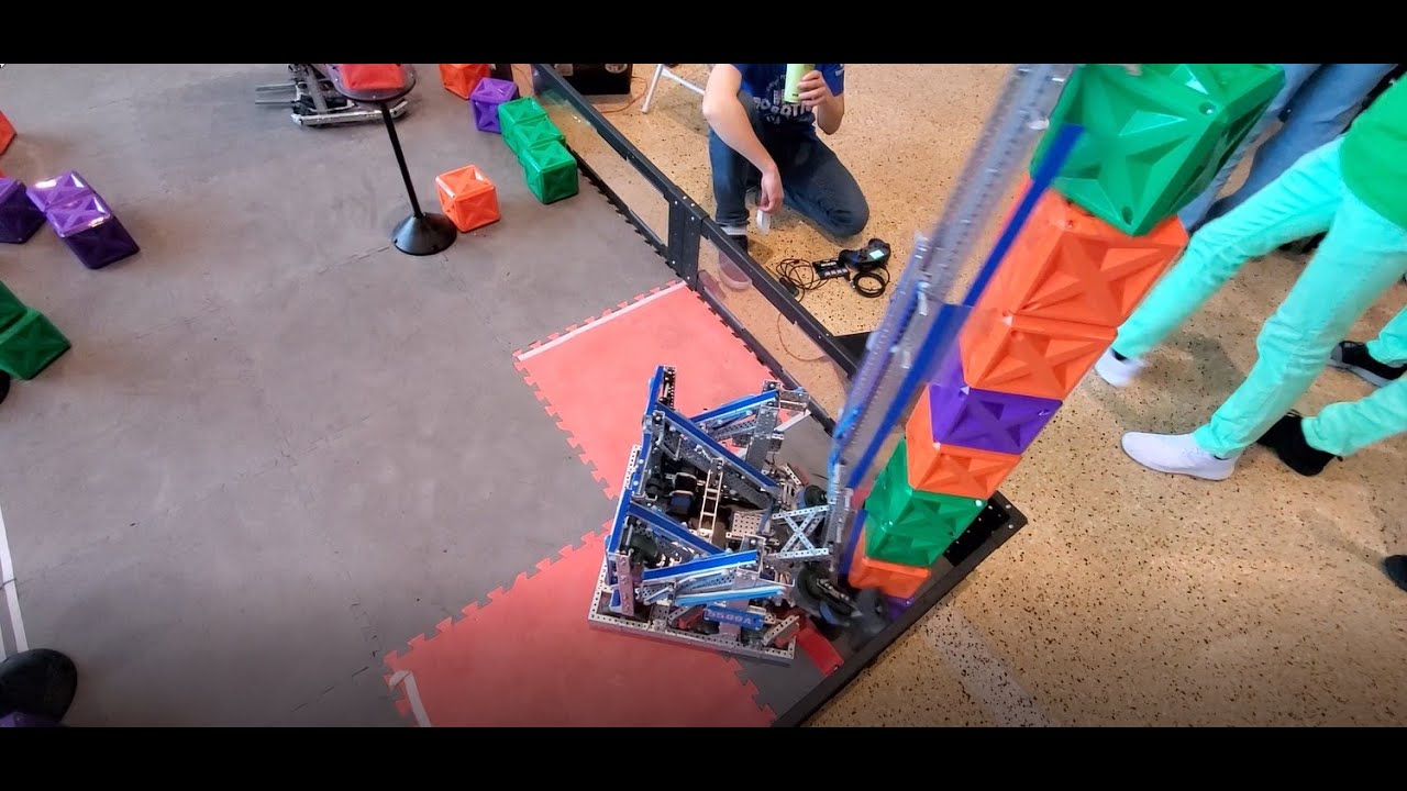

Hello VEXforums! I thought I’d post our 9 cube autonomous reveal here. Let me know if you have any questions. Thanks for watching!
This is insane! If you guys can get it into the deep zone, you probably won’t even need to knock it down. Really nice work!
Nice work! We are in the process of perfecting ours. How do you get your stack to be set down so evenly?

dr4b trays can intake tall stacks easily
We use an offset 4-bar, which places the stack in front of the intake wheels, so we don’t affect it backing away

How did you determine the minimum time the ultrasonics need to re-calibrate the robot’s position? (around 0:09)
Are your curved pathes pre-generated or are they done in real time? They look very smooth. :smile:
Thank you! We actually aren’t using the sonars yet, those are for the future to improve. We use a field positioning system and as a result we can tell it any coordinate and it generates its own movement, which is the explanation for the curves
