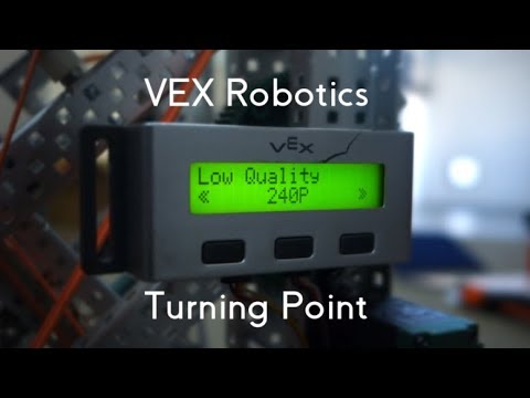

you can power a 6 wheel drive using only one chain per side (by adding chain tensioners). The chain tensioners allow more chain to be in contact with the link. You can check out 240P’s TP robot reveal which did this:

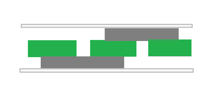

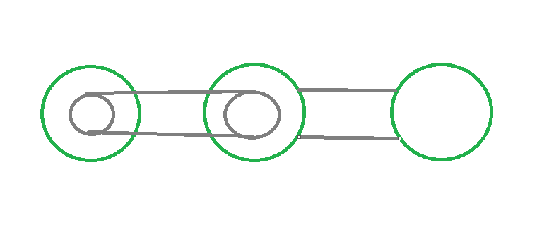

Edit: The other option, if you want to use chain, is to use 2 loops of chain, one that connects the back and middle, and one on the other side of the wheels that connects the middle and the front, like this from the side:
And from the top, with green as wheels and gray as chain:
(Sorry for the crude pictures, I hope they get my point across.)
