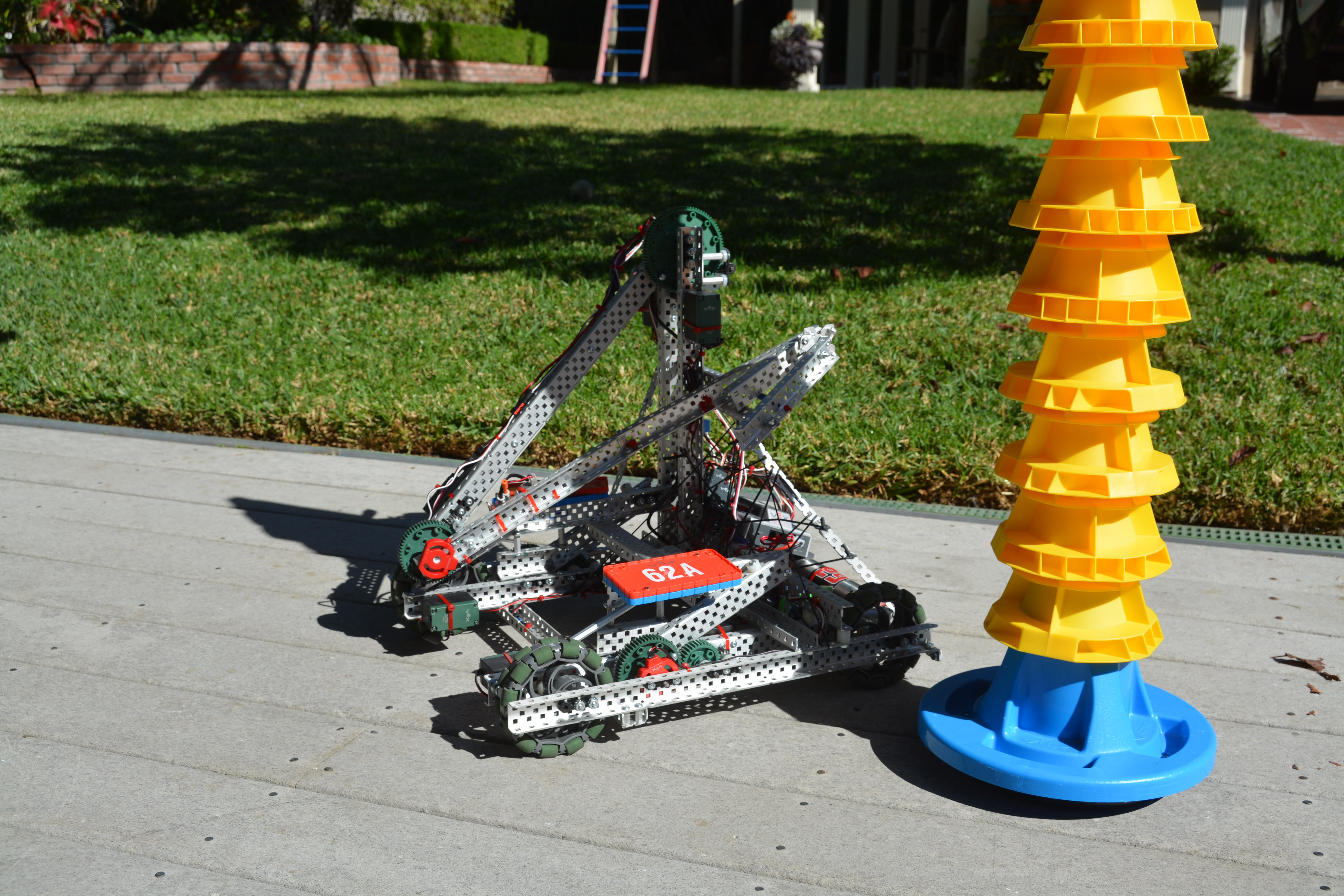

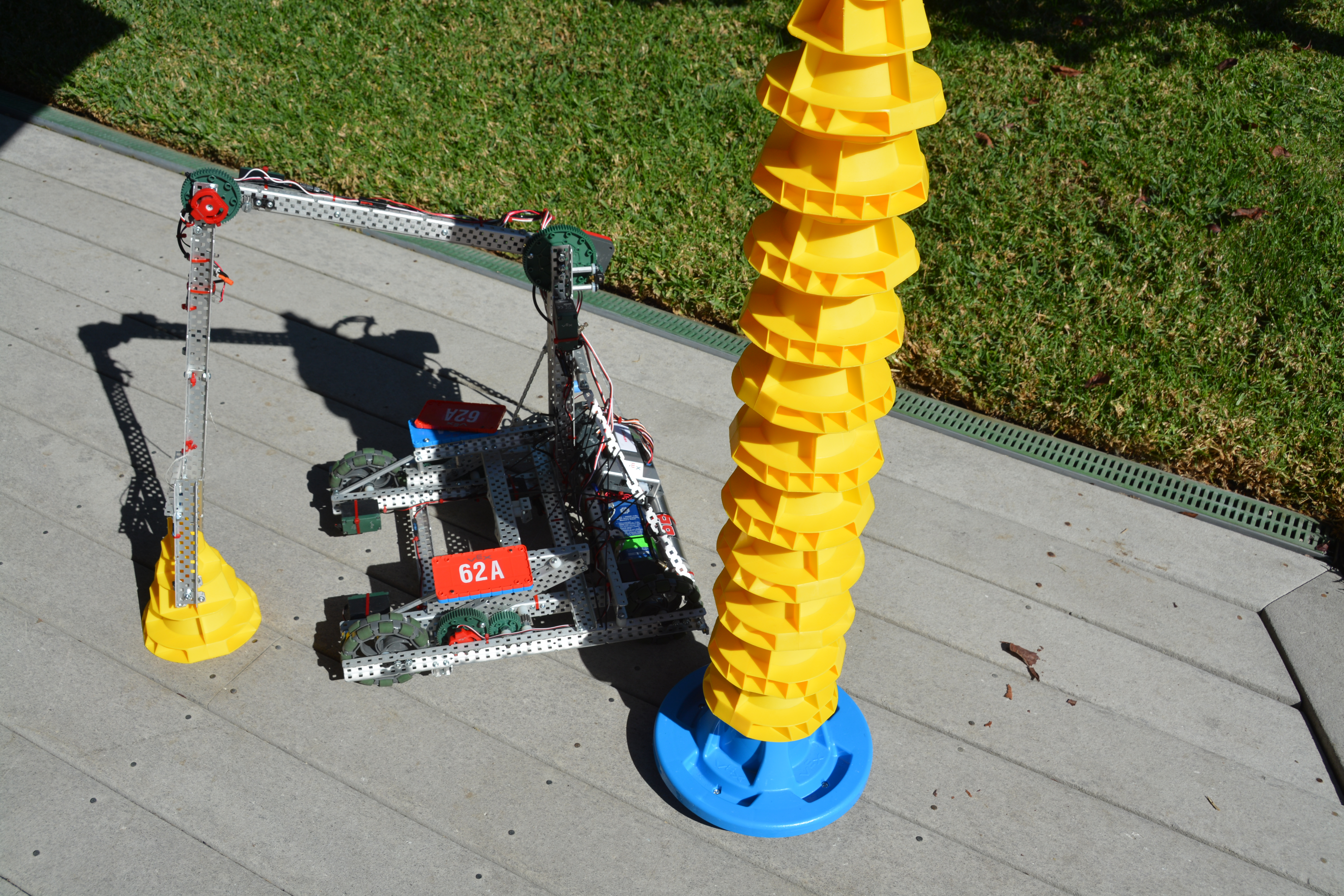

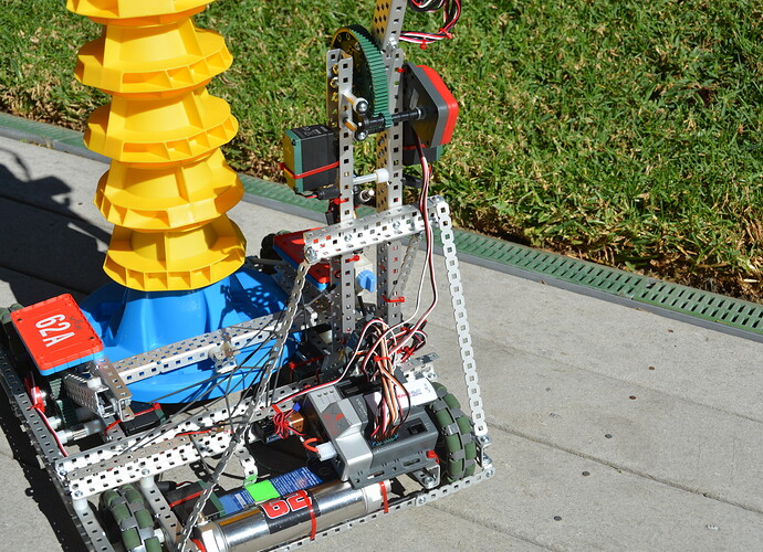

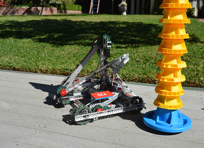

The goal of this robot was to create a very low lift mass/load ratio, as well as hopefully convert some people from the overbuilt, unneeded lift capacities of a rd4b.

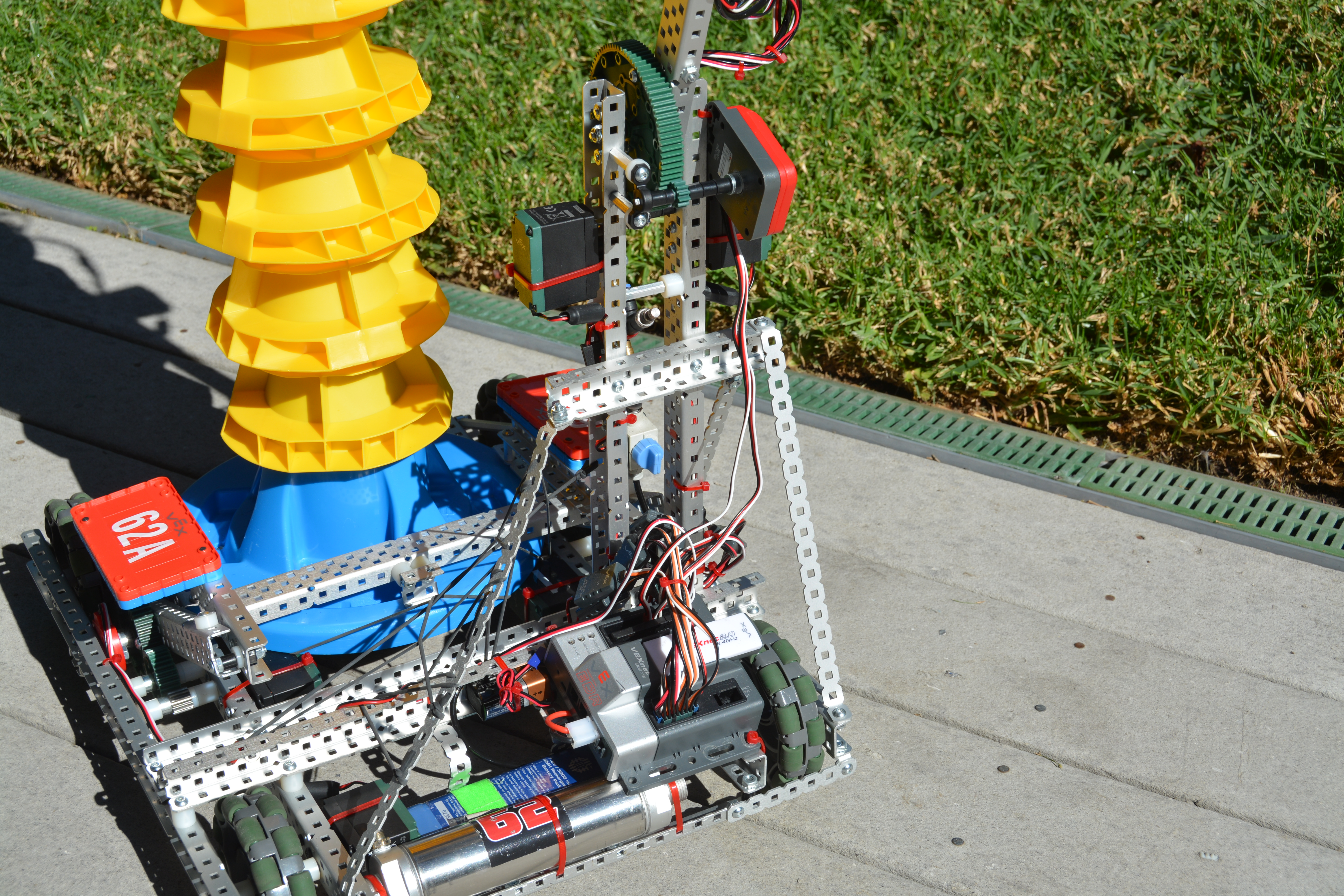

Specs:
  • 1 Piston “pad roller” intake (as seen on ri3d)
  • 4 motor 4" HS drive
  • 2 motor 4 bar mobile goal intake
  • 3 motor “Schlucas” arm
    2 motors 1:7 HS stage 1 arm (Quadrienture encoder controlled)
    1 motor 1:5 HT stage 2 arm (potentiometer controlled)
    12 cone capability
Feedback after first competition*
Pros:
  • super light (≈8lbs with no battery), resulting in a super fast and nimble drive.
  • Mobile goal intake worked amazingly
  • Lift worked very well
    Cons:
  • intake could use some more work
  • the lift was only run at 60% speed due to lack of tuning time
The main takeaway was that the lift worked very well, even despite our main concern of the rotational torque applied by the cone causing the position to be off. However, we found the arm to be much stronger than previously thought. This is a fairly simple robot to build, however, it does take some programming skill. If you know how to program using PID and your considering a rd4b, maybe try this instead :slight_smile:

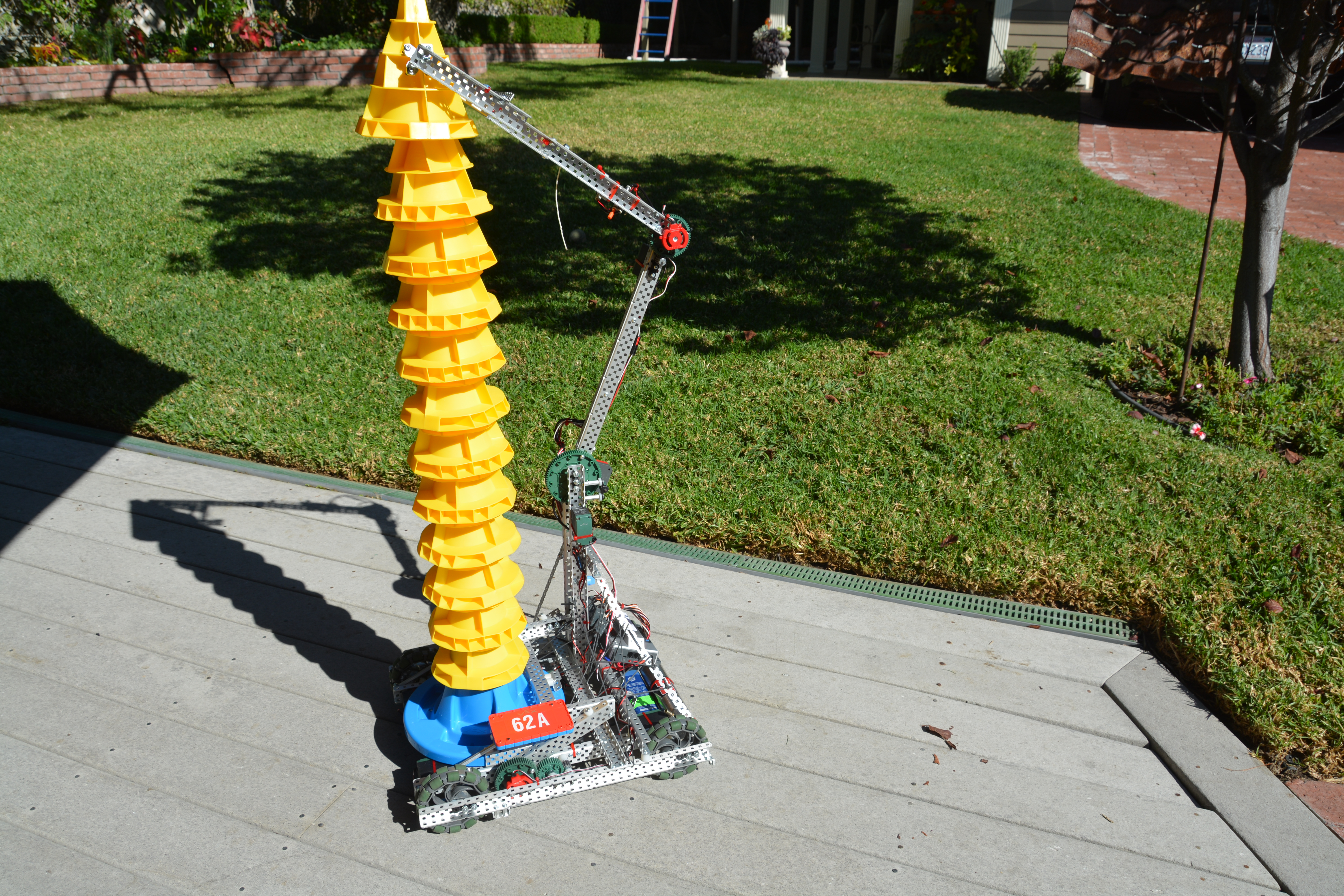

Do you have any video of the arm stacking cones? I am wondering how stable the IK is just using feedback control.

Oh wow that looks amazing.
I kinda want to do something similar now assuming I could get it to stack reliably enough.
I really want to see a video though.
Edit:
After seeing some videos of it, I think that I would rather stay with something that I know will have a good scoring rate. Not sure I could match my current rate if I went with that design.
Dang that arm looks really hard to control. What is your average cycling time? (Time between grabbing cone and having gripper back to original position)

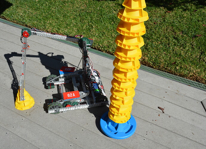

I couldn’t quite tell from the video; how did you keep the cone at the same orientation? Did you just grab it loosely at two points and have gravity reorient it?
He seems to have used the gravity based cone straightening mechanism he showed in the RI3D video (not the reveal).
try 8 minutes 19 seconds. I’m guessing its this but have Cameron confirm.

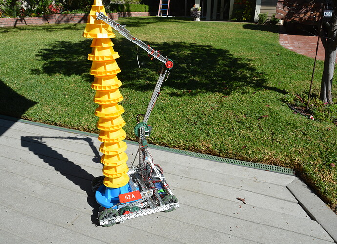

It is a nice foray into a lightweight designs territory, and definitely shows you don’t need 12+ c-channels and 10+ gears to move 0.26 lbs cone. And, if your algorithm changes PID behavior depending on the stack height, that is a great exercise, regardless of the final performance!
Lack of hardware ground reference for the intake definitely made a difference - it could have been much more successful if there was one. You just cannot spend so much time waiting for the cone to settle.
If I was building similar robot I would include ground reference for stable intake and, probably, try to make forearm shorter and faster, while the upper arm longer (you could fit almost 29" beam in a cube).
Everybody, please, follow Cameron’s example and build lighter robots! I am sure we could achieve sub 1 sec cycle time on the cones:
