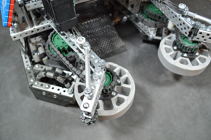

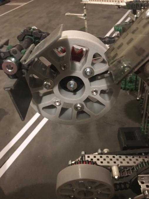

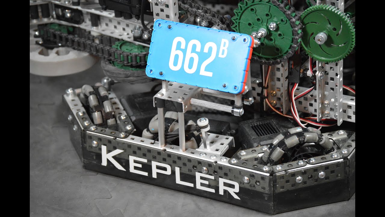

I’ve gotten a couple of messages in various places asking what the 6t sprocket on the front of the intakes are for. So here’s a more detailed answer behind the decision.
They originally had flaps on them that were supposed to help funnel the balls into the intakes for a wider intaking range, but when we changed to 4" wheels the angle from the sprocket to the wheel behind it was too great and they stopped being effective.
A picture of the intakes with flaps before we removed them.
We couldn’t move the sprocket forward, as it would stick out of the 18" starting size, so we couldn’t make them work.
When we had the flaps, I had to be very consious of how close I got to the wall, as if we were too close the flaps would rub on the wall and eventually stall the motor. After removing them, we were able to switch the front wheel’s sprocket from 18t to 12t, which took the wheel up to 900rpm. I then realized that the 6t’s location was perfect for a roller to keep the intakes from touching the wall.
A picture of the current intakes
So far it’s worked perfectly, you can see the rollers in action at 0:48 seconds into the video.
TLDR
It rolls along the wall to prevent the intakes from rubbing.

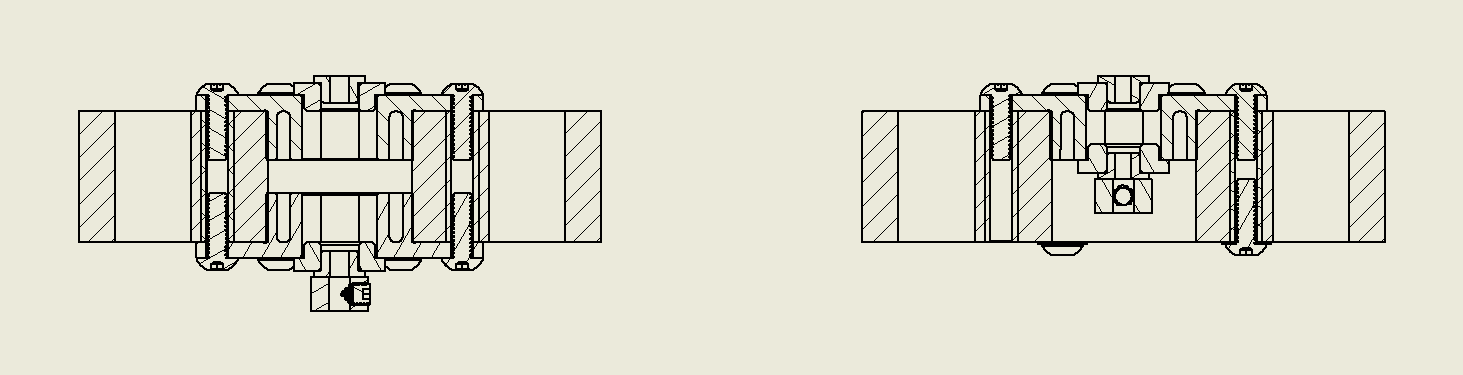

This is honestly amazing. I noticed you only had one of the Versa-hubs in each of your flex wheels. I never found out: Are you supposed to use 1 or 2? I originally thought you were susposed to use 2 but I only ordered 1 per wheel on my robot. Nevertheless, I should put washers on the screws like you did.
Technically you are supposed to put one on each side, but we found out this way also works fine.

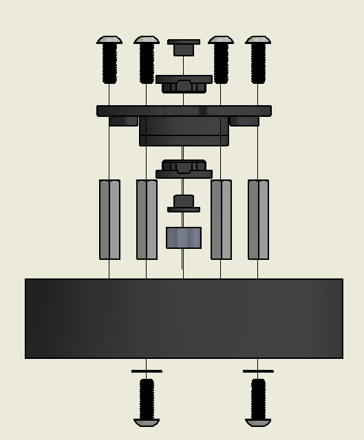

The 3 different adapters[1] you have to use to attach the flex wheels to a LS driveshaft add up and those along with a shaft collar on the bottom makes the flex wheel assembly very thick.
The way we did it was to put 2 Versahex adapters on both sides of the Versahub, and put the shaft collar on the inside of the wheel which made the whole assembly have a much lower profile (and also looks better).
[1] The 3 different adapters are: Versahub, Versahex, and HS to LS.
(Regular way on Left, Low Profile on right)
We didn’t need to have it on our current intakes, as there is nothing for the shaft collar to hit below the front roller. But this would help a lot if it were used on a roller that was above another part of the robot that using the first method would interfere with.
You could make this even thinner by making a custom adapter out of lexan, but I don’t have any experience with that.
E: Here’s a better view of the different parts and how they are put together

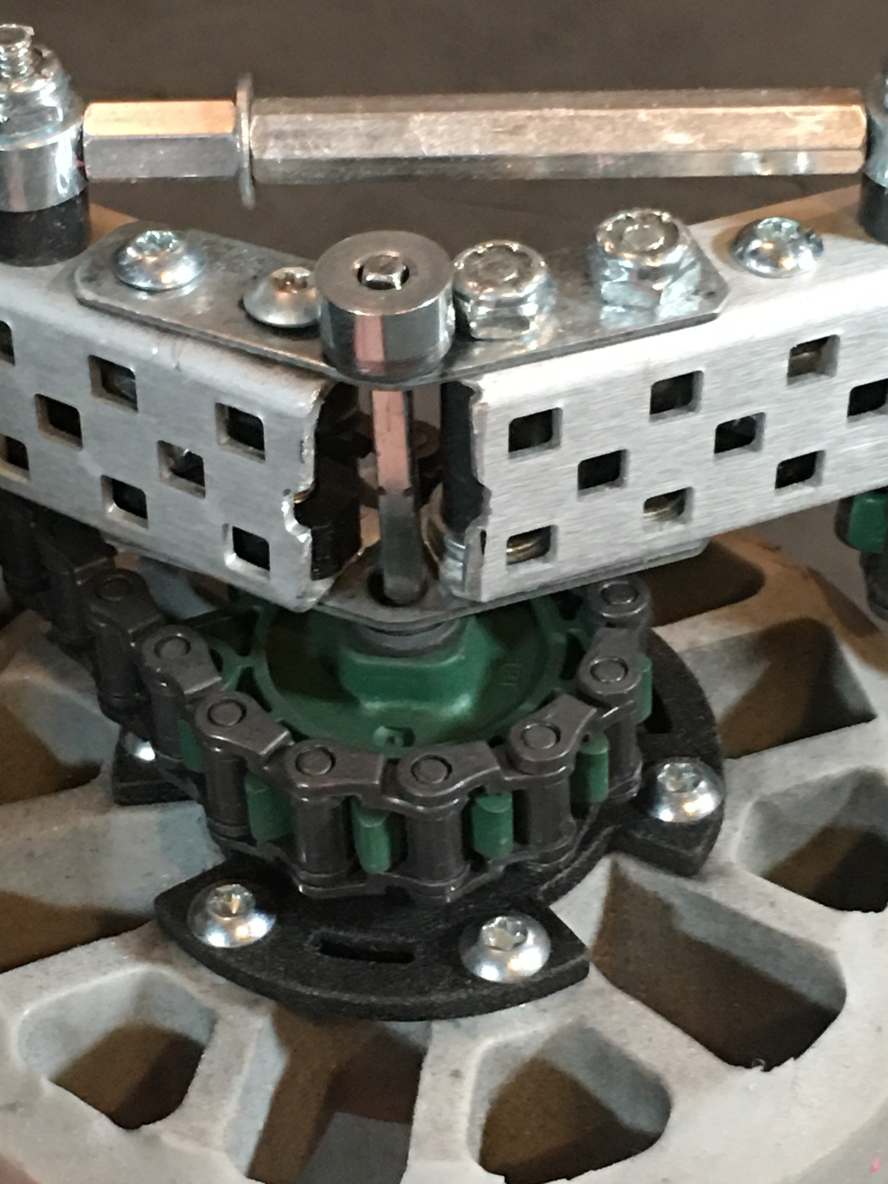

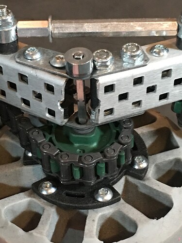

Sorry to bring this back up, but are those custom lexan angle gussets on the x-drive?
Edit: Also, around 1:30, the flex wheels look like they are wobbling on the intakes. would that have something to do with the one hub assembly on the flex wheel?
Yes
It’s not just the wheel that’s wobbling, but the whole driveshaft. It’s caused by the gusset hole being drilled out to reduce friction.
963E8840-3DB8-4D1E-9CEB-676DD58FFFA0
I wouldn’t recommend doing this if you are designing your intakes from scratch. This was supposed to be a quick temporary fix, but we never rebuilt our intakes as they have been performing pretty well.
In general you should use bearings to support a driveshaft to get rid of friction, this way causes unnecessary metal-on-metal friction and has a lot of wobble.
