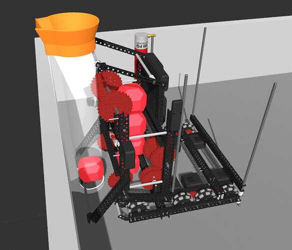

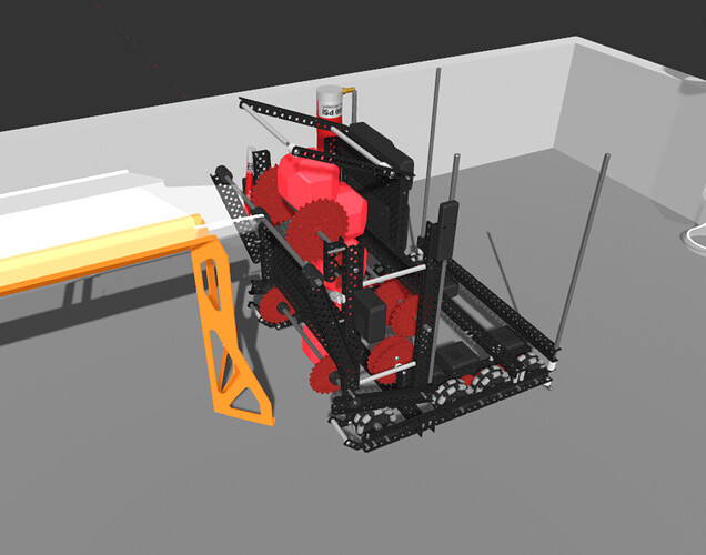

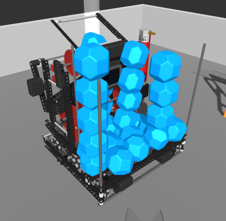

This is my second design for Push Back. It’s a bit over 13 pounds, with 600 RPM drive on 2.75 inch wheels. The capacity is 73 blocks, which I believe is the most any robot can hold so far. I can post pictures to prove how many blocks it can hold later if someone wants to see.
You can count the holes, 17.5x16.5 inches. Or you can just ask me. Because we are in the same room. Because you are my brother. Don’t make posts just for the sake of making random posts.

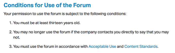

Your user name suggests you may not meet the terms and conditions to be using the forum.
edit: looks like the user advertizing they were a sixth grader has deleted their account now.

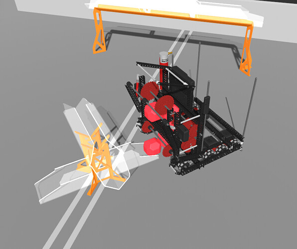

What are the pneumatics for?
How is the front bar (for getting matchloads) moved up and down?
There’s a piston on the other side of the robot. You can’t extend pistons in protobot, so that’s why it goes down but the piston doesn’t.

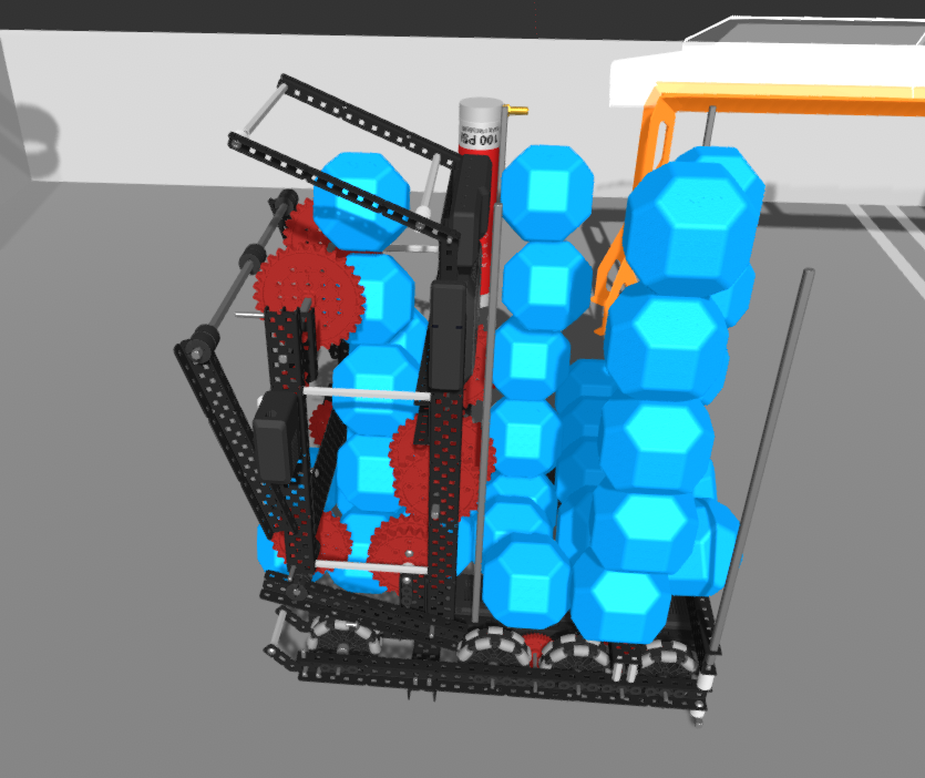

How in the world does this hold 70 blocks? Can you provide a picture?

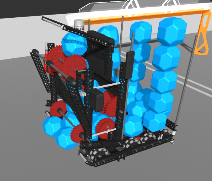

Since the holding area is not a cube, I put them in three rows. From front to back, they are 5x4, 5x5, and 4x4. The snail part can hold 12.
Since taking these pictures, I have expanded the holding area, so it could very well hold more.

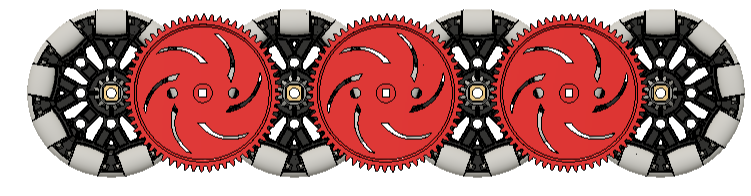

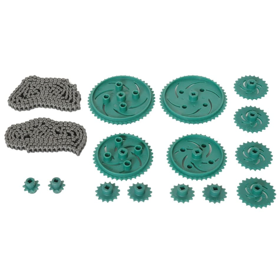

There are no 40t gears. Or 48t sprockets.
Actually there is some 40t and 48t sprockets. Here are some pictures:
They are the 3p size.
3p sprockets are awful, and you should never use them. The chain loves to break and slip under any torque, so you should use them even less on a drivetrain.

@Singularity_Robotics I’ve done testing with these and they are very underrated. Through my experience they actually can hold together under high stress. They do tend to slip and break when the chain is not in tension, but if you keep them in tension they work really well.
You may have a point. However, I believe sprockets should never be used on a drivetrain due to slop and chain being generally unreliable. If you are looking for 500RPM, I would recommend either 450RPM instead, as it is very close or a 5:1 ratio, as seen in this picture.
The spacing would be pretty tight, and I wouldn’t do it myself, but at least it’s better than sprockets.
Based off the gearing you would have to use a 100rpm motor cartridge to run at 500rpm which would be quite unconventional and introduce extra drag from the motor compared to a 600rpm carriage. 450rpm is definitely more obtainable with 600rpm cartridge as you can gear down the motor with a 36t gear driving a 48t gear on the wheel.
I’m aware, which is why I referenced 450 earlier in the discussion. However, @Neon was trying to design a 500rpm drive, so I provided an alternate design not using 3p sprockets. My view is that 450 is universally better than 500rpm, but if @Neon wants to use it, who am I to deny them?
