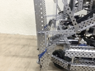

How did you get your forklift to flip down?
Well, we will petition for you if that happens!!
The flip-down tray is connected to the arm by hinges, while rubber bands are used to make the tray fall down. At the start of every match, the tray is carefully folded up, such that a tiny jerk of the robot will cause it to flip down.

Thanks. I just have a follow-up question. How does the hinge lock when falling down, because it doesn’t seem as though your forklift is wobbling when lifting things.
@8059_Blank how much does it weigh?
We have 2 bars that are pivoted together at each side (4 in total) that acts as a one-way gate, with 1 end connected to the tray and the other end connected to the arm. As the 2 bars are connected to each other using a loose rubber nut, they are able to be folded up. Once the tray falls down, the 2 bars will extend and lock in place, preventing the tray from folding back in.
Unfortunately we did not measure its weight, but it should be light enough to hang.
