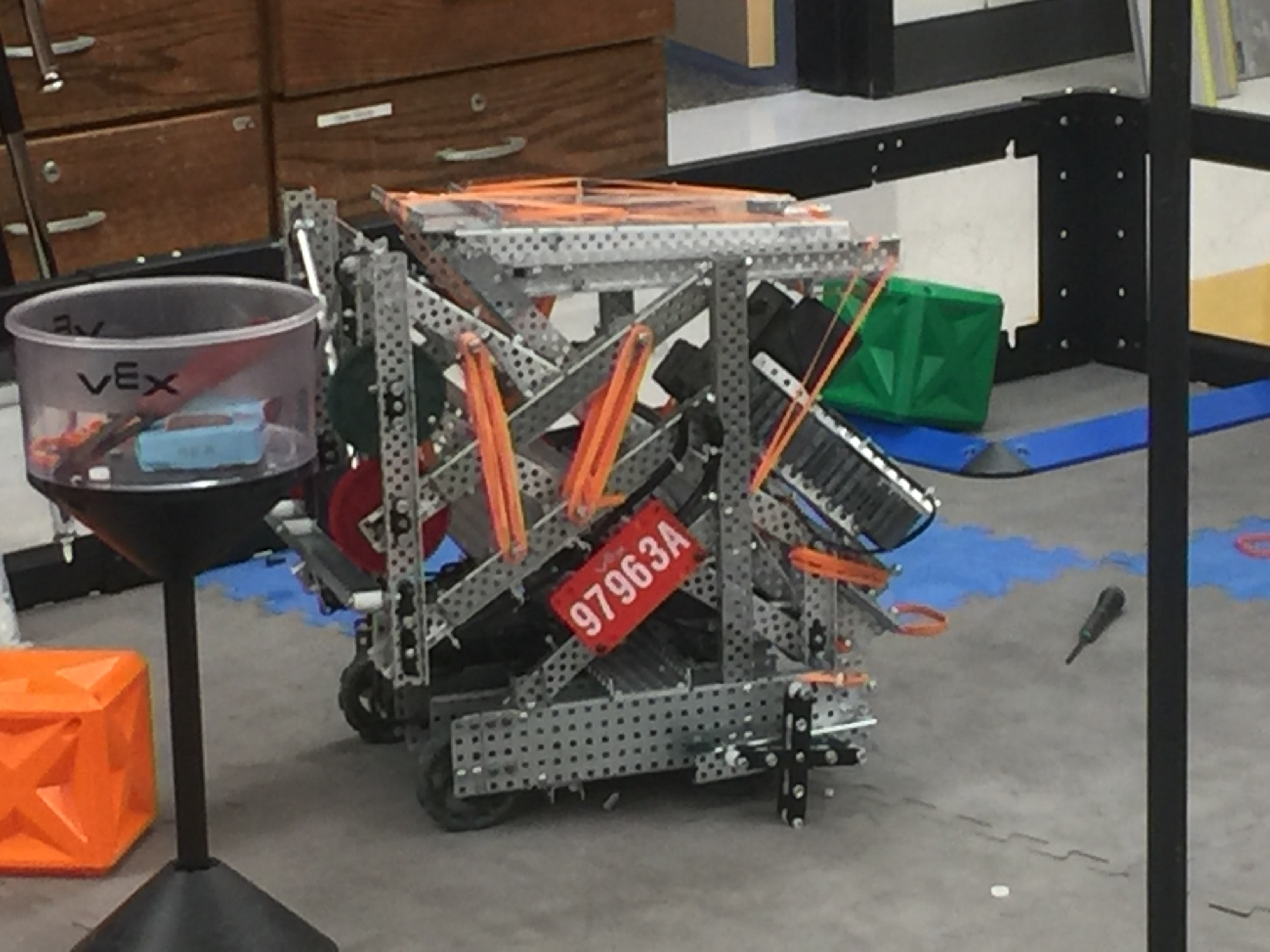

These wheels look pretty interesting to me, are they made out of ABS? It somewhat reminds me of the old VEX Leg-wheels that were advertised for “outdoor use” back when they were brought into the store.
Yes those are abs wheel legs. We need anti tip mech (our drive wheels never enter the goal zone), and we don’t want our robot to be lifted up while crossing the goal zone. Wheel legs can achieve that easily.

So how much of the robot is aluminum, and how much is steel?
Also, what advantages did you see with using the 5-hole-wides on the base as opposed to regular c-channels?

This really does depend. The main reason why my robot worked so well with one motor with 200 RPM and 1:7 gear ratio is because the lift, although looked bulky, was incredibly light (Seen in the reveal, they are using C-Channel Box bracing rather than X-Bracing, because it’s lighter and smaller) and the banding was tuned explicitly to be near linear with only two points. So, if you want your lift to be fast and only use one motor you need the following:
  • Light field elements and in low numbers
  • Lift that uses KEPS screw joints, in all places possible (Even through the gears)
  • Lift has no more than 2 axles for its support, so you can track the position of the lift with a potentiometer
  • Rarely use X-Bracing, as it is heavier and there are alternative, lighter methods that provide the same support (Such as C-Channel Box bracing, as seen in the video)
  • Drill out the holes out of C-Channels that any axle or screw will go through, if the hole has a bearing flat screwed onto it
  • Use regular bearing flats, with the joints and axles located in the middle of the 3 holes, as much as possible between two anchored points.
  • You don’t need triangle bracing for your lift to be linear. In fact, triangle bracing, for the most part, makes the lift have more friction which will not be good if you are planning on doing one motor. You should be doing two point bracing in a manner that makes the lift linear.
If you lift up 10 of the cubes, you will be lifting up roughly the weight of TWO mobile goals, or 1 Mobile goal and 10-12 cones if you know the struggles from In The Zone. My cap bot only lifted 0.6 Ibs of weight. So if you’re planning on doing one motor you should be either doing 100 RPM 1:7 with one motor or 200 RPM 1:7 with two motors, and even that will likely be more or less a struggle for most teams. If you wish to copy my method of gearing if you’re attempting one motor, it will not work, as the HS gears are plastic the HS inlet will strip from all of the stress/momentum shifts.
