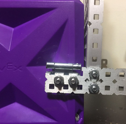

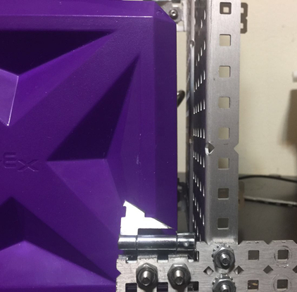

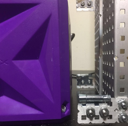

How did you add passive locks on the tray that lock the cubes in place vertically but allow them to slide out horizontally?
the passive lock itself allows the cube to be release passively. the concept is illustrated in the pictures below:
Are those hinges the only thing supporting the cubes’ weight when the tray is vertical?
Yes they are. They are actually very strong and can hold at least 7 cubes
And there’s only one on each side of the bottom cube? That’s pretty good!
we can stack 8 on 8 or even more
