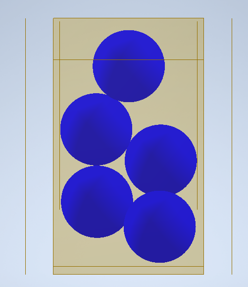

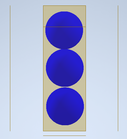

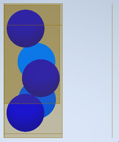

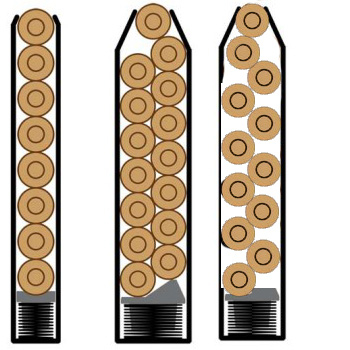

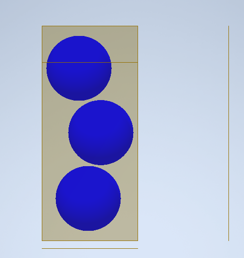

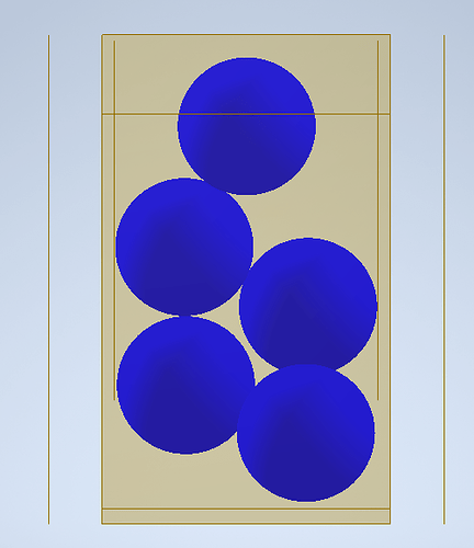

One of the ways that I have thought of increasing the ball capacity was to make a “Double Stack” Mechanism like are commonly used in Firearm Magazines.
It wouldn’t make the distance from the Intakes to the Top longer, but would increase the amount of balls that you could fit in that space. I haven’t put a ton of thought into it how exactly it would work, although I might dabble in it a bit more to see of it’s a viable option after I iron out any bugs with the 'Single Stack" Snail-Bot.
Here are some mock ups from when I was coming up with the concept
(The tan lines / squares are the 18" sizing border)
Single Stack
v Front v
v Side v
Double Stack
v Front v
v Side v

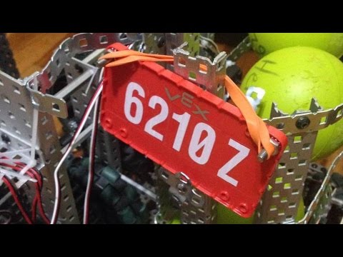

Take a look at this robot back from NbN season, which stored the balls in the magazine:
6210z Post State Robot Reveal (although it was later replaced with different design for Worlds)
I think, there might be a relatively easy way to store two balls in the back of the robot (and third pushed out when overflows) with the ability to retrieve them back into the main loop when necessary. You could ratchet the top roller motor to select whether the bottom roller takes the next ball from the intake or backpack storage. The tricky part might be the latch mechanism that allows top roller motor to momentarily activate it and the switch back to forward direction.
