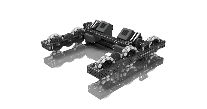

Drive
One of the biggest problems our first robot this year had was the drive speed. It was only 200rpm on 3.25" wheels, which is very slow and was one of the factors that caused our robot to lose the competitive edge we had early in the season. We wanted this robot to be much faster, be more compact, and have better traction. The way we acheived these things is somewhat unusual though.
First thing you might notice (and have probably seen already) are the angled motor mounts.
These are made from bent and drilled HS shafts, which we chose to use over something like polycarbonate for strength and rigidity. Machining these was very painful, but it was definitely worth it to be able to fit all the drive motors so compactly.
We also wanted to have much more traction, because 3.25" omni wheels aren’t quite as grippy as 4" or 2.75" wheels, but we were pretty set on using 3.25". And because 3.25" traction wheels aren’t all that great (the non-constant diameter isn’t very good) we decided to make custom traction wheels by cutting up flex wheels and wrapping them around a complicated assembly made by lathing a slot into 60t gears, running a ring of chain through that slot, bolting the chain to the gears, and then zip-tying the custom tires to that chain.
again, not necessary, and fairly difficult, but worth the effort. I’m very happy with how these custom traction wheels work, the grip they have on the platform is phenomenal, and the pushing resistance is a very nice bonus.

Is it possible for you leek the diameter of the gear after the slot? I would definitely want to try this out as well.
didn’t measure, but basically I took it down to where you couldn’t tell there used to be gear teeth there and no more than that.
there’s also a layer of antislip between the chain and the slot.

Nice robot! can you mention more about the custom traction wheels. Maybe some picture or video and some description. Thank you, It is so cool!!
