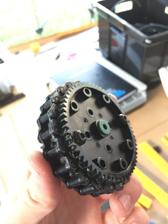

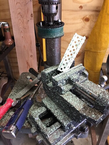

I took two HS 60t gears and bolted them together. Then I affixed this assembly to a drill press, and used it like a lathe to cut a slot in the gears like so:
then I ran a ring of chain through this slot:
and then I cut up a 3" flex wheel so I had just the edge part, to get a custom tire
Then I ran zipties under the chain and around the tire to hold it in place.
The reason I did all this is because wrapping the tire directly around a 60t gear doesn’t give it enough diameter to contact the ground. So I used the chain to slightly increase the diameter, as well as giving me a spot to secure the tire on.
I would only recommend doing this if you’re using 3.25" wheels, there are much easier alternatives for 4" traction wheels that perform adequately. It was also a pretty big pain to do and took a few hours as well as a drill press.
How much traction do the flex wheels give you? Do they add significant traction when climbing the ramp and help when pushing against opponents?
yes, they are extremely grippy on the platform in particular, which is why I made them. 3.25" omni wheels don’t have amazing traction on their own, but with the traction wheel added climbing is very easy.
