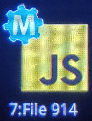

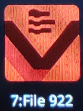

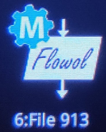

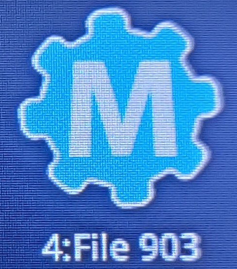

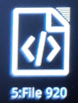

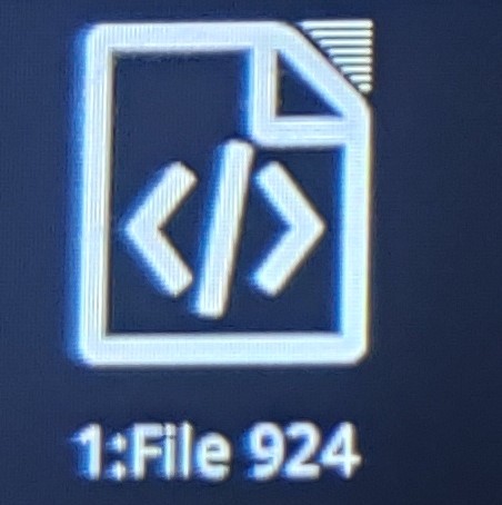

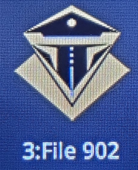

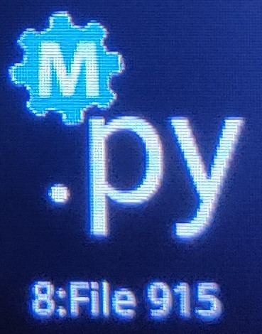

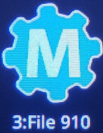

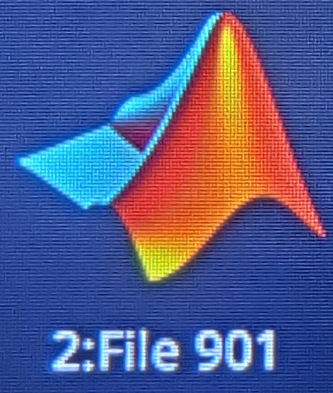

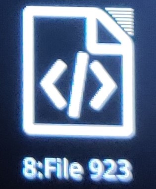

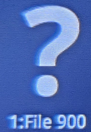

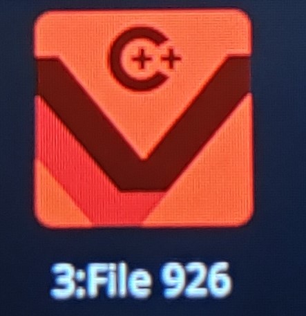

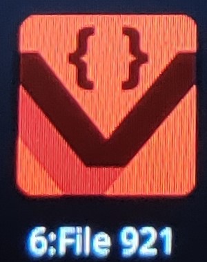

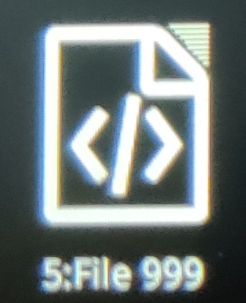

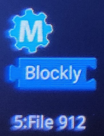

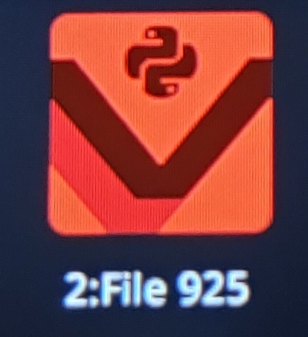

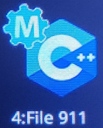

From what I found by brute-forcing all (reasonable) filenames, there are 18 total icons that are usable by programs. All of them are in the format USER9##x.bmp, with ## representing the icon. And before you ask – no, you can’t upload custom images to use. Not by uploading it to the flash and not by using an SD card and pointing to it. However, there still are some interesting icons to use. Here’s a quick breakdown of them:
USER901x.bmp: MATLAB logo
USER902x.bmp: PROS logo
USER903x.bmp: Robot Mesh Studio logo
USER910x.bmp: Robot Mesh Studio logo (again)
USER911x.bmp: Robot Mesh Studio C++ logo
USER912x.bmp: Robot Mesh Studio Blockly logo
USER913x.bmp: Robot Mesh Studio Flowol logo
USER914x.bmp: Robot Mesh Studio JavaScript logo
USER915x.bmp: Robot Mesh Studio Python logo
USER920x.bmp: Default file logo
USER921x.bmp: VexCode logo
USER922x.bmp: VexCode Blocks logo
USER923x.bmp: Default file logo
USER924x.bmp: Default file logo
USER925x.bmp: VexCode Python logo
USER926x.bmp: VexCode C++ logo
USER999x.bmp: Default file logo (A file with </> in it)
Any other filename: A question mark
View Images
So it looks like the 0s are for other types of programming, the 10s are for Robot Mesh Studio, and the 20s are for VexCode. No valid icons for anything beginning with VEX either.

Yeah, I made a script that went through the 900s and that’s how I got those. I tried the others, but I just realized that I did it wrong and forgot the “x” so I’m rerunning it for 0-1000 right now. There’s some super interesting ones now that I’m seeing them. I’ll post tomorrow. Also thanks for the idea for the screenshots, I’m using that method too. Before I was just making a pause so I could take pictures and then press enter. I’ll also be making a pull request soon. PROS-cli is pretty much the only way to interact with the V5 through command line, so there’s a lot of cool features that can still be added.

Okay here are all the files for real this time (and in better detail):
USER000x.bmp: VEX logo
USER001x.bmp: A cool looking X
USER003x.bmp: A slice of pizza
USER010x.bmp: Clawbot
USER011x.bmp: Robot head
USER012x.bmp: Power icon
USER013x.bmp: Planet with two moons and a ring
USER027x.bmp: Alien
USER029x.bmp: UFO with alien in it

That’s about all I could find, I even tried going through it all with the VEX prefix, too. And as for uploading your own, right now the answer is no. As I said before, I tried a normal upload of a bitmap to the flash and it didn’t work and with an SD card and it didn’t work. But libraries aren’t stored there, so there might be a way to upload stuff to wherever those are stored, but there’s currently no way to do that.
