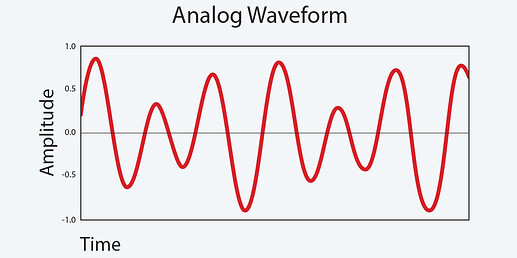

Normal audio from a speaker is described as an analog waveform. It has varied peaks and that describes the frequency and amplitude of a sound. In essence, this is how music is recorded. A vinyl record stores this physically with small vibrations in the groove which are translated into the needle and then amplified into speakers.
As Jpearman established above, the V5 brain is incapable of creating this waveform because of the lack of an analog output. To my understanding, all of the brain’s output is digital. Therefore, the brain couldn’t create the waveform above.
Instead, possibly the brain could create a square wave form:
As you can see, this wave only has digital components. In theory, the brain could output this waveform because it does not require analog output. You could use the 3 wire ports as digital output and connect that directly to a speaker. I have done this with an arduino’s digital output by using the tone() function and connecting the digital out pin to a Piazo speaker.
This is easier said than done, however. For example, to play the note A4, one would need to enable and disable the pin 440 times per second for a frequency of 440Hz. By default, in the drive loop, there is a 20-millisecond delay. To play a constant A as described above, it would be identical to having a loop that enables and disables the output every 2.27 milliseconds. This seems possible although it would very possibly take too much of the brain’s resources to play this sound in order to put this on a competition robot. It’s probably still possible, however.
