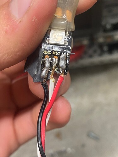

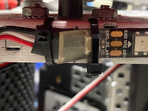

Sorry to restart and old post but to actually wire the LEDs you are just soldering the 3 wires from the LEDs to the 3 wires on the VEX DuPont style connector right, or do i need to find a certain strip with them already on there, also if you do have to solder them to the 3 wire DuPont do I need to do it in a certain way/certain wire to wire. I haven’t soldered them on or even bought any strips yet, I know what I want out of my LEDs (I’m a tiny bit of an LED Nerd for my FRC Team) but I am not sure how to legally and correctly connect them to the brain. I think they’ d look amazing (I was a big fan of the Radioactive bots with the LEDs)
You just solder them, but you have to flip some of the wires. What we did last year was take the female connector off of a 3-wire extender cable, strip some of the wires, and solder it, then put heat shrink around it. This worked, but was a bit unreliable (sometimes you had to press the cable a certain way or wiggle the wires to make it light up all the LEDs correctly) but that was probably because of bad soldering. Here are some photos:

Note that you have to twist the cables when you solder them, as the order is different on the pads then in the VEX 3-wire cables.
alright, thank you for the help, ill get them ordered asap
