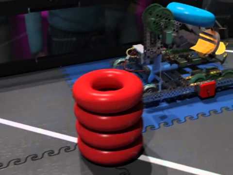

wait whats a round up drive?

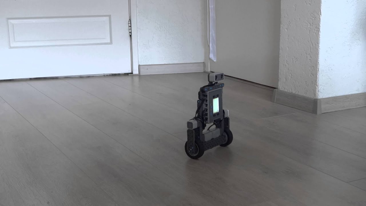

Idk about unicycle, but two wheel has been done:
Im surprised and not surprised at the same time
I hate to be that guy, but you cant do that in normal vex. There is no way that clawbot is in dimensions.
We also don’t have antigravity motors, either, so…

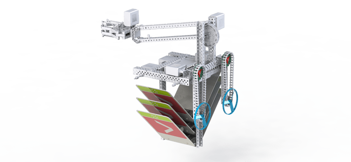

Don’t forget the hydrofoil drive base from last year’s secret invitational water game:
