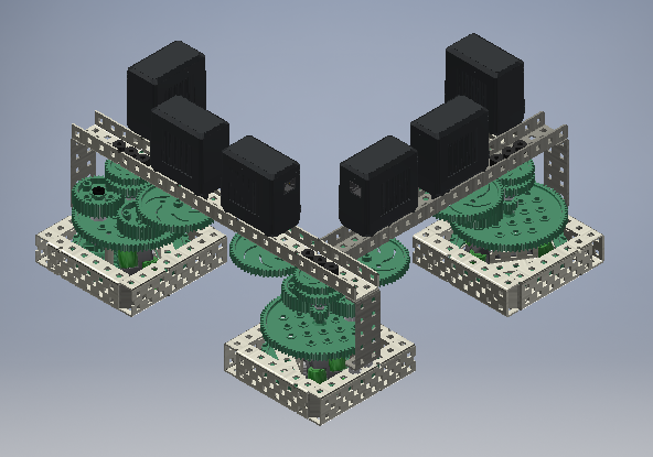

After this was posted, I was asked by Kyle | 81818X to mention that swerve drives have the ability to provide the robot’s full torque force in any applicable direction (given that the wheels have 360 degrees of motion)
(Above: Differential Swerve Drive by Kyle from team 81818X)
Obviously the linked CAD model of Kyle’s differential swerve now seems tempting to you. You’re probably thinking you have the gears and the metal and you probably do. It doesn’t look terribly hard to build. But such a drive is A) alot harder to build than it looks and B) is likely to have serious friction problems without any sort of lubrication and C) if both sides are not build perfectly it simply isn’t going to drive straight without a mechanical or programmed jerry-rigged solution. Not exactly ideal.

As you all saw in the other swerve post that was made today (which unfortunately got taken down), Kyle from 8181x created a swerve drive that used a differential to allow one motor to both power the wheel’s rotation about the axis and rotate the wheel itself.
Personally, I’m rather surprised that swerve drives have not been used more frequently in vexu. While I am not a part of vexu yet, it seems that with the capability of custom machining parts, one could create a swerve drive with much less work that someone in vrc for instance. Vexu teams have the ability to print ring bevel gears, which look like this:
I suspect that as more vexu teams (and the new vex ai teams) learn of how to use computer aided custom manufacturing and 3D modeling, we will see these types of drives very soon.
Another note on the possibility of swerve drives is the fact that it may be viable to do a 2 pod swerve drive, which would work very similarly to a shopping cart like I mentioned earlier. 2 of the wheels would be powered (or unpowered) in the back, and 2 wheels in the front would be able to work like a swerve drive with 2 motors powering each wheel.
I believe that with good building techniques, a low friction system can be made that will allow for this form of drive to be relevant one day in vrc. It will undoubtedly be harder than in vexu, but I think it can be done.

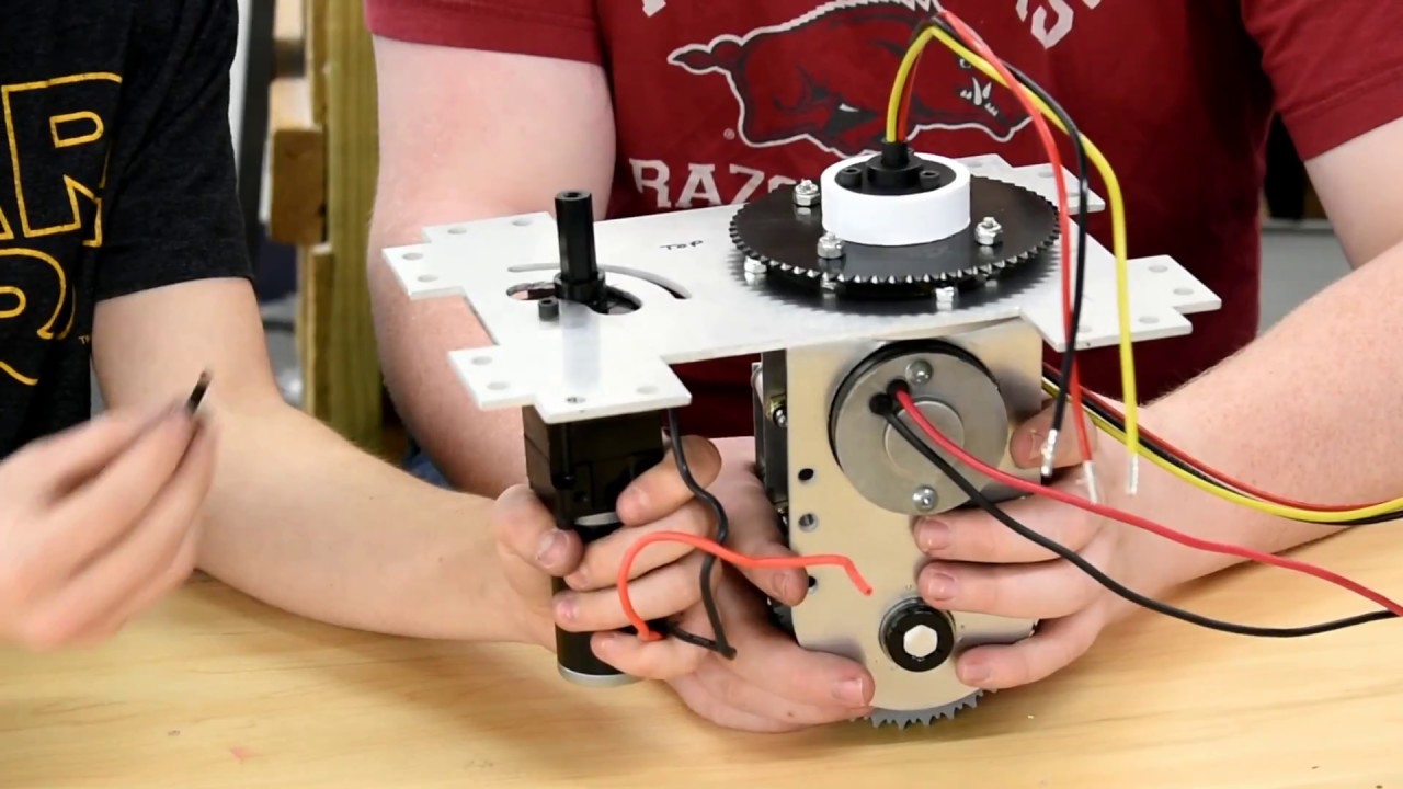

Jumping in here. My former FRC team 1640, did a ton of prototype work on swerve drive using VEX parts.
We also built the famous “Twitch Drive” that moved the wheels 90 degrees in about 2 seconds.
People hate swerve, but Team 1640 has done years of research on it for FRC and has some pretty sweet modules they make.

A feature I feel not given justice provided by swerve drives with omni wheels is the ability to change mechanical advantage by the degree in which wheels are angled towards each other. Ethan touched on that you can reach theoretically infinite speeds, but I’d like to talk a bit more on how this is beneficial.
Note: in the OP it was said “And while there are arguments for variable speed and torque, those things can be somewhat achieved using A) programming or B) gearing”. This isn’t necessarily true, as in programming you can’t change mechanical advantage (just pump in excess voltage at lower speeds, which is what you should be do regardless of drive type, however stall torque is the same), and there isn’t any other 4 motor holonomic drive that can change mechanical advantage with gearing, only tank (which I think can be low friction enough to be viable).
Being able to have variable mechanical advantage provides two main benefits: Being able to have a “pushing mode” (where your wheels are on tank style) and a “speed mode” (where your wheels are angled against each other), and having a quicker acceleration time. Both of these benefits cause a change in your drive speed: having a pushing mode means you don’t need as much torque on speed mode → faster top speed, being able to reach top speed quicker than necessary → faster top speed. This also helps counteract some of the side effects of the overwhelming friction, which would reduce your pushing power and acceleration time.
Here’s an illustration of the the torque levels of a swerve drive (green) compared to a normal drive (red). The x axis is the drive speed in rpm of a 4.125" wheel equivalent. The y axis is the torque exerted times the mechanical advantage. This is assuming a 4 motor drive with a 180 rpm speed equivalent in tank mode and a 45 degree angle in speed mode (since 45 degrees has the least roller friction, although you could go faster, as Ethan mentioned). As you can see, there is more torque in the swerve drive for most speeds, which contributes to acceleration. Between 180 rpm & ~250 rpm you can see the gap in torque decreases as angle would change gradually (with the acceleration of the bot) to the final speed setting.
I’d certainly agree that my design as of now has to much friction to be viable, but I think with changes and friction reducing methods (you can certainly reduce the quantity of top gears and take out the encoder, 3 pods/6m has potential too- variable MA is messed up with it though), the vex community has the potential to develop swerve drive as the strongest and most versatile vex drive. Plus swerve drive bots look cool, and that’s the determining factor for a good bot :).

This is not true. With a differential, you can utilize the full power of all the motors and still have 4 left over for other mechanisms
I explained it afterward cause ik that I explained it badly. They only use half the motor power of the motors allocated to the system. 1 swerve module uses 2 motors but only has one motor of pushing power
That’s still not true for a diffy swerve drive. You retain full power of all the motors when turning the wheels themselves about their axis and rotating the shaft when using a 4 wheel 4 motor differential swerve drive
