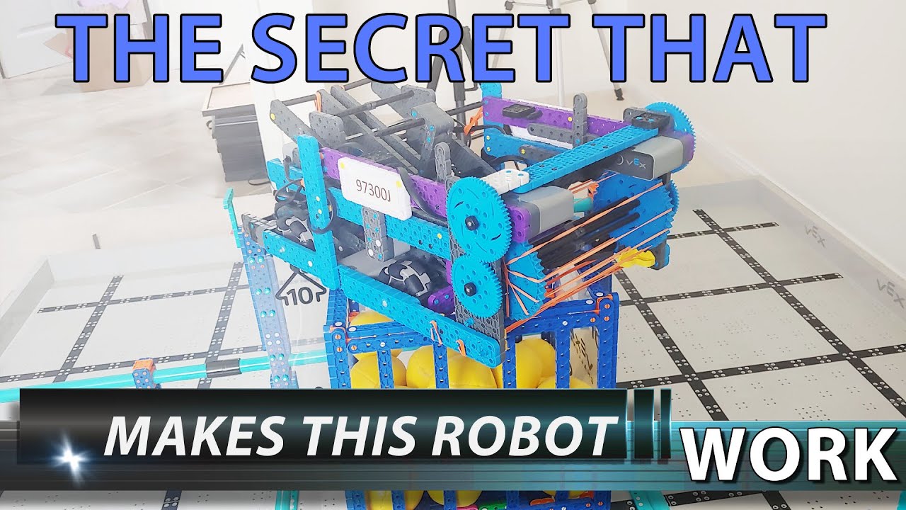

Not sure if that was just a typo, but I wouldn’t recommend the distance sensor to stop your catapult. Use the color sensor. And whatever you DON’T use the bumper. We tried that at first with great failure. I’m not sure how helpful this video is, but it talks about this shirt of thing. I would also suggest having the color sensor sense white and sticking a blank license plate on the side. I’m not certain, but I think all the holes in a normal beam could through it off.

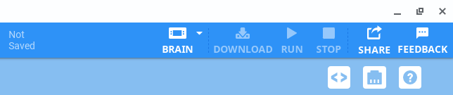

In our driver program, we have a when started block and then a forever loop with a bunch of ifs inside it to check all our buttons. I’ll put in the code we have for our color sensor. (It’s called catapultResetter.) You can find these commands as blocks in the menu. If you don’t know what a block does, you can click the question mark in the top right and click the block.

Here’s the same code in blocks:
Your best sensor is the motor encoders. If your chochoo is a 2:1 ratio, just have a button spin the motor(s) 2*360. That will shoot and reset the motors to the exact same position. Have one more button for adjusting it to the right position.
