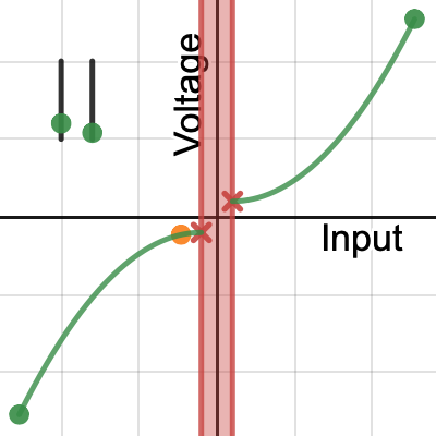

If you are using a joystick deadzone to prevent drifting, I would use a piecewise function when defining an exponential drive. Otherwise your deadzone will need to be massive.
I modeled the controller input and voltage output as a piecewise function based on n (power) and d(deadzone size).
If you just define your deadzone normally, you don’t have to worry about making the function piecewise as it already effectively is:
