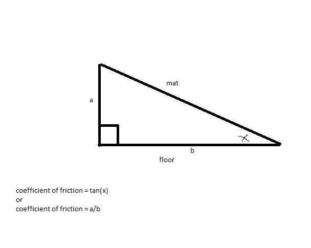

So is this how to find coefficient of friction for the wheels? (see attachment)
Yes! That’s exactly how you can find it. (x being the angle when the wheels start to slip, of course.)
~Jordan

The arctangent of the slope is the angle (the tangent of the angle is the slope). And it also happens to be that the slope (or the tangent of the angle) is the coefficient of friction.
This would be the alternate way to test (having a whole robot), but I would be concerned with the wheels depressing into the foam which may alter the results (may in insignificant, might not be). Also, your 4" wheel numbers got switched somewhere. I think the second set of values (the slopes/coefficients of friction) are correct, as the rubber on omnis is different from the rubber on the regular tires. I’d recommend just testing the wheels by themselves in the cases where the rubber sticks outside of the plane of the edge of the plastic (omnis and I think the 5" wheels). For the rest, a simple squarebot-type thing should work fine, assuming you’re not putting 50lbs of bricks on it…
Unless you have an instrument to measure angle accurately, I would just stick with the slope as the only value you deal with.
