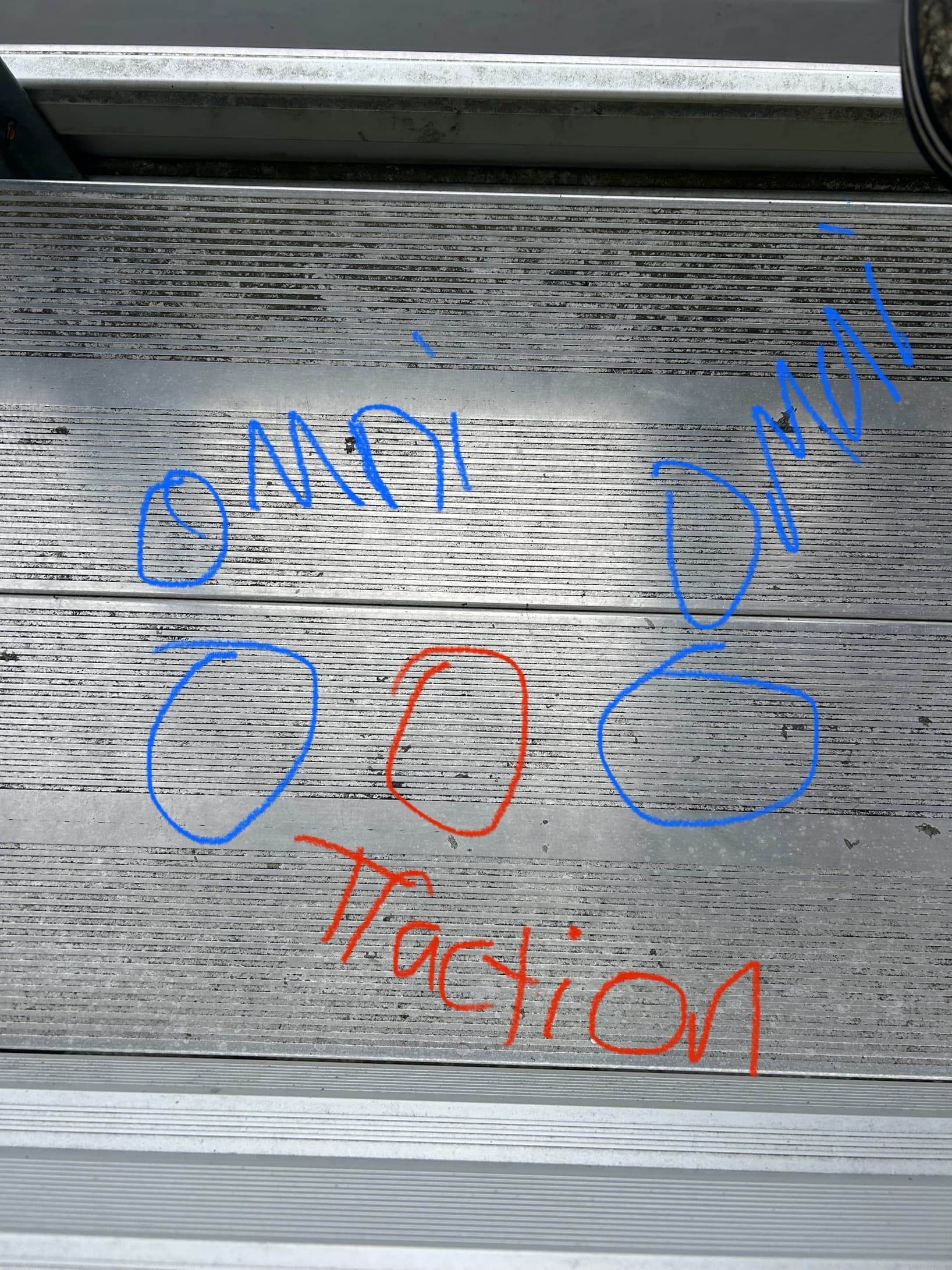

Would this work…
Put a traction wheel in the middle of your drive train with the h drive
But then why would you want a h-drive if you didn’t want to move sideways? A unpowered omni wheel in the middle perpendicular to the drive would also not also you to strafe either. Friendly reminder that an all omni drive can drift on its own and also an all traction drive won’t drift any more necessarily with the free wheel in the middle perpendicular to the drive.
where are you. there is no need to specifically annotate on that image. :rofl: and no you cannot put the traction wheel there

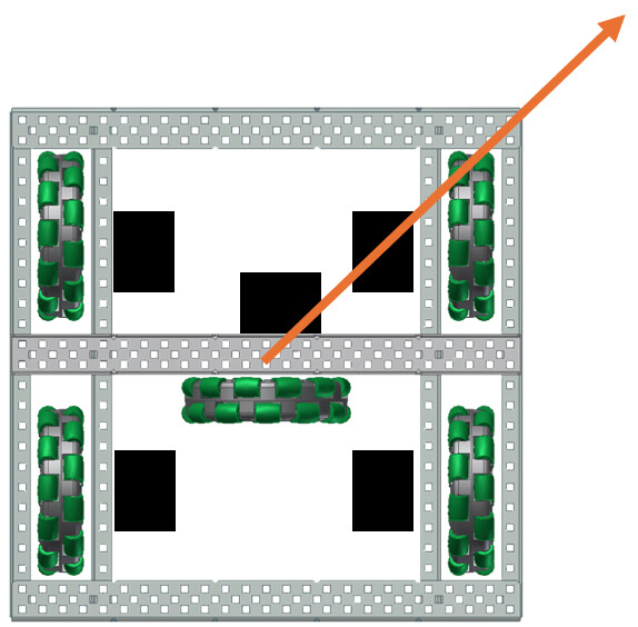

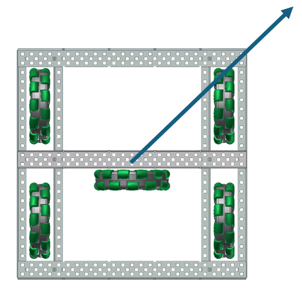

For the sake of the argument, I will be turning off friction like your everyday physics teacher.

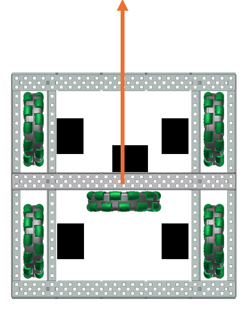

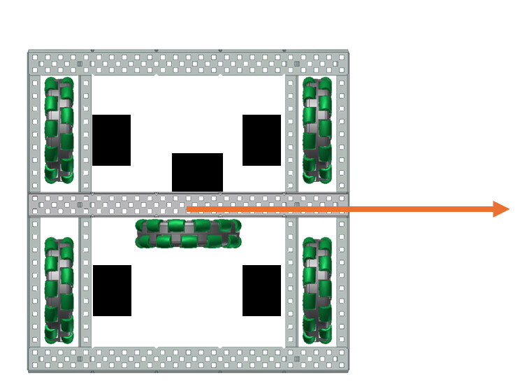

If you have a forward speed and a sideways speed, the diagonal speed for an H-Drive is sqrt((forward_speed)^2 + (sideways_speed)^2)
If we assume that the robot is going forward 3 m/s, and also strafing 3 m/s, the resulting would be sqrt(3^2 + 3^2) = sqrt(18) = 4.24 m/s that direction. This is an increase in speed that designated direction compared to the laterals.
For the sake of testing, I will assume that adding a motor for a wheel will contribute 5N of force the designated direction for the chassis. I am assuming this applies for all motors for the sake of testing that they contribute 5N for a speed of 3 m/s. It is important to note that I am not taking friction into consideration, for now.
From this, the forward direction would contribute 5x4=20N of force, with the sideways direction contributing 5N of force.
The force that direction would be sqrt((forward_force)^2 + (sideways_force)^2)
Therefore, the force that direction is sqrt(20^2 + 5^2) = sqrt(400 + 25) = sqrt(425) = 20.61 N of force diagonally.

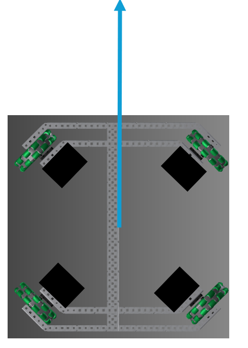

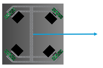

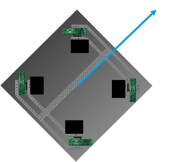

Now, let’s compare that to a 4 motor X-Drive. For testing, I will rotate the design 45 degrees to match up to the H-Drive:
If you have a forward speed and a sideways speed, the diagonal speed for an X-Drive is sqrt((forward_speed)^2 + (sideways_speed)^2)
If we assume that the robot is going forward 3 m/s, and also strafing 3 m/s, the resulting would be sqrt(3^2 + 3^2) = sqrt(18) = 4.24 m/s that direction This is an increase in speed that designated direction compared to the laterals.
Now, let’s compare force. For this, we have two motors and two motors, which means 5x2=10N forward and 5x2=10N sideways:
Therefore, the force that direction is sqrt(10^2 + 10^2) = sqrt(200) = 14.14 N of force diagonally.

Think about the major factor of the X-Drive. The primary direction it moves. Let’s un-rotate the X-Drive to what we should percieve it as:
If we have the X-Drive going forward, it will be going a speed of 4.24 m/s with a force of 14.14 N.
It has a force-to-speed ratio of 14.14/4.24 = 3.33
If we have the X-Drive going right, it will be going a speed of 4.24 m/s with a force of 14.14 N.
If we have an H-Drive going straight, it will be going 3 m/s with a force of 20N
It has a force-to-speed ratio of 20/3 = 6.66
If we have an H-Drive strafing, it will be going 3 m/s with a force of 5N
It has a force-to-speed ratio of 5/3 = 1.66
