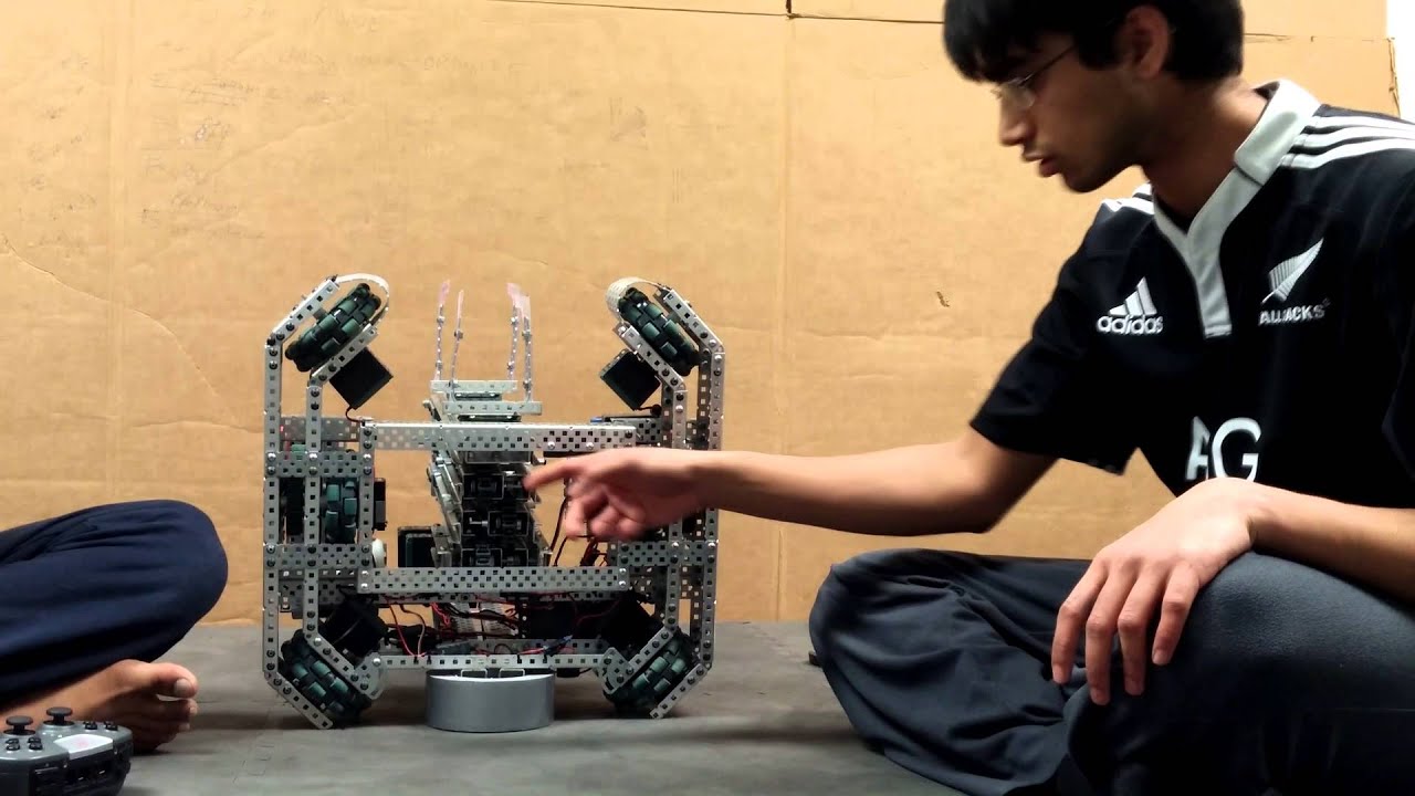

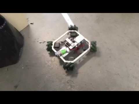

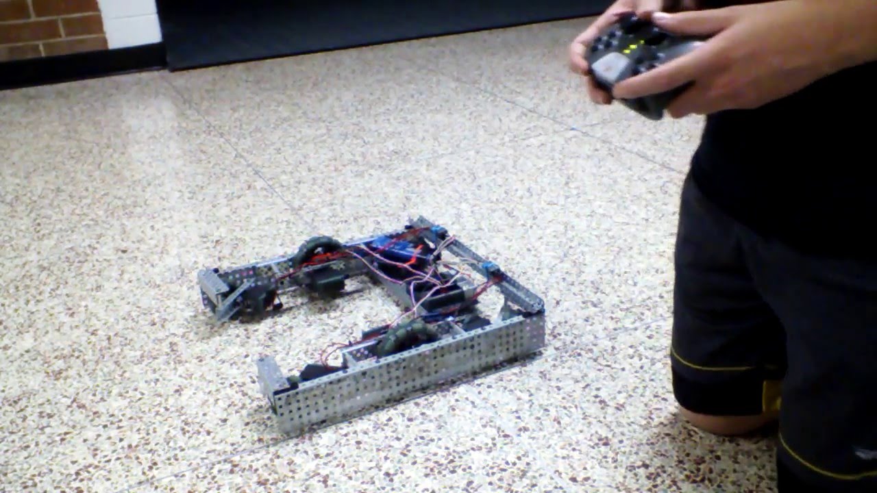

Aren’t mecanum wheels bad? I asked in several discord servers and read up on forum posts, and the majority consensus agreed that mecanum drive is inferior to X drive. Do you see their performance as being relatively equal?
they do seem to be generally disliked, but I will drop this here:
clearly, they can be good in the right hands.
the main complaints I’ve heard of mecanums are their bulky size, and their reliance on having a very good center of mass for the strafing to be reliable and straight. But I don’t think center of mass is going to be much of a problem with this game, and back in TT when center of mass was worse than it ever was, 7k was able to make them work.
I have no personal experience with either though, as I knew I wasn’t going to be able to make good enough use of a holonomic drive for it to be worth it.

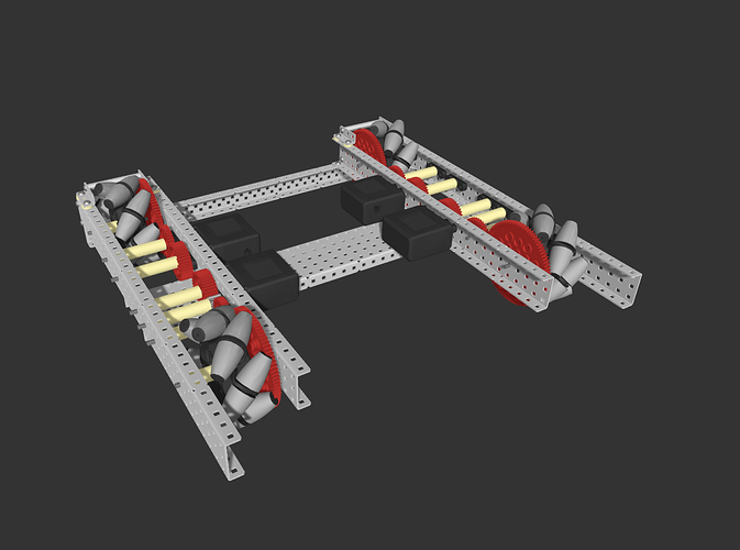

Yes, mecanums are naturally slower than X drives because of the x drive’s strafing nature (mounted at 45°, sqrt 2 speed)
However this can be mitigated by gearing up mecanum wheels.
This is an example of a 257 rpm mecanum drive, courtesy of Alex from 20203Z
Can you tell me which gears (how many teeth per gear) are used in here, and in which order from motor to wheel and what cartridges would need to be in the motors for this to go at 257 rpm.
3:7 600 rpm (36:84)
