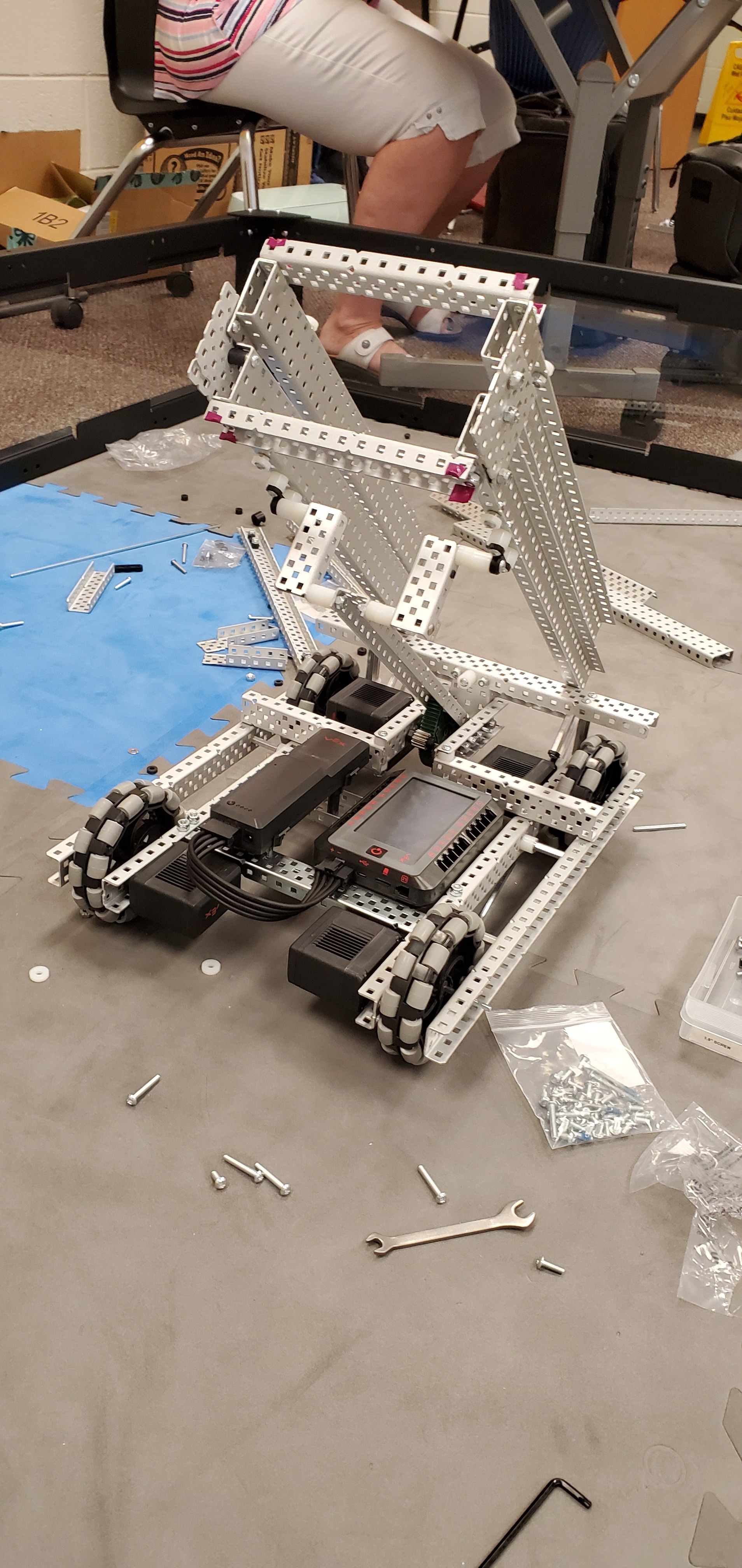

Arm for intake
To allow the intake the put the cubes in the goal zone
Ok the tilter in the video is the same design most robots use. It still tends to work on simple tray bots.
This forum post gives a few insightful points
Ok. Can you post a clearer pic of it
49 seconds in the video it shows how the tilter looks and works
Ok thanks. Do you have to have the same gear ratio for the bottom of the titler in order for it to work?
No, you probably should use a different gear ratio
What would be the best gear ratio
And we don’t have that much space inside of our base
So what would be a simpler way to do that?
Thanks for the help by the way
Well i can’t give you a good anwser, but it depends on the amount of cubes you want to intake and the size of your tray and whether you are using steel or aluminum.
So you want to use the minimum while still being able to have enough power to tilt and you might want to consider low strength gears since they don’t take up much space

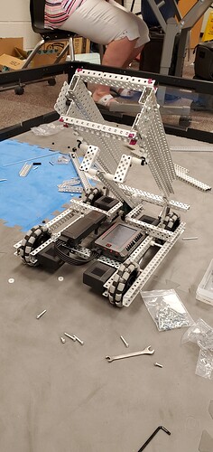

This is a picture of my team’s frame, we cut a big gear in half so that we could screw the gear inside the c channel
The gear ratio visible is good enough to turn the tray with cubes
Ok. Thank you so much people.
Last thing, I would recommend sandwiching either the gear with 2 c channels or, a c channel with 2 gears. This will be very stable and should reduce any wobbling or bending.
Ok that would work but our base is really packed. All we have room for is one gear and a c channel and of course one motor
