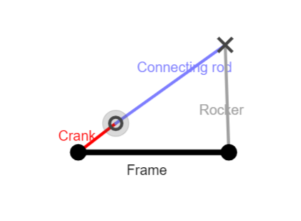

Each year, there is usually a physics thread to work out the math behind the theoretical “best” version of a design. Many, many people have contributed to the vast amount of information that is available on this site (thanks technik3k), and I was hoping we could do something similar this year. The one robot part that has been intriguing me has been the tilter, as its geometry has varied greatly in various robot designs. What is the optimal way to build the arm such that the tray is given maximum torque when it needs it the most (when the tray is all the way down)? I have a feeling there is some sort of perfect balance between the length of the driven arm (longer means less torque) and how high up you push the tray from (higher means more torque). Any information about this will make the VEX community that much better. Thanks!
The following geometry is close to what you are looking for (drawn not to perfect scale):
tilter_physics_angles
Where for the 45 deg travel of the tilter you have somewhere close to 170 deg travel of the driven gear.
When tilter is raised, this will provide largest torque and small acceleration at the beginning, max velocity half-way, and then will gradually slowdown at the end of travel. Also, it will naturally lock the tilter in the raised position, without the need to keep the motors actively “holding”, which would be great fit for the differential power take off from the drivetrain motors.
I’ve seen a number of reveals having this geometry to some degree, with 1961Z, probably, being the best example (watch 0:52 to 1:05):

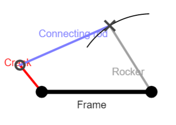

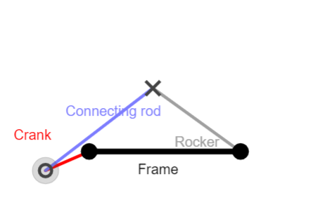

When the connecting rod almost runs into the shaft connecting the crank to the frame, then it is at its optimal torque. Then just make sure the gemoetry is such that like in the final diagram, the rocker is straight up and down when the crank and connecting rod are aligned.
EDIT: This optimizes starting torque and provides a motion profile that both limits the final tilt position (so that you cannot over tilt), and it decelerates the tilter as it reaches its final position (doesn’t fall forward). However if you wanted to really get your stack moving, make sure that your tray stores potential energy (rubber bands) as it tilts down so that it can tilt forwards as quickly as possible.
If your max tilt was achieved so that the crank was as it is in the second picture, perpendicular to the connecting rod, it would maximize speed, but with a lower mechanical advantage and a large final velocity. This would be much better for a lighter set up where you needed to minimize lifting time and fling your pile into something with reckless abandon.
Source https://www.geogebra.org/m/zZ5Bt9hX
