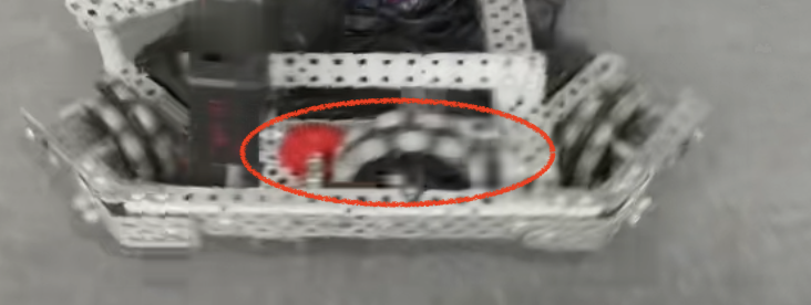

I’ve been brainstorming an 8-motor asterisk drive design. In this setup:
  • Each X-drive wheel will be powered by a single motor.
  • The center wheels use a PTO to switch two motors a wheel and asubsystem (like an intake or scoring rollers).
The PTO will be either a sliding or tilting type (I’m not sure of the exact term), and it will use a dual over-center locking mechanism to keep it securely engaged or disengaged.
  • When the PTO is engaged, all 8 motors power the asterisk drive, and no motors are allocated to the subsystems.
  • When the PTO is disengaged, the robot runs on a 4-motor X-drive, and two motors each power two separate subsystems.
This should still give me enough drive strength to move around and reach blocks or goals when I am in 4-motor mode. When the PTO is engaged, I should be able to be able to push most other robots effectively.
Does anyone think this may work? What isues do you think I may face with the PTO?

You will want the center wheels to be 1.41x the RPM of the X-drive wheels. This will match the speed of the X-drive part of the robot. I beleive if the RPM is a bit faster than this, it should be fine, but if its slower, you might have a problem. You should get clarication for this, though.

Our team is currently constructing a asterisks drive, and what we have done is used powered each wheel individually. We also used a bigger wheel for the center, and geared it down to the same RPM as the smaller wheels used for the X-drive.
