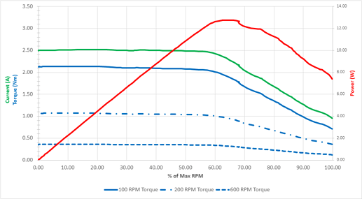

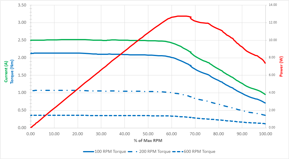

You may be asking - Hey, doesn’t VEX already publish torque-speed graphs for the V5 motors?
Yes! However, there are some issues with the official graphs that I’d like to go over. Here they are:
V5 Smart Motor (11W)
source

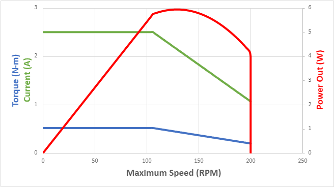

V5 Smart Motor (5.5W)
source
A few things to note:
  • The 5.5W motor graph is almost certainly synthetic or idealized. Perfectly linear relationships like those depicted in the graph do not exist in these kinds of real-world problems.
  • Both the 11W and the 5.5W graphs (especially the 5.5W) cut off early at the rated speed of each motor. There is significant headroom to the right of this artificial cutoff on the graph as the motors approach their free-spinning speed at maximum voltage.
  • Measurements for Torque in the 11W graph appear to be directly proportional to current measurements, which could indicate they are calculated from current instead of directly measured. There is a strong relationship between these two values in the real world (generally, more current = more torque); however, it seems a little too perfect here. If this is the case, then the calculated power value would also be based on some assumptions that don’t play out in the real world.
Because of these reasons, I think there is some merit in independently measuring the motor’s performance, specifically via measuring the torque output of the motor at multiple speeds.

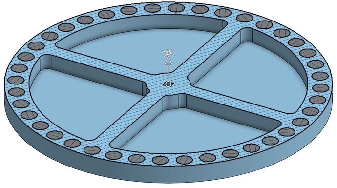

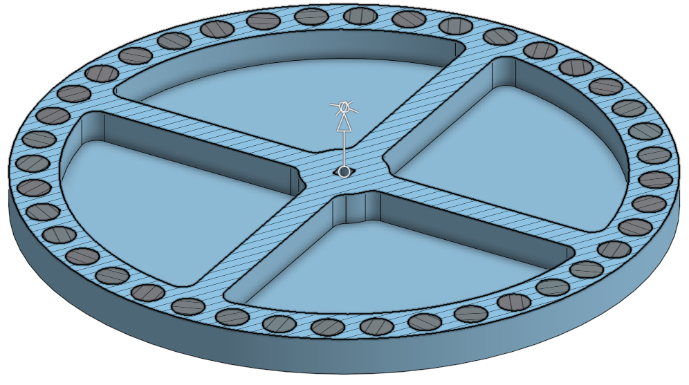

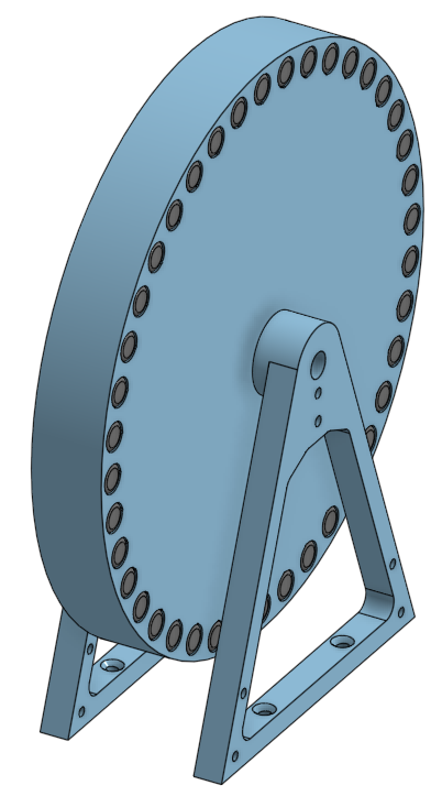

The flywheel itself is the most important aspect of the setup, as the Moment of Inertia must be precisely known in order to produce an accurate result. Due to limited machining capabilities (I do not have access to a lathe since graduating), I was not able to construct a solid metal flywheel because I lack a lathe which would enable me to produce such a perfectly balanced disc with a perfectly centered hole for an axle. Instead, I opted for a 3D printed flywheel with embedded steel weights in the perimeter which would enable a high moment of inertia while still not costing a fortune in materials. Here is the final design:
The wheel is 10.0" in diameter and is not fully solid, but has pockets to save on filament. Still, each face is flat so as to eliminate air resistance caused by exposed spokes. Each steel weight was press fit into place to prevent movement or the wheel becoming unbalanced.
Because this was designed in CAD (and masses of all objects were verified), I was able to use Onshape’s measurement tools to get the wheel’s mass and moment of inertia, which are 2.003 kg and 0.0241857894 kg⋅m2

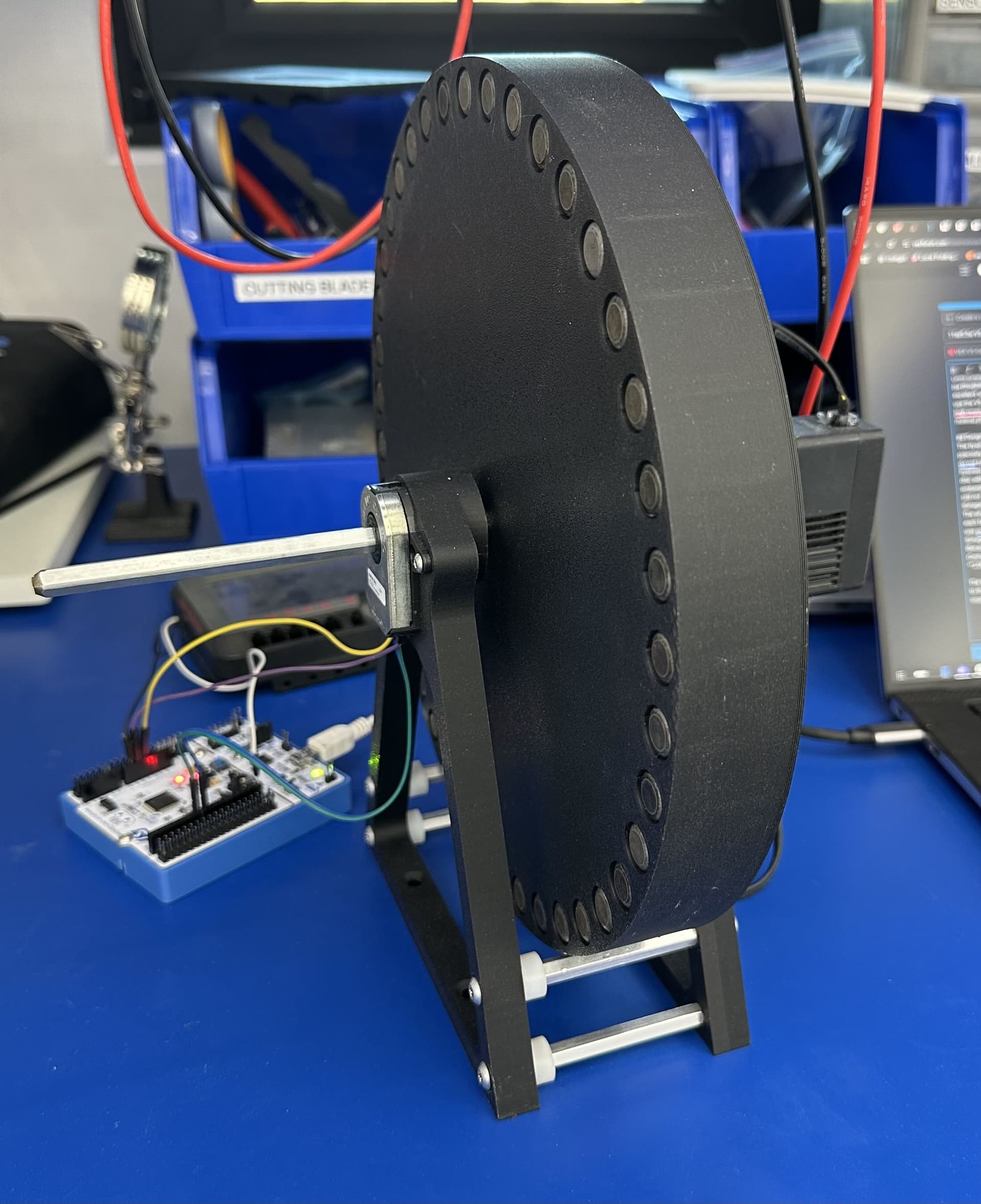

The legs each have a pocket for a VEX high strength ball bearing to be press fit into, and attach to the other using multiple standoffs which ensures the bearings are precisely lined up. Friction must be kept to a minimum to get the best measurements.
For velocity measurements, I opted for an external encoder instead of the one built into the V5 motor for accuracy reasons (see Theory above). I also chose to use an external microcontroller to record position data at precise timing intervals. The encoder I am using is the AMT102-V quadrature encoder with 8192 ticks per revolution. The external processor is an STM32 dev board I have.
Here is the final setup (with a 5.5w motor attached):

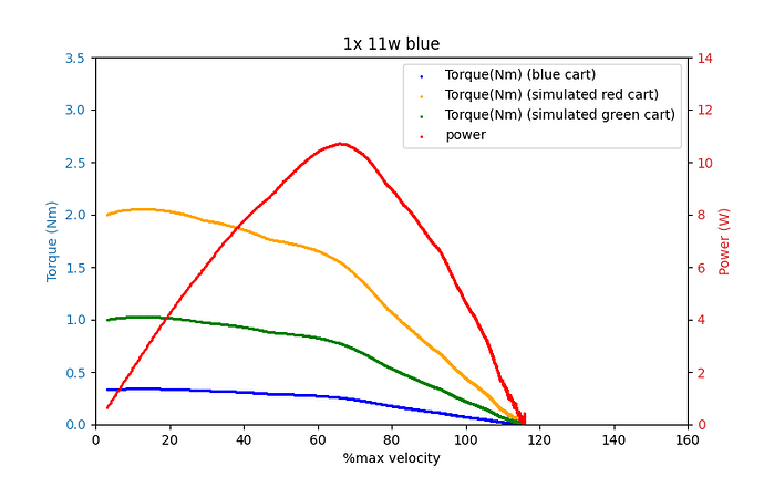

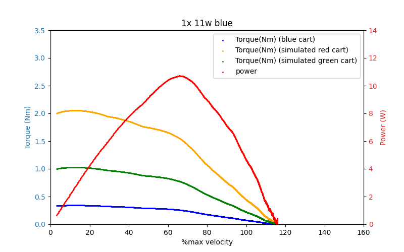

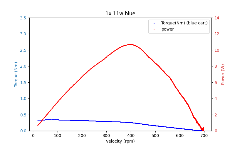

11W Motor
By % of rated velocity
Absolute velocity

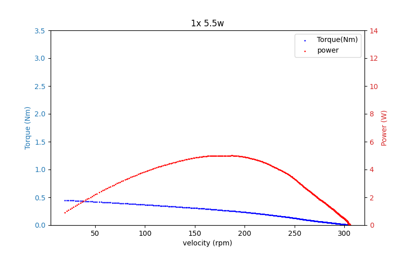

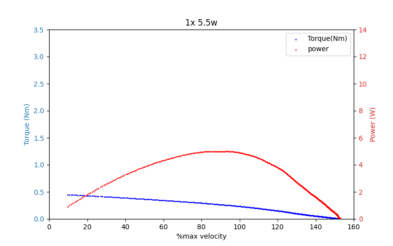

5.5W Motor
Absolute velocity
Discussion
The 11w motor’s performance largely lines up with what we expected! We see a peak output power around 65% of rated velocity, though it is marginally lower than we might expect (11W vs 12W). We also see that the flat current limit may not actually yield a quite flat torque output. The effect of the current limit is clearly visible, but the torque does still seem to peak near stall and gradually decline while under constant current, before finally declining in the right half of the graph.
The 5.5W motor’s performance differs quite a bit from the graph from VEX, though of the two motors this was more expected given the synthetic appearance of the 5.5W motor graph from VEX. First off, free spin velocity is around 150% of the rated maximum velocity. This means that if speed is what you’re after, utilizing pwm control for 5.5W motor can get you quite a speed boost (but not a power boost, of course). The peak power also appears to occur a lot later than predicted by VEX, at around 190 RPM vs the predicted 125 RPM.

I have a question. In the graph of the 11W motor torque curves, you say the red and green carterages are simulated. What do you mean by this?
To maximize data resolution, I picked the highest speed/lowest torque gear cartridge to spin the wheel, the blue cartridge. If for example I used the red gear cartridge, then the motor would fully spin up the wheel much faster, leading to fewer datapoints, more noise, and less accurate acceleration readings.
The simulated values are derived by dividing torque by 3 (for green cartridge) and by 6 (for red cartridge).
