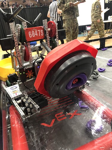

Hello Everyone. We got into world this weekend and we are thinking about finding a better design for our back claw. Does anyone have any suggestions or ideas? We currently have a piece of metal that comes down and holds onto the goals. Thanks!
some pictures of what your currently have would be helpfull. Are you currently using motors or pneumatics? Do you have access to pneumatics? What does the rest of your robot look like, and how much space do you have to design a new claw?

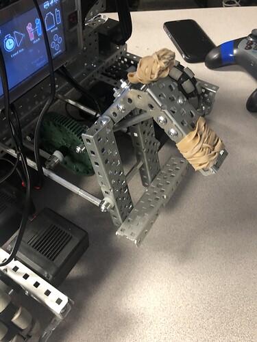

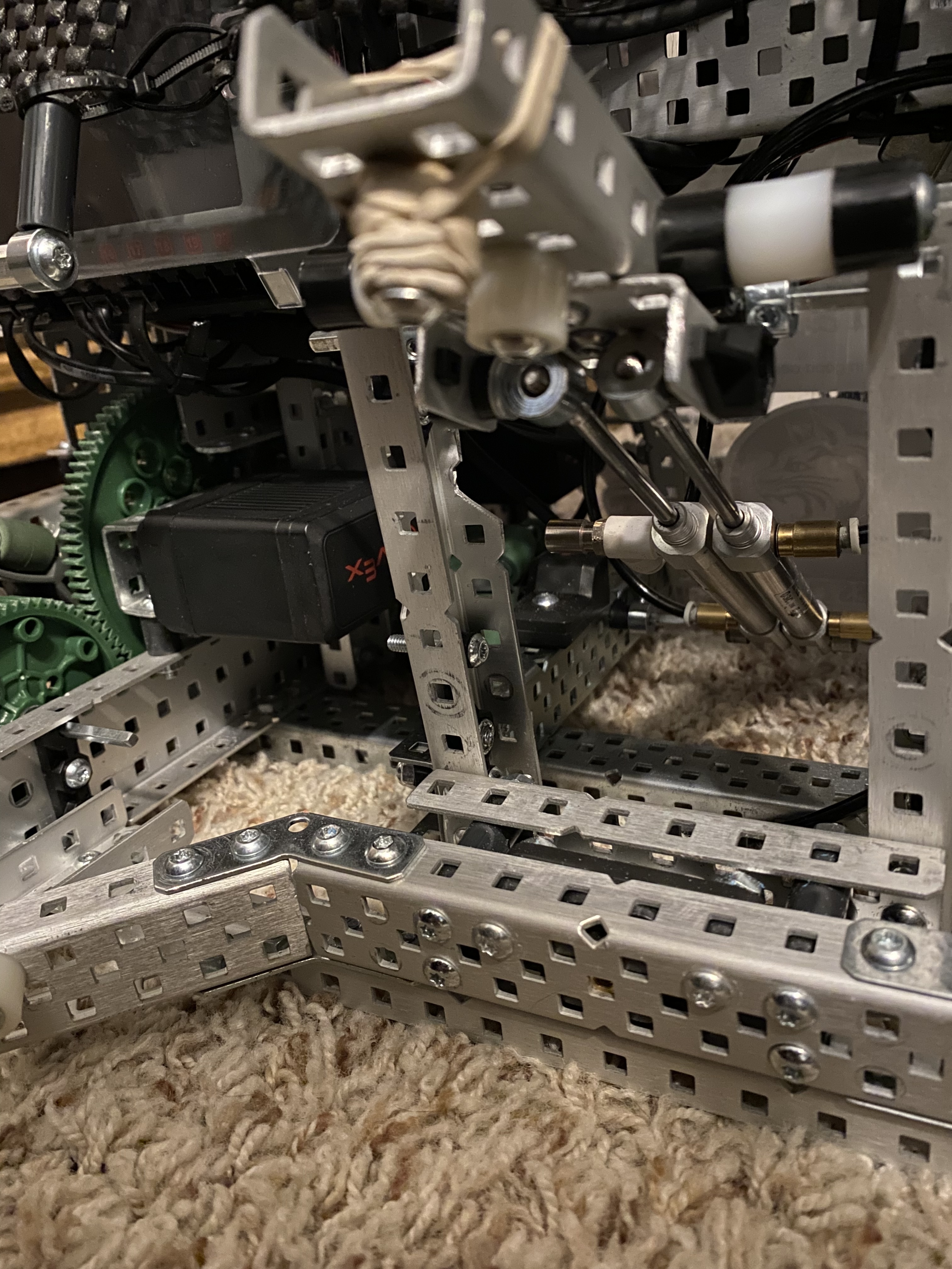

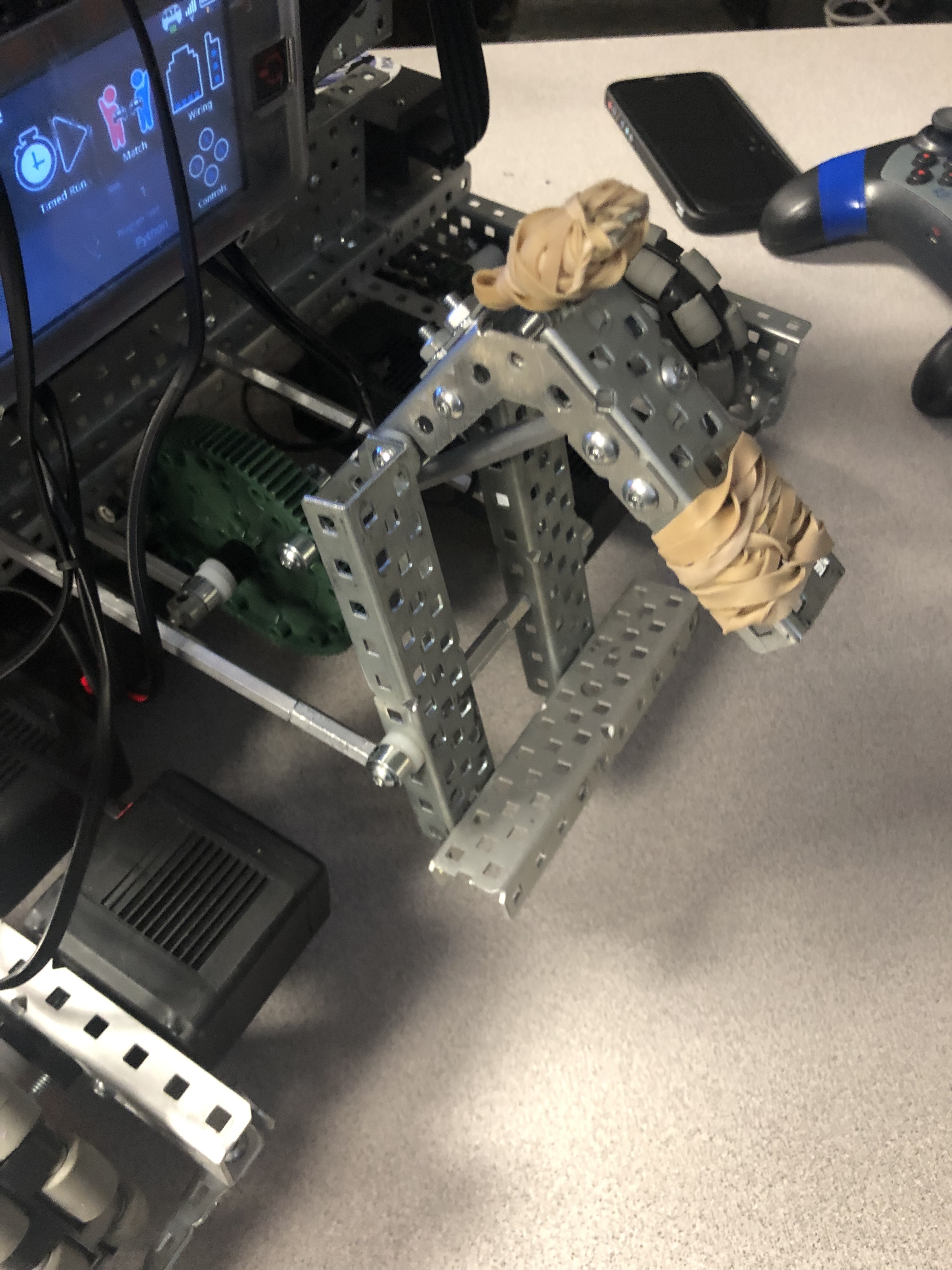

Here are some pictures of our back claw. As for your other questions. We have a pretty good amount of room that we can build into. We currently are using a motor, we have attempted to use pneumatics before and then ran out of time to make sure they worked, so I’m pretty sure we still have access to them.

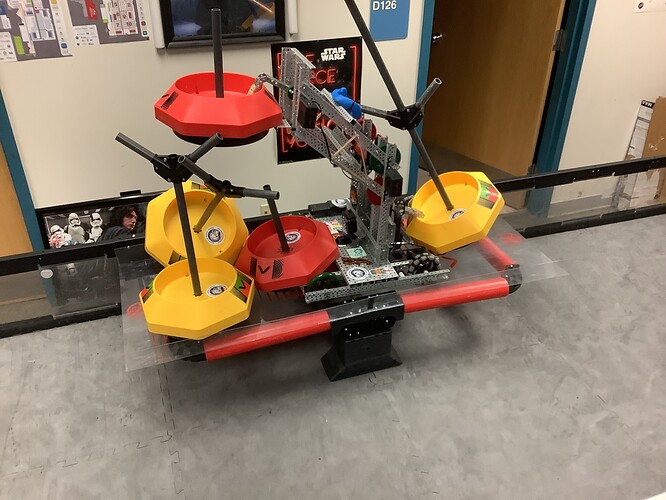

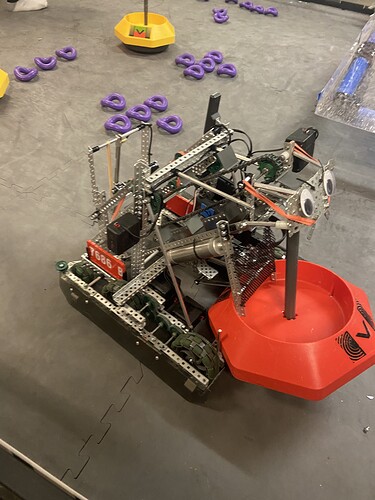

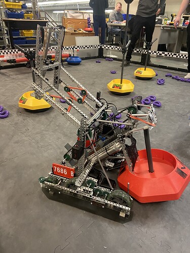

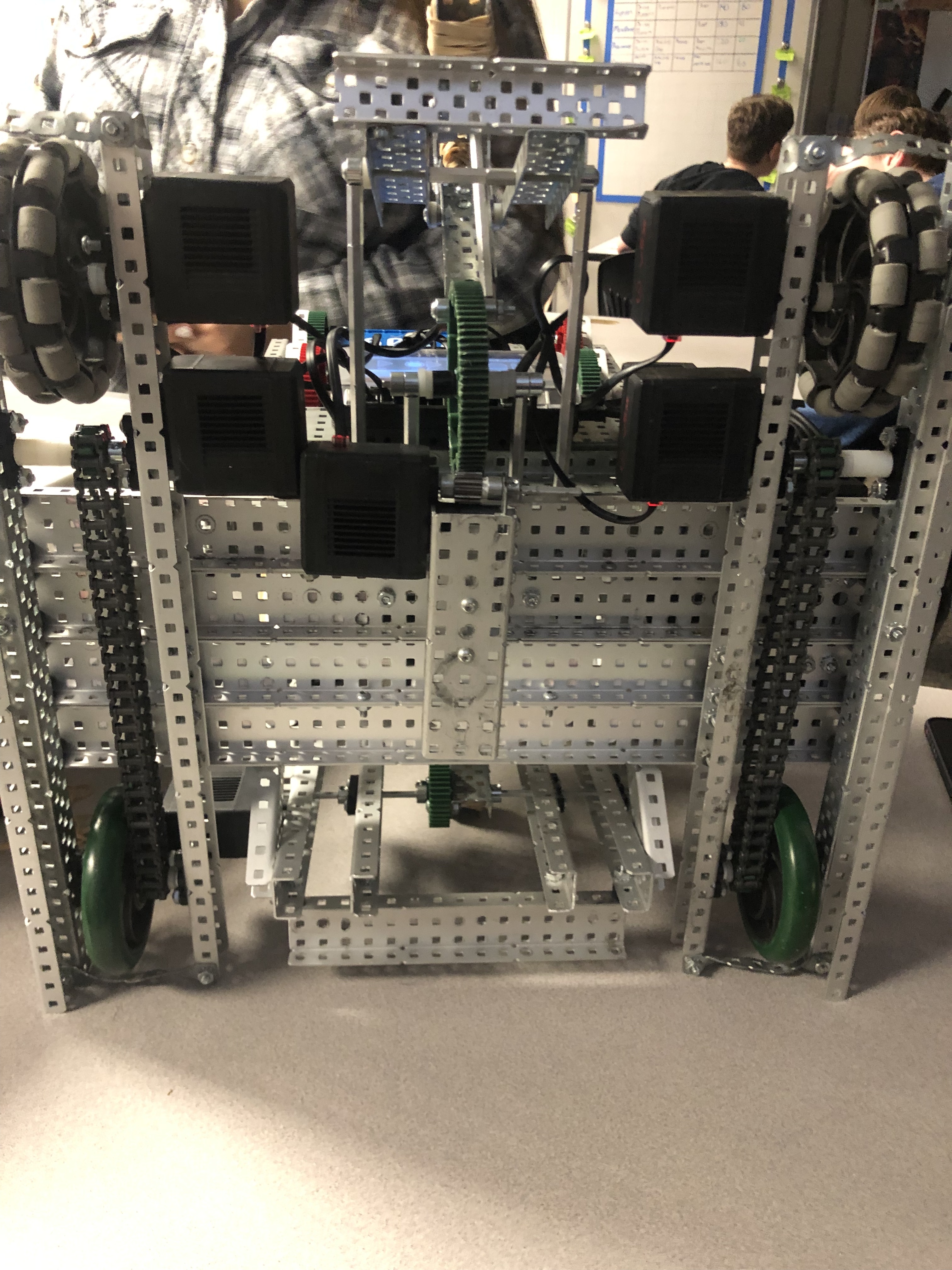

Not sure if you guys got a chance to see our design for our back claw yesterday but here are some pictures of it I took around 2 weeks ago when I finished the first build of it. There have been some small changes since then but it’s still the same design/concept.

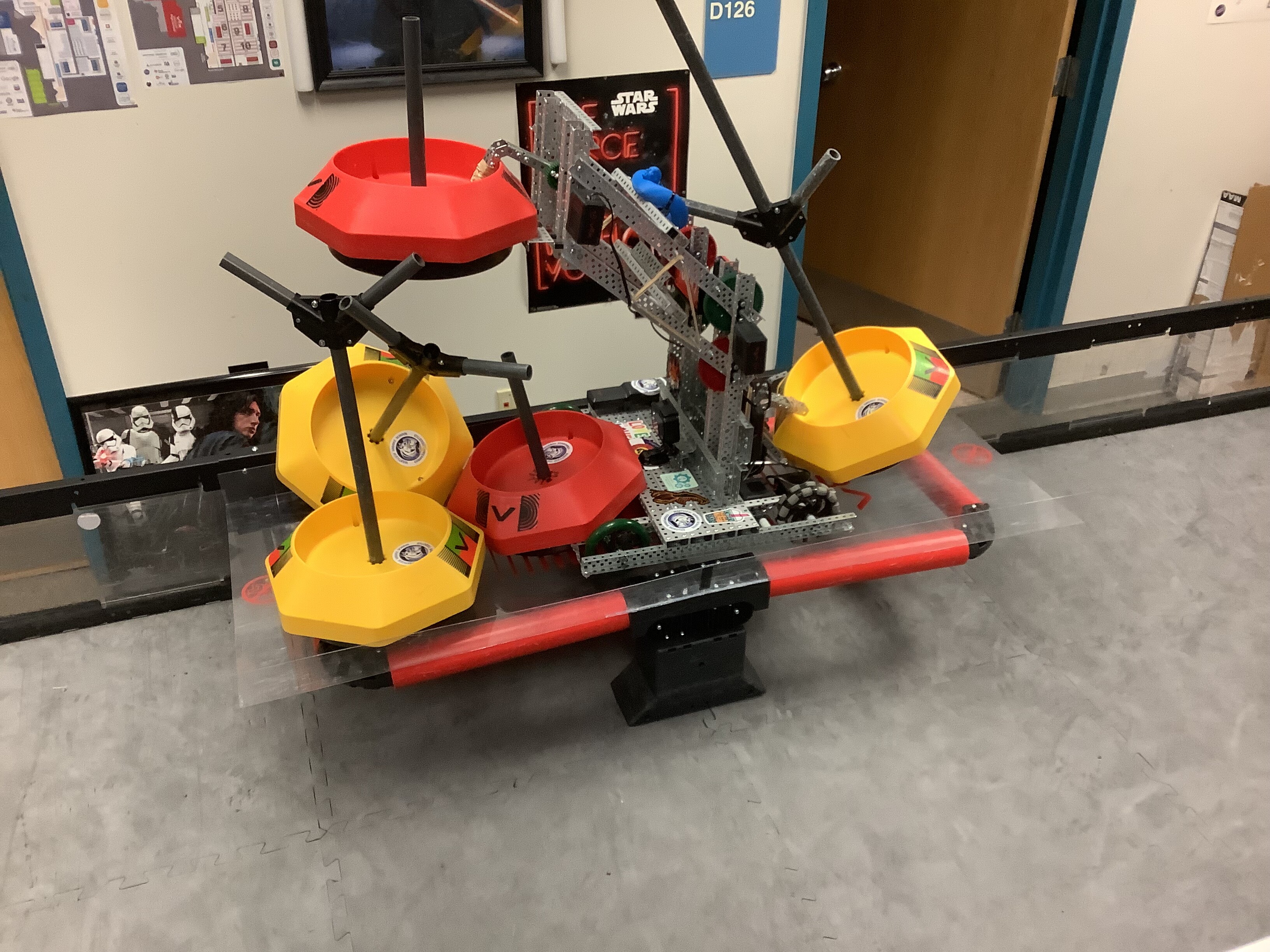

Here are some pictures of it in action.
It clamps onto goals and then tilts them and It only uses one motor to power it. Feel free to ask any questions about how it works and good luck at worlds :slightly_smiling_face:

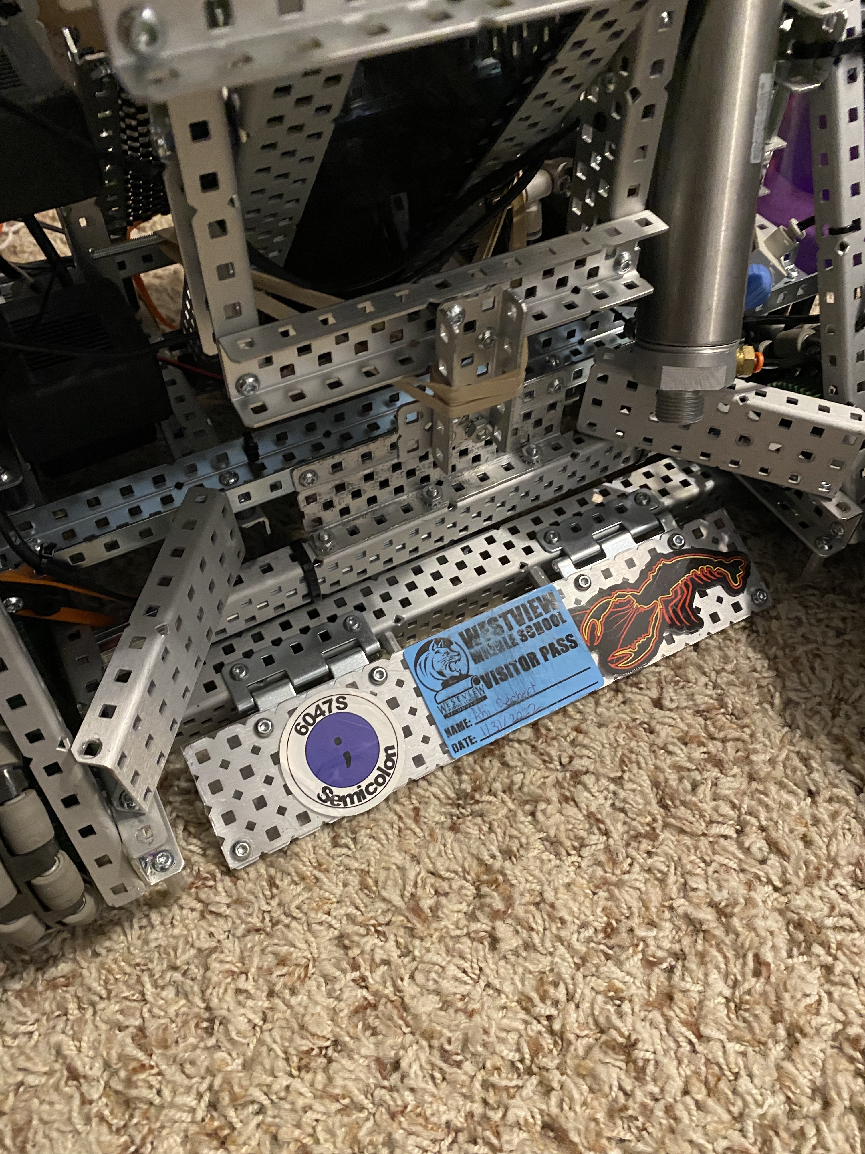

We actually have had two different designs on our past two robots. One has a ramp that the goal goes up slightly, and then the pistons pull it back with a lever arm thing, keeping it straight up and down. The other one has a design that we saw from a different YT vid, but it pulls back and tips the goal in one fluid motion with two pistons total. This design is also easier to score rings onto.

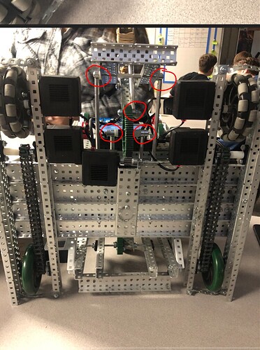

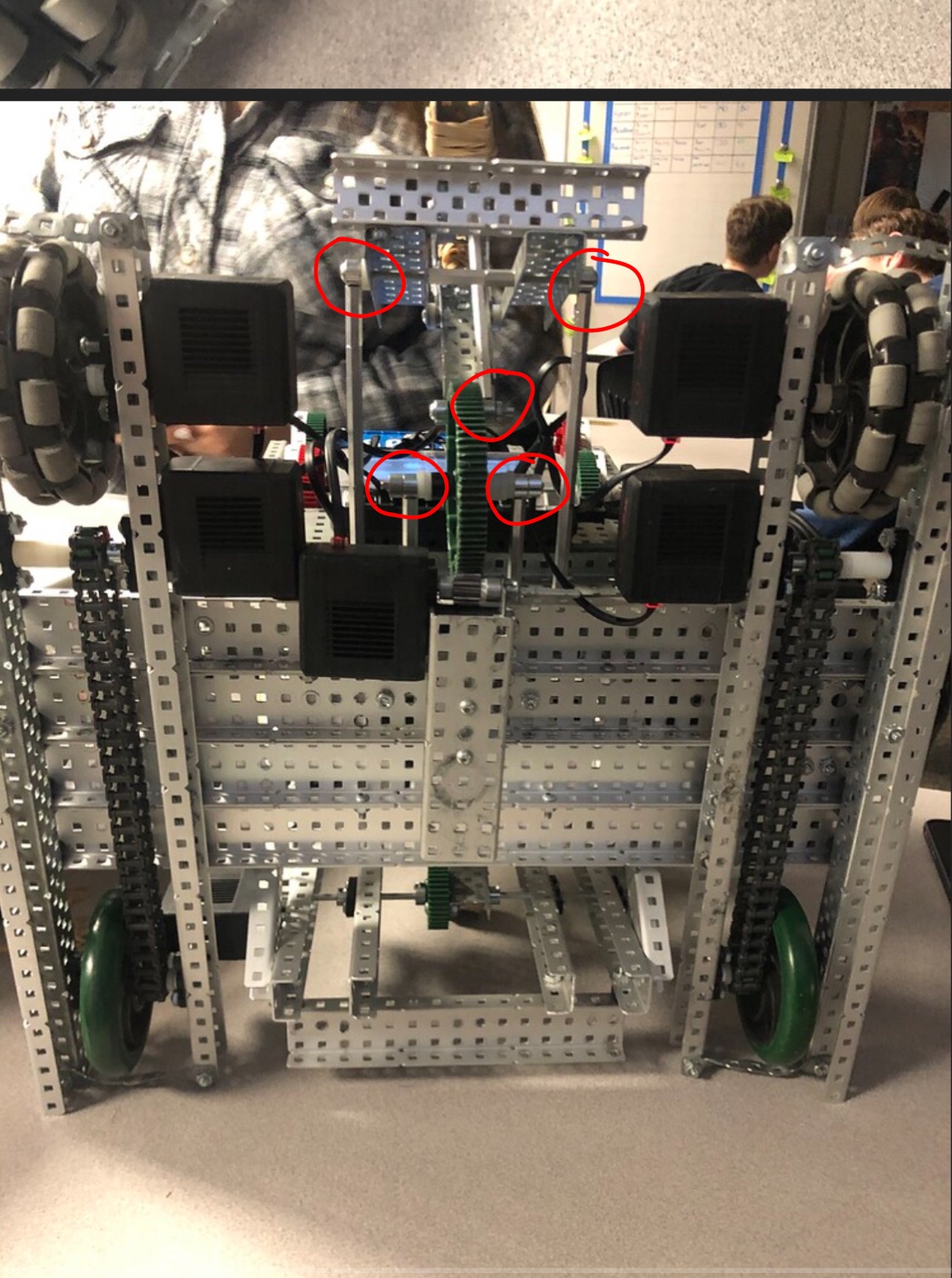

I just have one question. In the photos it looks as if the standoffs are connected to the shaft collars. How does this work? The picture below is where I circled all the areas I see this.
I’m guessing they used the stand-off connectors to make that connection. It’s a really handy way of connecting things at a 90° angle
Screws
Like @60Martian47 guessed, we used the stand off connectors (couplers is the technical term but I call them connectors as well). Very useful for a lot of things and a life saver in our design, it wouldn’t have been possible without them.

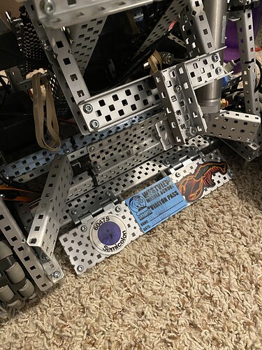

Here is what I’m talking about if you don’t know what I mean:
Here is ours :))
Don’t build jank tho jkjkjkjkjk

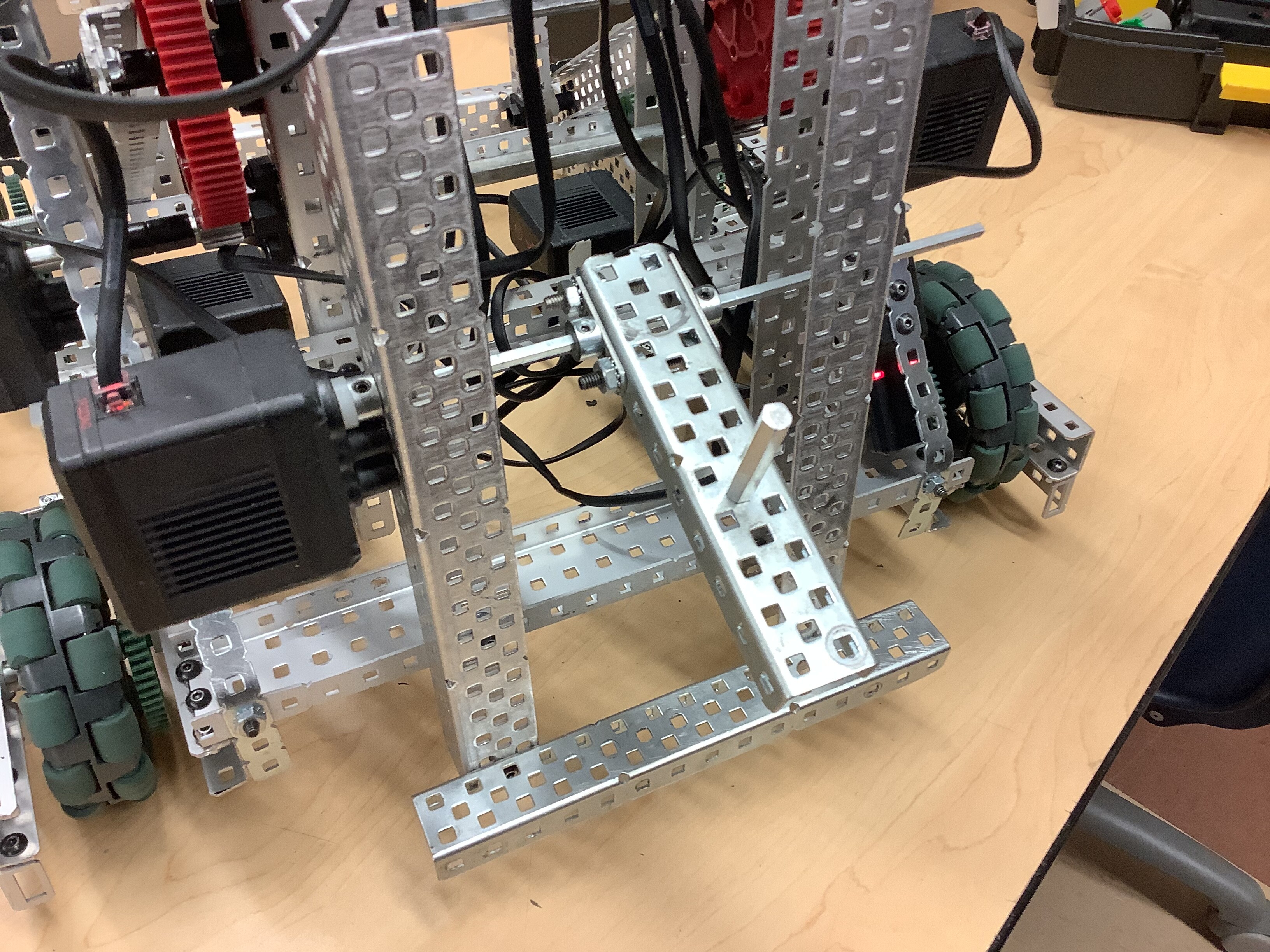

For all you underachievers - presenting:
The 5 minute solution!
  1. Attach motor to frame at correct height
  2. Cut axle to length (may require experimentation)
  3. Add 2 collar locks - one to hold shaft in motor, one with long screw to latch mogoal
  4. Program a 90* turn
YouTube is your friend. Or you could do this:
