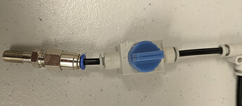

Normally you fill up your reservoir(s) using the Schrader valve (bike pump fitting pictured above) with a combination of an air compressor or bike pump. The issue with this technique though is as you remove your compressor from the Schrader valve, you still push in the core, leaking extra pressure out of your reservoir(s).

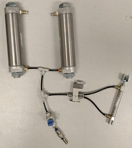

Instead of using this technique for my own robot, I instead use this system pictured here.
How this system works is by first connecting your two reservoirs together to have equal pressure, and have a main line, with multiple T fittings connected on the main line to accommodate the amount of cylinders you have on you robot. In this example there is only one extra T fitting to accommodate 1 double acting cylinder but in theory you could connect an infinite number of T fittings for how ever many cylinder you use.
The next part of the system is the pneumatic switch on the end of the main line. By switching the direction of the switch, you allow the pressure to stay in the system without it venting out of the switch.

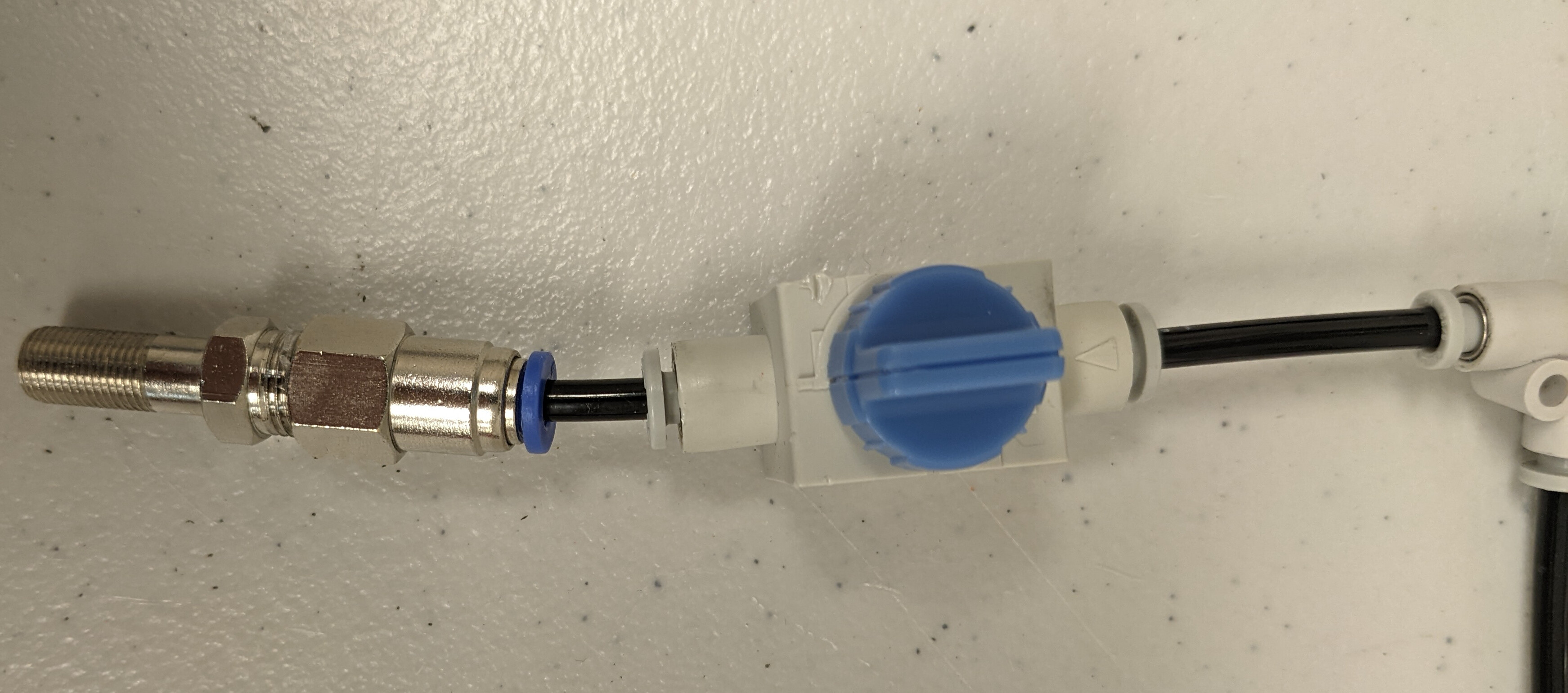

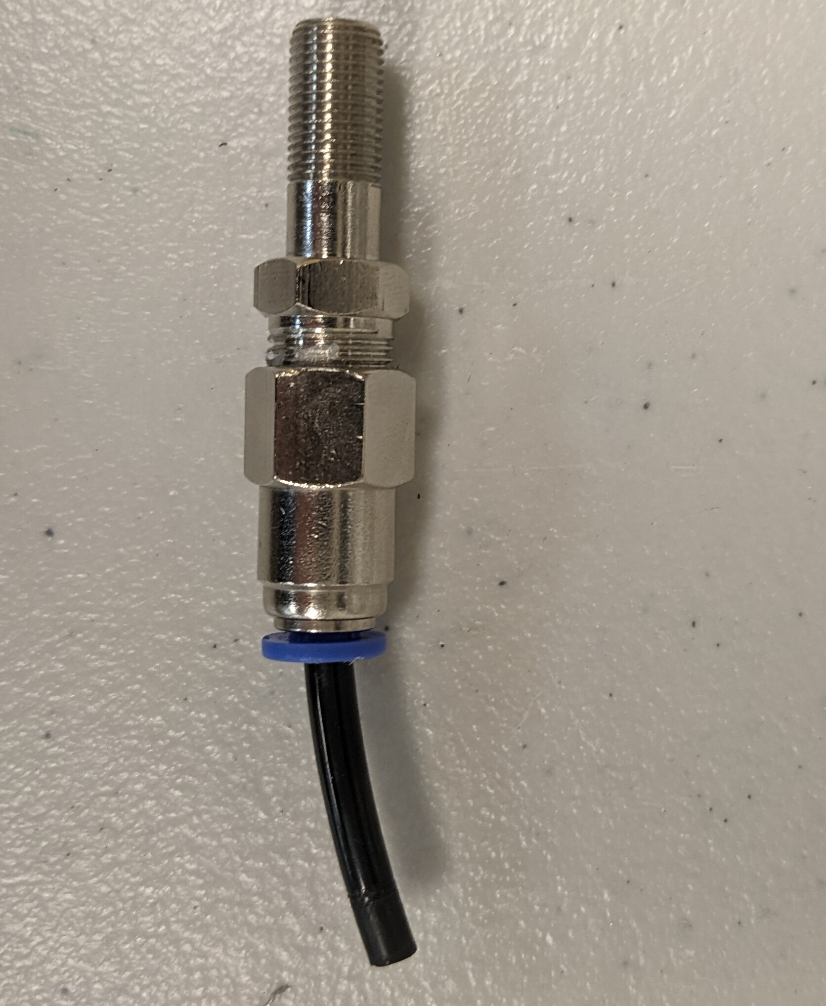

The last and most important part of the system is the fitting pictured above. For a pneumatic system to be legal, you have to use only the parts VEX sells or identical SMC parts. The fitting used here is not listed on VEX website or rule book and IS NOT LEGAL WHEN ON YOUR ROBOT. However, you can still use it to fill up your reservoirs. The fitting, which is a Schrader valve connected to a 4mm tube fitting, has a little bit of tubing connected to the end. You put that into the pneumatic switch, open the valve, and pressurize to 100 psi like normal. You then close the valve with the switch and only lose the air between the fitting and the compressor.

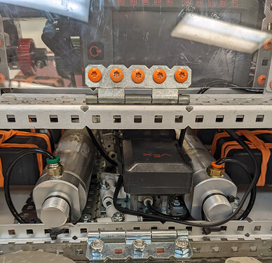

The two biggest advantages to this technique is the ability to place your reservoirs anywhere on your robot and losing the smallest amount of pressure possible. For example, right now on my robot, to aid balancing, I need all of my weight to be at the bottom of my drive base. With the technique I explained above, I am able to place my reservoirs in a really tight space all the way on the bottom like shown in the picture bellow.
Also, by filling my reservoirs with the normal valve, I would lose 10-15 psi. With the technique described above, I only drop to 1-3 psi. The link to where we got the Schrader valve to 4mm tube fitting is here. Let me know if you have any questions about the system and how to use it or if you have your own technique to hold more pressure.

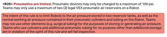

I am not sure of this.
Screen Shot 2022-01-13 at 6.02.50 PM
R25’s note says that you can’t use other elements to store air pressure. BUT it says if the only purpose of this is to is to store air then it is illegal. A large pneumatic system could store plenty of air at pressure in the tubes with this system.
I want this to be legal but it treads quite closely to possibly violating this rule?
But this would be for filling up the air and not extra storage per se. It does save on losing air but I don’t think it’s illegal
This is the best solution for pump release leakage.
To make sure that there is absolutely no shortage of air (anything below 100 psi), I would also advise using a pump with a pressure gauge and pump up to ~105, so that when the tiny release leakage comes, you will still be at the highest possible legal psi.
Of course, if you are worried about the legality of this, you can always ask your head ref.
I think that this is very clever solution and it is perfectly legal to leave on the robot during competition.
Because, once you seal the pressurized side of your system with the turn of the blue pneumatic switch, everything on the other end of the switch, including fitting and valve, becomes non-functional decoration.
I think, it’s common sense.
It’s probably safer to just remove the fitting from your robot because, yes it is at that point it is non functional but it’s never worth being DQ’ed for something like this.

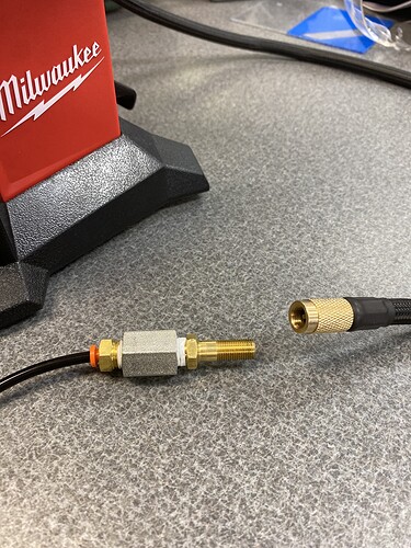

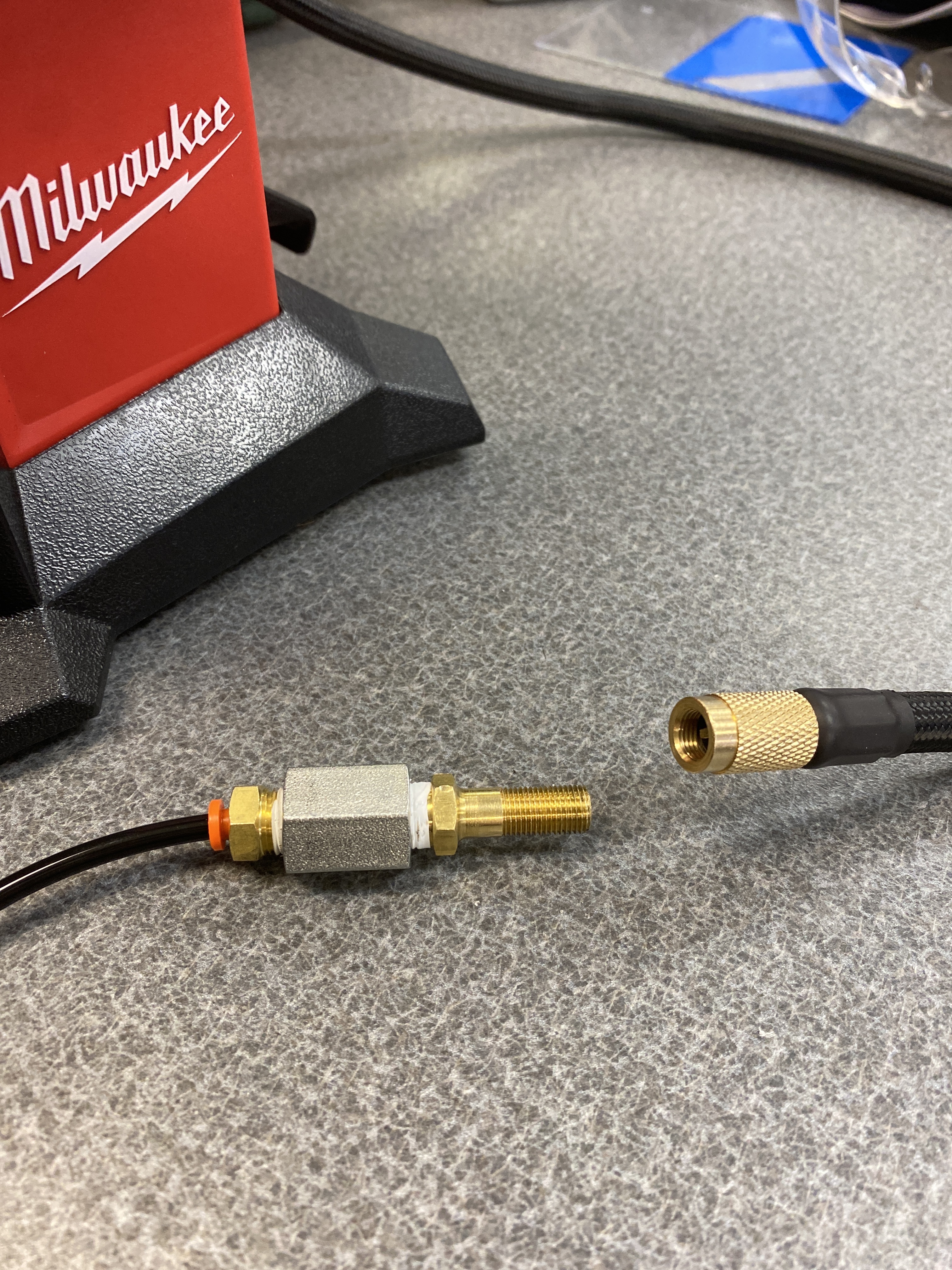

So glad someone went through the work to post something in this topic. I had this same problem about a month ago and I needed the fitting asap. Our main issue was the threaded screw on fitting in the portable Milwaukee compressor was loosing too much air when disconnecting the fitting, so I went online and assembled my own fitting. It’s the same thing adapting the bike tire valve to 4mm tubing but I bought the parts individually off of Granger (links below) because of the fast shipping compared to SMC, also it was relatively cheap for around $8.90 before shipping and tax.
4mm fitting
Connector
Tire valve (can only put 2 links so part number is: 1X361)
