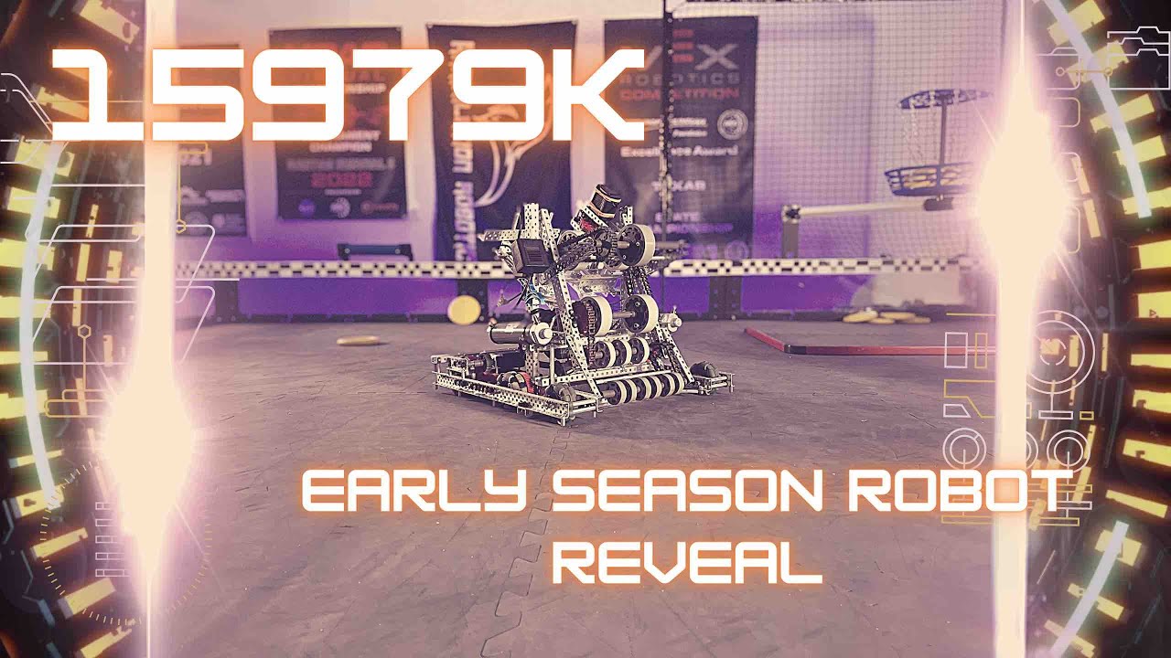

  5. post a photo of the bot in question: overall pic and some good close-up pics of motor shafts, flywheel shafts, etc. Any other pics showing grounding between robot subcomponents would be good also.
This is the robot I am working with:
There should be some good close-ups in there.

I’m talking specific pictures of shaft ends, clearly showing the structural metal, shaft, bearings, spacers, shaft lockers, etc.
I caught a glimpse of a shaft on the bot in the video. It looked like you could hang a metal washer on the shaft where it would randomly touch the frame and bleed off any charges.
In our case pictures would definitely prove your point as we always make every effort to have Teflon or nylon washers between shaft collars and aluminum. While I still disagree with shaft collars rubbing against aluminum frame (one time we did that by accident and the shaft collar literally ate a thick layer of aluminum), you mention using metal washers in your post, that would be an acceptable compromise.
Also question to you and the rest of the community: would a very tight cable management help mitigate this? As in zip tying the cables along a c-channel for example? Also keeping cables away from shafts?
If charge can jump between 1 motor/brain wire into a group of them, you might end up with multiple burnt motors/ports.
If you leave space enough for a sheet of paper/fingernail between shaft locker and AL: 1) friction won’t be a problem 2) natural shaft movement back/forth will let the metal get close enough to ground the shaft.
