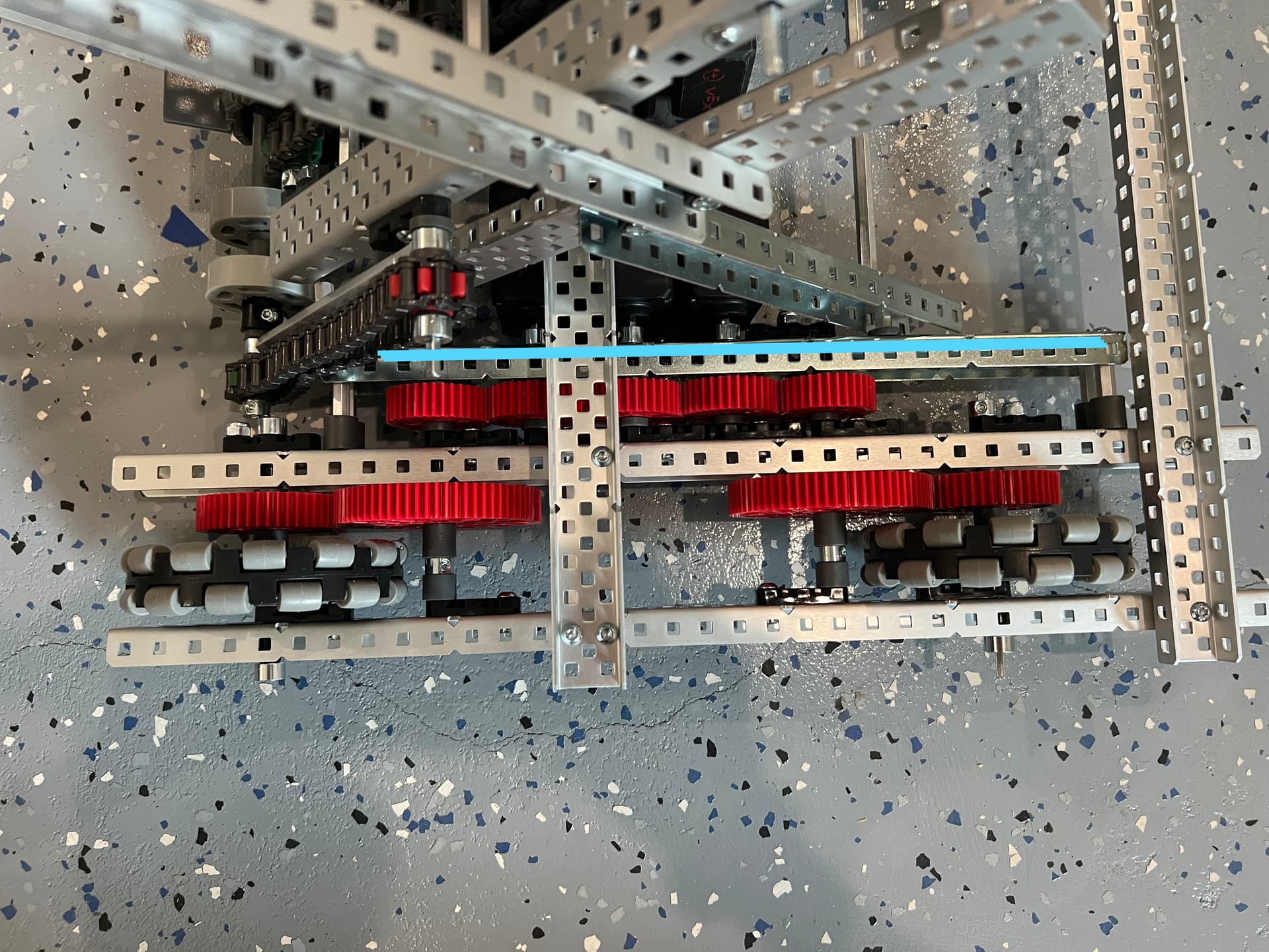

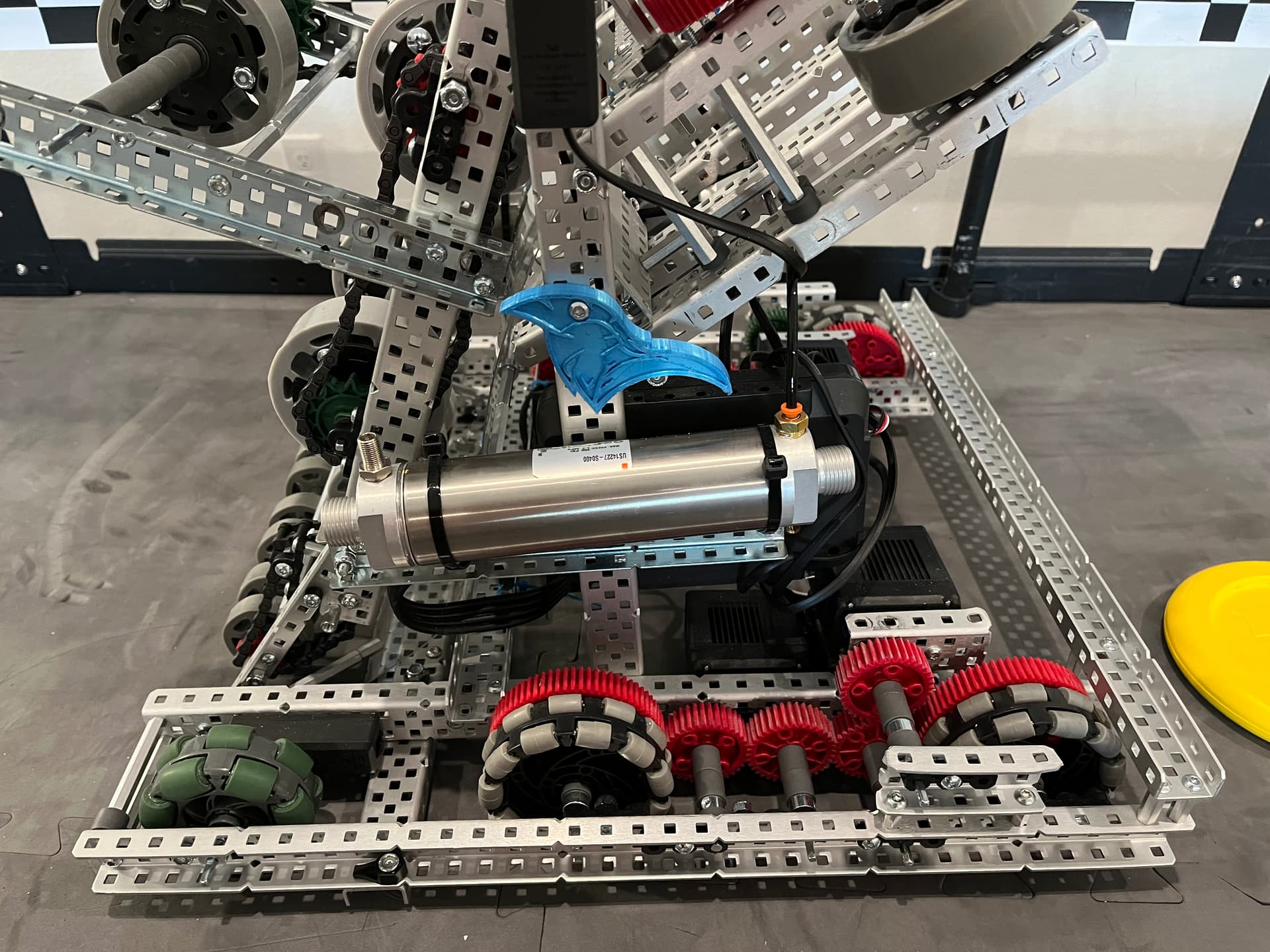

my team has been having problems with motors breaking. the motors would seemingly completely turn off. the port turns dark (not blinking, like when a port is blown). this has happened on two different robots and two brains. the brain doesn’t recognize the motor at all. this has happened three times, and all with motors we bought this summer.
attempted solutions and tests
  • I tried plugging them into different ports
  • I tried swapping wires
  • I completely disassembled one of the motors and testing it with an Arduino
  • I tested the DC motor inside to see if it was the problem
if it helps, these have all been drivetrain motors, but three quarters of our motors are on the drivetrains of our two robots.
if anyone has had this problem or knows the solution, please let me know.
thank you!

Yep! I have one 300 RPM robot with 4 inch Omnis, and 300 RPM drive with 3.25 inch Omnis. Every single motor on each drive drives the same size gear.
Note: I just noticed one of the motors on the second drive may not have been spinning at all, which could have caused the other two motors on that side to work harder.
Do you need to see a picture of the drivetrain to fix the problem?
It wouldn’t hurt
