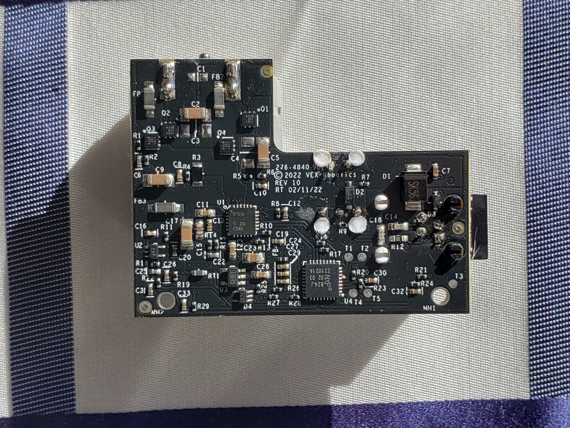

Thanks to @district9 I now have a picture of the PCB of the Rev 10 motor:

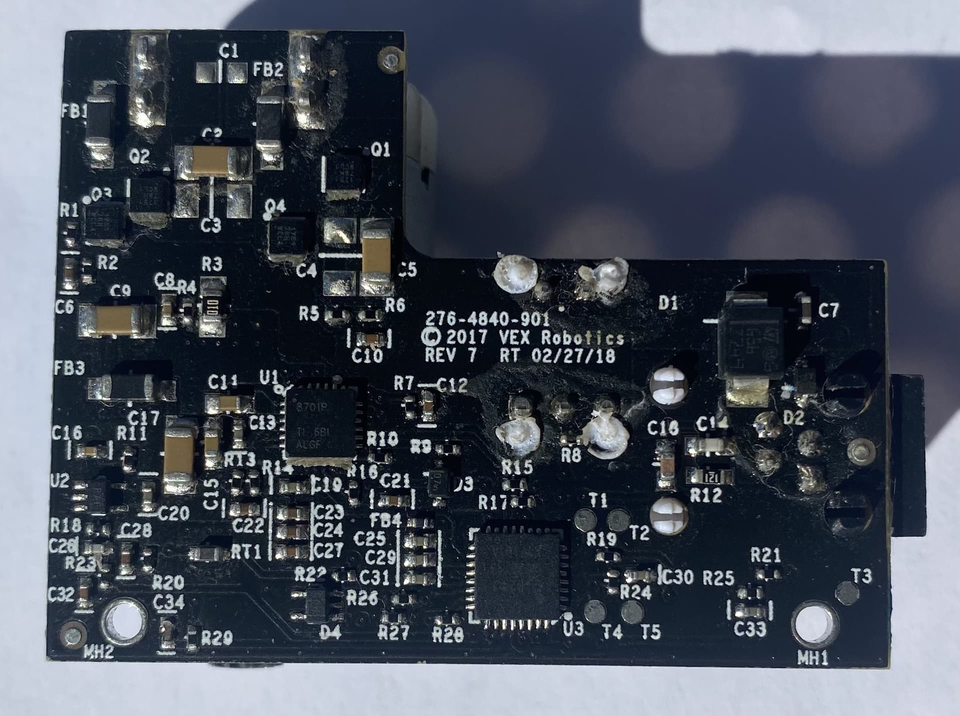

Lets compare this with Rev 7 motor I had around:

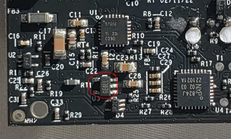

We can see that there are a few changes in the lower left portion of the board, in the area between the motor controller and the MCU, including the addition of a new component which I have not been able to identify yet:
We also spot an interesting and potentially significant change: the Motor controller (upper left and slightly smaller square) is now a TI 8701E whereas previously the Rev 7 motor used a TI 8701P:

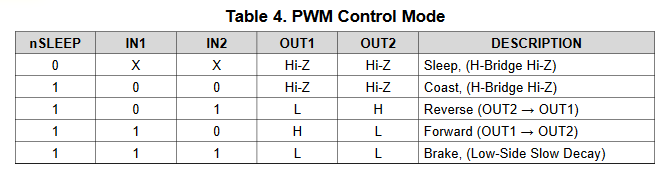

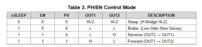

The datasheet says that the difference is that the P variant uses 2 PWM inputs for control, whereas the E variant uses a ā€œPhaseā€ and ā€œEnableā€ pin set, which effectively mean a direction pin and a duty cycle pin. this would also mean that the firmware on these parts would likely have to be somewhat different in order to utilize this different interface.
Looking on TI’s website we see 2 differing truth tables for these parts:
Of note, there is no entry in the truth table for the E variant for Coast mode. This does not necessarily mean any change to the abilities of the brake modes of the V5 motor, but it is potentially relevant. If anyone has a working Rev 10 motor it would be great if they could do a comparison of the coast behavior of that motor vs a Rev 7 motor.

Is that heatsink paste under the ā€œPā€ chip?
No, there aren’t any heatsinks on any of the motor components. Probably just some dirt, I’ve had this board out for a couple years now. I cracked open another Rev 7 motor to confirm and yeah, pins are clean like the Rev 10 board.
Ok. Maybe I’m remembering seeing small chips xfer heat to the board itself this way.

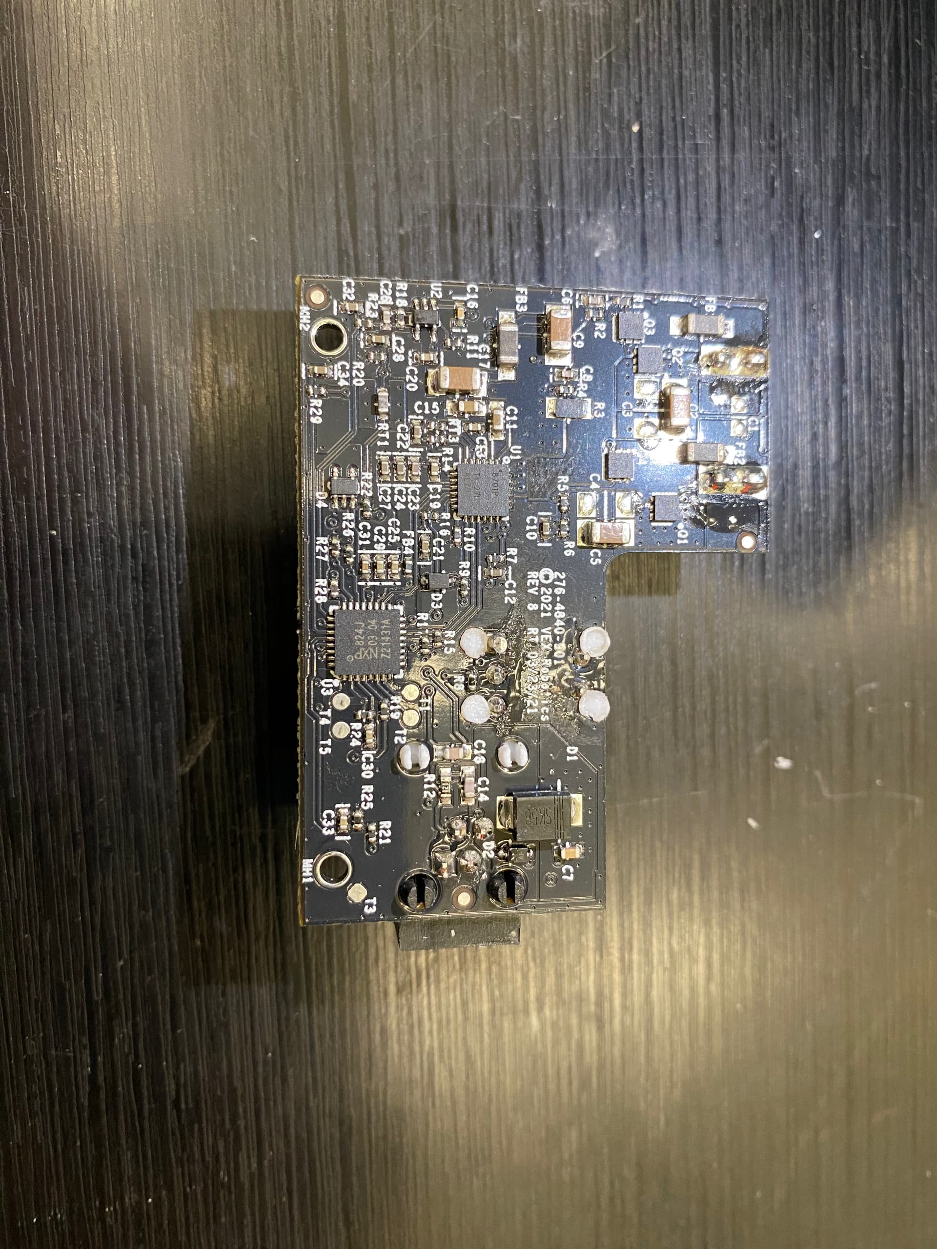

Now that V5 motors have begun shipping again, I opened one up to see what changed:
It looks like the new motors now shipping have switched to Rev 8 boards, in contrast to the problematic Rev 10 motors. I can’t seem to find any easily visible differences when compared to Rev 7, and the original Rev 7 motor controller, the TI 8701P, has returned.
