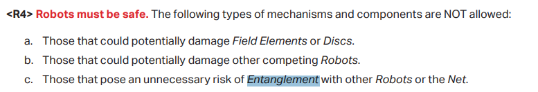

Relevant robot rule:
The questions is: does laying rope down in the last 10 seconds count as an unnecessary risk. I think it might. Laying it on the ground seems like a pretty safe trategy though.
I worry about it getting sucked into somebody’s intake - but the intakes probably wont touch the ground.
Alternatives that can’t get sucked up might be better - some folks have mentioned chain, tank tread, and non-stick mat. But none of them could pack as much distance in such a compact space.
Edit: Looking at <R4.b> I think string is probably too much of a risk to other robots.

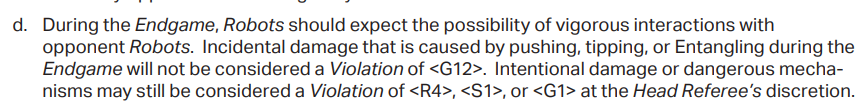

Edit2: Huge thanks to @xTigr - Rule G12.d makes room for mechanisms that cause incidental entanglement, but not intentional entanglement or dangerous mechanisms !

What about G12.d? It seems like as long as you are not intentionally getting entangled it should be fine right?

Editted my prior post to reflect G12.d
I still think a head referree may require you not to use or to disable/remove a mechanism that repeatedly causes damage to other robots.
But what about ... dangerous mechanisms may still be considered a violation ...? You don’t think the Head Ref will say, “Look at that tangled mess, so dangerous, DQ.”

That’s a good point, but I get the feeling that the GDC made this rule with the intent of letting people have expansion mechanisms that may entangle. There will likely need to be a Q&A on this topic to clarify whether they meant to allow mechanisms that may pose a small risk, but it seems like it should be allowed as long as the mechanism isn’t intentionally destroying robots.
