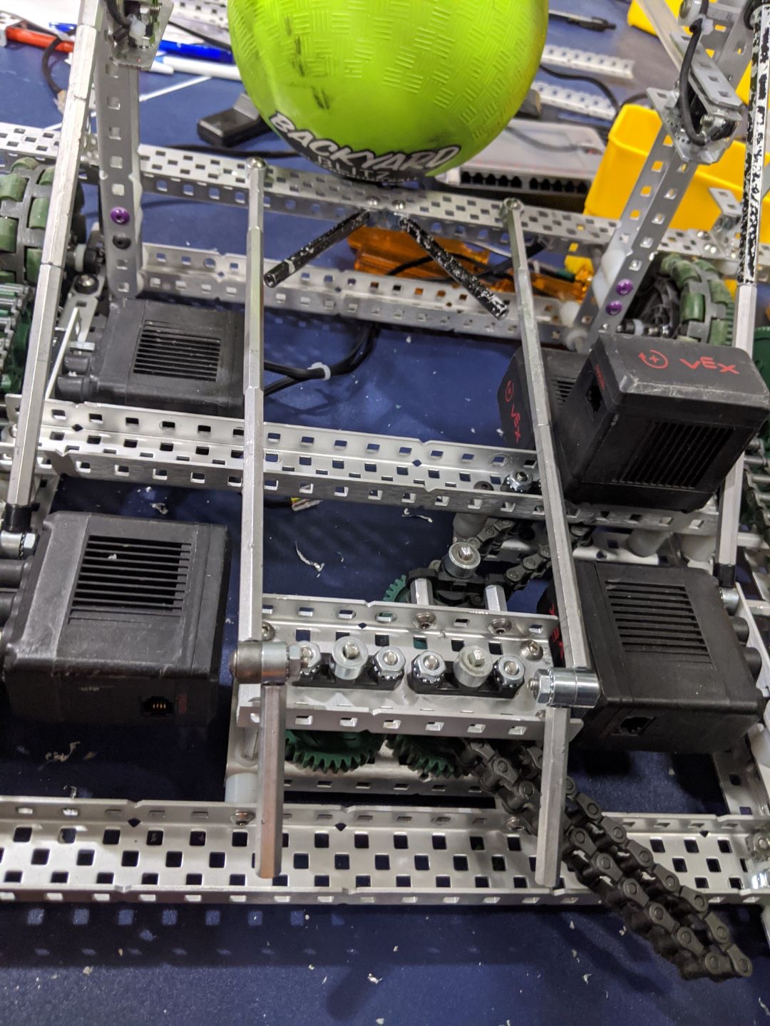

It’s been a long day but I’m proud to announce to you the team MARC robot in 24 hours build. If you have any questions about the bot, our design thoughts, or really anything feel free to leave them below.

Is the bottom intakes controlled with only 1 motor?
Yes. 2 for the upper intakes, 1 for the bottom ones

How did you power the bottom intakes with one motor?
Images?
yes they are both controlled off of one 200 rpm motor
we coded them for drive on right analog, intake on right 1 and 2, lift on left 1 and 2, and the hoarder intake on the left and right buttons
the motor is on the right side between the 2 drive motors and it chained to a gear box. that distribute the power to 2 other sprockets that then get chained to the roller
sprocket and chain most likely
