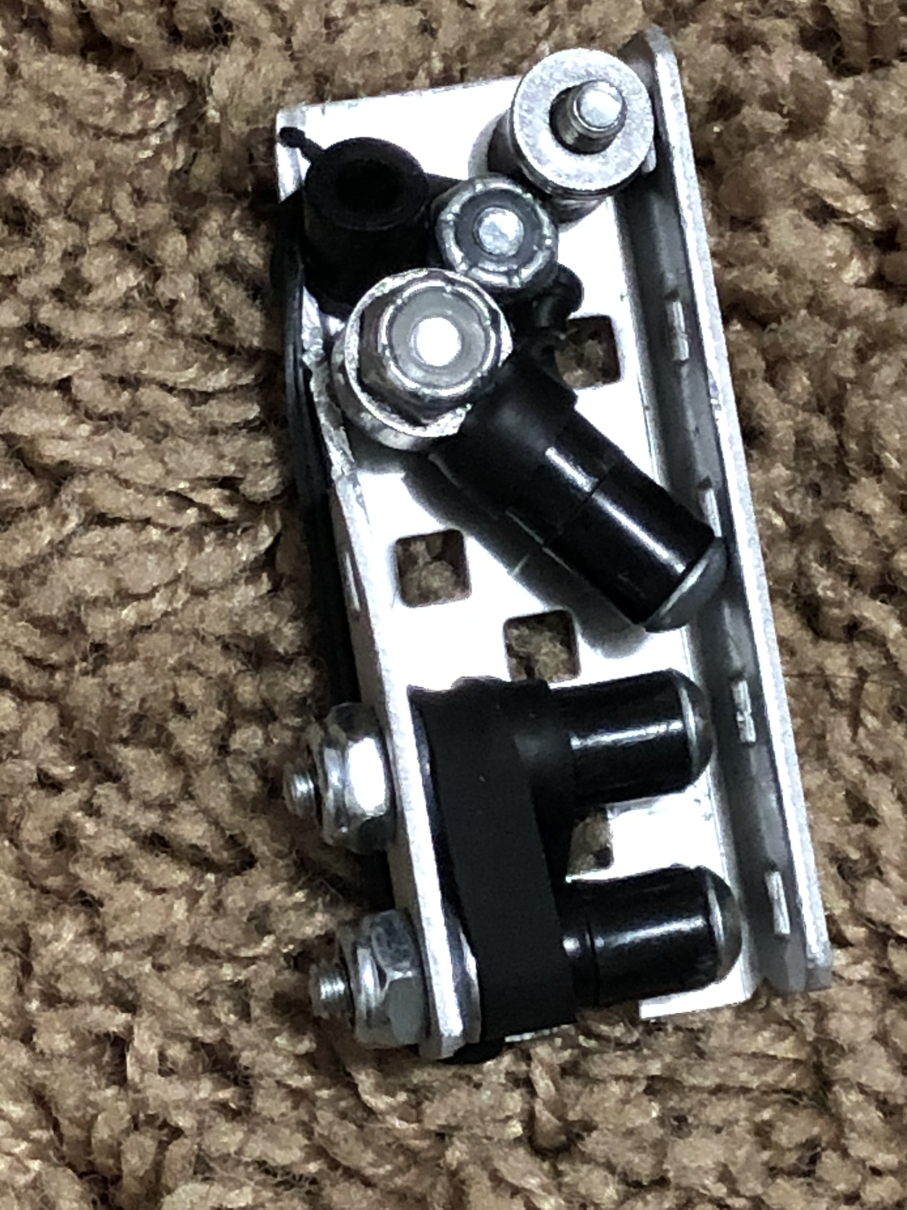

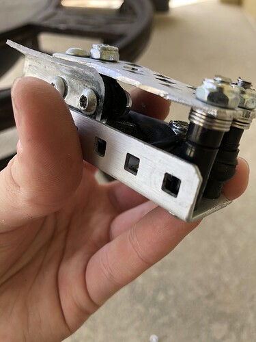

i actually made the locking slider mechanism in my profile picture with nothing but aviation snips. here are some closeups

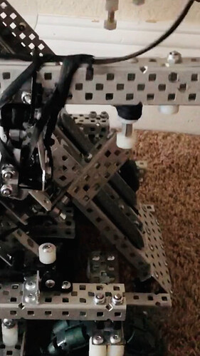

and here it is on our worlds tt bot:
it was used alongside the mechanism seen here:
which was used to keep the arm at a harsher angle for sizing. the slider on the arm was then used to change the maximum and minimum stroke of the cube lock to match that of the new minimum arm angle.
