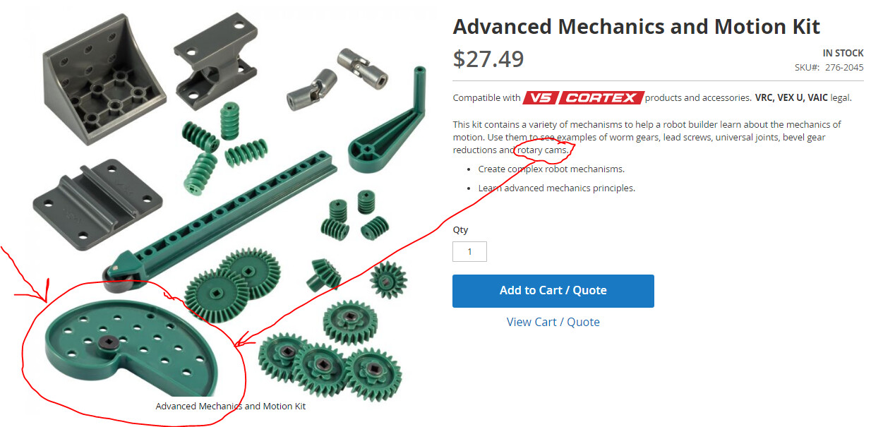

If you only need to lift it about an inch off the ground, would you consider using a cam? You could set the lift right on top of the cam and it would only lift a little bit.
I honestly don’t know what a cam is
Would that work for a mobile goal?
