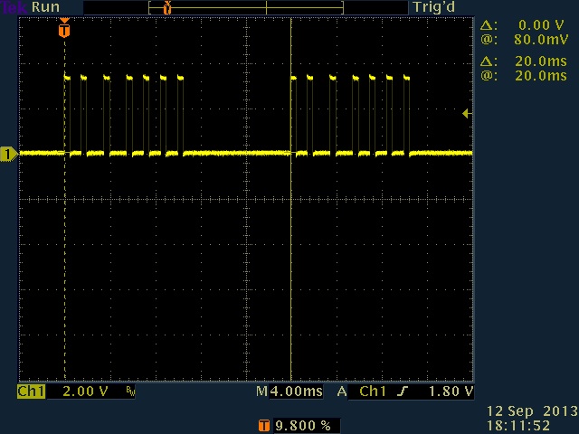

Yesterday we touched on using the signal splitter in another thread.
https://vexforum.com/t/receiver-connector-color-coded-pinouts-from-ask-the-staff/24340/1
So I figured that it may be fun to create the ppm waveform on the cortex and allow additional motors to be used with convex (not competition legal of course).
Timer 1 on the STM32 happens to have outputs that align with several of the digital output ports. Using it in PWM mode and changing the parameters for each cycle under interrupt control allows a pretty stable waveform to be generated.
[ATTACH]7617[/ATTACH]
Here two motors are running at maximum speed whilst the other are stopped. I may need to flip polarity of the waveform for the signal splitter, but that’s an option when the init function for this is called.
So now you could have 16 motors on the cortex and perhaps ( using one further timer or more complex timer 1 control) 22 would be possible.
I will include this code at some point as part of an “extras” release.

You’d have to watch the current limit for the LM2490 regulator though wouldn’t you? or perhaps provide an alternate source for the battery supply to these motors?
https://vexforum.com/showpost.php?p=326053&postcount=1
Looks fun. Kb
I believe that he intends to run the motors through another motor controller with its own supply, which would not strain the internal LM2940 regulator.
PROS has PWM drivers utilizing Timer 1 that can perform this task (and many others), but they are not compiled into the released version to save on code space, as high school teams would have no use for them. We have found potential uses for college teams to achieve 12 independent motor channels (legally, we believe) by running these PWM drivers to generate motor control signals through the power expander.
With a sufficient number of power expanders, up to 8 additional motors could be controlled on top of the 10 already plugged in, more if Y cables are used. This is obviously ludicrous overkill but a fun diversion for “what if?” designs.
Correct, plan was using the signal splitter.
For standard RC PWM, it looks like all four timer 1 channels are run to digital ports and, with clever enabling and disabling of the normal and negated outputs, you should be able to get 7 pwm channels running. Timer 3 is available on 2 more digital outputs, so perhaps 9 total pwm channels. I don’t think that using a power expander would be competition legal as the motors could not be disabled by field control without intervention of the user software.
What I had done is combine 6 channels of “normal” pwm into one PPM signal, so all 6 motors are controlled by the one digital output, this keeps the digital ports available for normal IO use.
Timer 2 and Timer 3 are connected to the RX1 and RX2 connectors, they were inputs for PPM signals originally but are not supported anymore (officially) by ROBOTC or EasyC. They could also be run as outputs so that may be a better way to connect, I’m not sure about the need for a crossover cable in that case though.
I have no plan to actually use this, but some other hobbyist may have a use in the future.

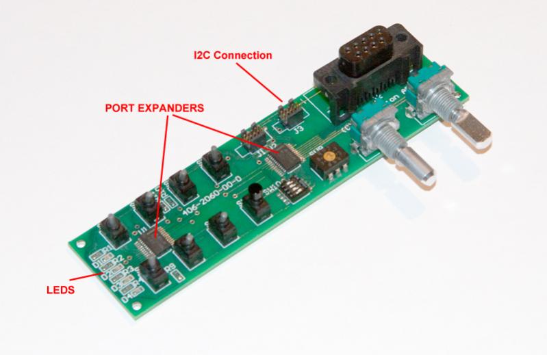

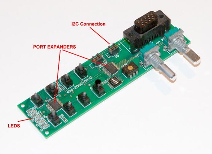

The only thing I had laying around for this example was a small switch board with a MAX7311 I2C port expander on it (actually two but only one was used in the code). This particular part adds 16 digital inputs or outputs for controlling switches, leds and anything else needing a single bit control port (it cannot be used for quad encoders or sonars). The datasheet for this part can be seen here.
Picture of my test board.

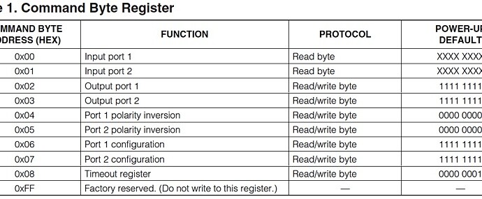

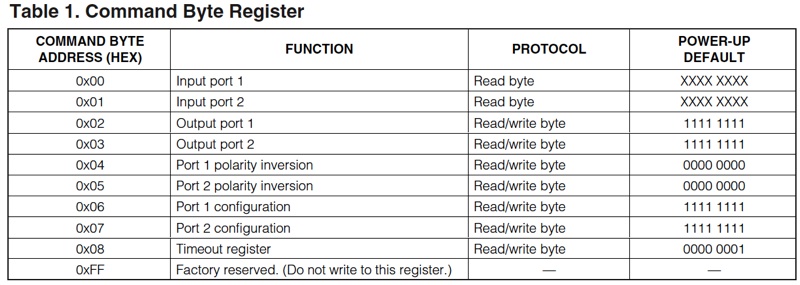

The part of the datasheet most relevant to this post is table 1.
[ATTACH]7655[/ATTACH]
This shows the internal registers, the general case for most I2C commands will be to send a register address followed by a read or write transaction. You can read the datasheet for details on the protocol and may also wish to refer to my previous explanation of the I2C bus.

Similar functions are used for other purposes. Here is the setup function that configures the port expander so that bits 12 through 15 are outputs (see the datasheet on the port expander for more details)
#define	PORT_EXP_ADDR	0x4C
msg_t
I2CPortExpanderSetup()
    msg_t status = RDY_OK;
    i2cflags_t errors = 0;
    // two bytes sent to port expander starting at register 6
    uint8_t txbuf[3] = { 0x06, 0x0F, 0xFF };
    // acquire bus
    i2cAcquireBus(&I2CD1);
    // send 3 bytes
    status = i2cMasterTransmitTimeout(&I2CD1, PORT_EXP_ADDR>>1, txbuf, 3, NULL, 0, MS2ST(4));
    // release bus
    i2cReleaseBus(&I2CD1);
    // Ignore status for now in this demo
    if (status != RDY_OK){
	errors = i2cGetErrors(&I2CD1);
This function sends two bytes to the port expander registers 6 and 7, it does not read anything.
The final function I used was for writing to the port expander output bits to turn on and off some leds. I used this function to write two bytes to port expander registers 2 and 3 (the data was also inverted as 0 turns the led on).
msg_t
I2CPortExpanderLeds( uint8_t device, uint8_t data )
    // two bytes sent to port expander starting at register 2
    uint8_t txbuf[3] = { 0x02, 0xFF, 0xFF };
    txbuf[1] = ~data;
    // acquire bus
    // send 3 bytes
    // release bus
