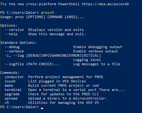

Your PATH is not updated - open a windows powershell type prosv5 at prompt if you don’t get output fix your PATH - if you do get output then there is a further issue - in which case uninstall pros, restart machine and re download the installer as shown in installation for windows guide, in my experience with students wrong path update ids often the reason for the described problem.

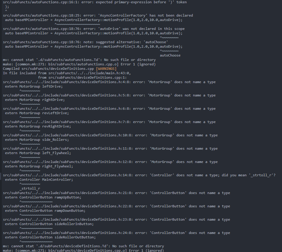

Screenshots of the errors
The images after I reinstalled pros (64-bit version).

To clarify a couple of things for you, cquery is only a linter. It doesn’t compile your project, so that’s not the issue. Paths to include files are agonistic of where the project is located, so that also isn’t the issue. The compiler would also spit out an error about not being able to find a file. Based on your thoughts, I’m guessing you ran into "main.h" Not Found (Linter), but this isn’t your issue here.
It very much looks like you’re missing an include/your code isn’t right. (Did you forget to push/change branches?)

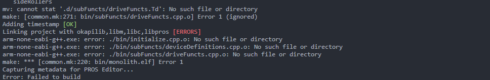

The issue is present all the time. Even when I pull or push. The image here shows an output from a project I pulled yesterday.

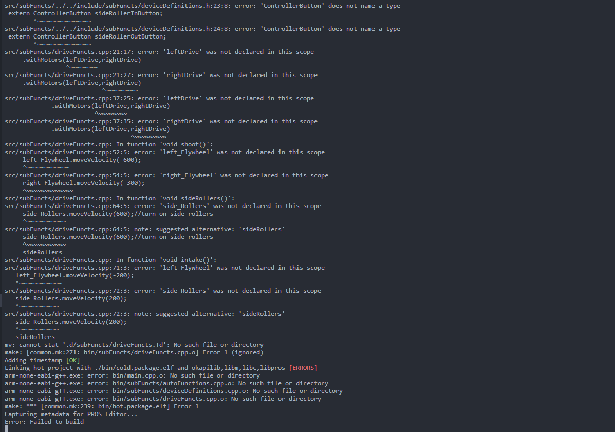

first, you don’t need the …/include part of the include. See the can’t find main.h link I posted earlier. Secondly, you have a loop in your includes. You have deviceDefinitions including main.h including deviceDefinitions. I’m guessing how different compilers implement pragma once is the cause of your inconsistency. You can fix this by including the okapi header in deviceDefinitions.h.
Lastly, it looks like you’re using the okapi 3.x api, but are building against okapi 4.x. There have been breaking changes in 4, which is why some other stuff isn’t compiling in the zip you gave me. Make sure you’re using the same version of okapi thoughout. You should be able to change the version with some prosv5 conductor commands (add --help to see what they all are).
So I tried the methods you mentioned (updated okapi, compiled the project using prosv5 command and fixing the inclusion by directly including okapi) but I still get this error.

Compiled src/subFuncts/driveFuncts.cpp [WARNINGS]
In file included from src/subFuncts/…/…/include/main.h:43:0,
from src/subFuncts/driveFuncts.cpp:1:
src/subFuncts/…/…/include/subFuncts/deviceDefinitions.h:4:8: error: ‘MotorGroup’ does not name a type
extern MotorGroup leftDrive;
src/subFuncts/…/…/include/subFuncts/deviceDefinitions.h:5:8: error: ‘MotorGroup’ does not name a type
extern MotorGroup rightDrive;
src/subFuncts/…/…/include/subFuncts/deviceDefinitions.h:6:8: error: ‘MotorGroup’ does not name a type
extern MotorGroup revLeftDrive;
src/subFuncts/…/…/include/subFuncts/deviceDefinitions.h:7:8: error: ‘MotorGroup’ does not name a type
extern MotorGroup revRightDrive;
src/subFuncts/…/…/include/subFuncts/deviceDefinitions.h:10:8: error: ‘MotorGroup’ does not name a type
extern MotorGroup side_Rollers;
src/subFuncts/…/…/include/subFuncts/deviceDefinitions.h:11:8: error: ‘MotorGroup’ does not name a type
extern MotorGroup left_Flywheel;
src/subFuncts/…/…/include/subFuncts/deviceDefinitions.h:12:8: error: ‘MotorGroup’ does not name a type
extern MotorGroup right_Flywheel;
src/subFuncts/…/…/include/subFuncts/deviceDefinitions.h:14:8: error: ‘Controller’ does not name a type; did you mean ‘_strtoll_r’?
extern Controller MainController;
_strtoll_r
src/subFuncts/…/…/include/subFuncts/deviceDefinitions.h:21:8: error: ‘ControllerButton’ does not name a type
extern ControllerButton rampUpButton;
src/subFuncts/…/…/include/subFuncts/deviceDefinitions.h:22:8: error: ‘ControllerButton’ does not name a type
extern ControllerButton rampDownButton;
src/subFuncts/…/…/include/subFuncts/deviceDefinitions.h:23:8: error: ‘ControllerButton’ does not name a type
extern ControllerButton sideRollerInButton;
src/subFuncts/…/…/include/subFuncts/deviceDefinitions.h:24:8: error: ‘ControllerButton’ does not name a type
extern ControllerButton sideRollerOutButton;
src/subFuncts/driveFuncts.cpp:21:17: error: ‘leftDrive’ was not declared in this scope
.withMotors(leftDrive,rightDrive)
src/subFuncts/driveFuncts.cpp:21:27: error: ‘rightDrive’ was not declared in this scope
src/subFuncts/driveFuncts.cpp:37:25: error: ‘leftDrive’ was not declared in this scope
src/subFuncts/driveFuncts.cpp:37:35: error: ‘rightDrive’ was not declared in this scope
src/subFuncts/driveFuncts.cpp: In function ‘void shoot()’:
src/subFuncts/driveFuncts.cpp:52:5: error: ‘left_Flywheel’ was not declared in this scope
left_Flywheel.moveVelocity(-600);
src/subFuncts/driveFuncts.cpp:54:5: error: ‘right_Flywheel’ was not declared in this scope
right_Flywheel.moveVelocity(-300);
src/subFuncts/driveFuncts.cpp: In function ‘void sideRollers()’:
src/subFuncts/driveFuncts.cpp:64:5: error: ‘side_Rollers’ was not declared in this scope
side_Rollers.moveVelocity(600);//turn on side rollers
src/subFuncts/driveFuncts.cpp:64:5: note: suggested alternative: ‘sideRollers’
sideRollers
src/subFuncts/driveFuncts.cpp: In function ‘void intake()’:
src/subFuncts/driveFuncts.cpp:71:3: error: ‘left_Flywheel’ was not declared in this scope
left_Flywheel.moveVelocity(-200);
src/subFuncts/driveFuncts.cpp:72:3: error: ‘side_Rollers’ was not declared in this scope
side_Rollers.moveVelocity(200);
src/subFuncts/driveFuncts.cpp:72:3: note: suggested alternative: ‘sideRollers’
sideRollers
mv: cannot stat ‘.d/subFuncts/driveFuncts.Td’: No such file or directory
make: [common.mk:271: bin/subFuncts/driveFuncts.cpp.o] Error 1 (ignored)
Adding timestamp [OK]
Linking hot project with ./bin/cold.package.elf and okapilib,libm,libc,libpros [ERRORS]
arm-none-eabi-g++.exe: error: bin/main.cpp.o: No such file or directory
arm-none-eabi-g++.exe: error: bin/subFuncts/autoFunctions.cpp.o: No such file or directory
arm-none-eabi-g++.exe: error: bin/subFuncts/deviceDefinitions.cpp.o: No such file or directory
arm-none-eabi-g++.exe: error: bin/subFuncts/driveFuncts.cpp.o: No such file or directory
make: *** [common.mk:239: bin/hot.package.elf] Error 1
Capturing metadata for PROS Editor…
Error: Failed to build
OK so there are a multitude of basic C++ coding problems in your project, including mixed use of namespace as well as mixing use of older okapi library calls while your project is on the 4.X release of okapi. Your problem is NOT a PROS environment issue, as matter effect PROS is doing which it is supposed to do, hinting at your coding errors. (working to fix errors from the top down - i.e. first error addressed first, recompile see if it is fixed and onwards will get you very quickly toa few errors left which are all about mis matching of okapi library specific calls)
You have basic include file issues, you have mis-declaration of external variables.
May I suggest that you start out perhaps for now rewriting your code and doing so by first writing your basic code in the main.cpp file, once you get that going, thinking about how to use functionality specific sub-files/includes to help you understand how that works within in the C++ / okapi context.
I did get your code to compile ultimately, but needed to do a LOT of rewrite/fixing.
Good luck
