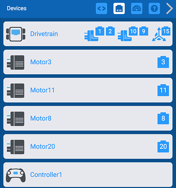

Initially lets setup a 4 motor drive in blocks using the first motor on each wheel. Configuration would look like this.

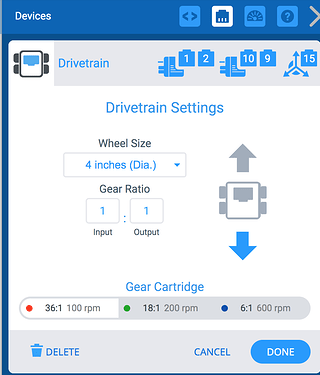

Motors on ports 1, 2, 9 and 10 have been configured, the drive has the down arrow selected, this will set left motors to be reversed and match my usual C++ configuration.
Now we create the four additional motors and a controller, reverse flag is set on the motors as needed.

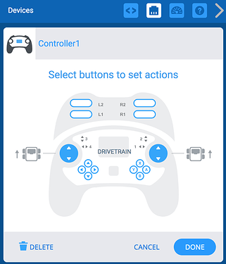

drivetrain is configured as tank control on the controller.

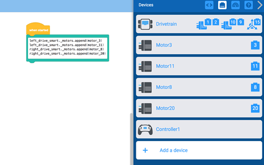

Now we add this code in a switch block.
left_drive_smart._motors.append(motor_3)
left_drive_smart._motors.append(motor_11)
right_drive_smart._motors.append(motor_8)
right_drive_smart._motors.append(motor_20)
build and run, 8 motor drive works as intended.
