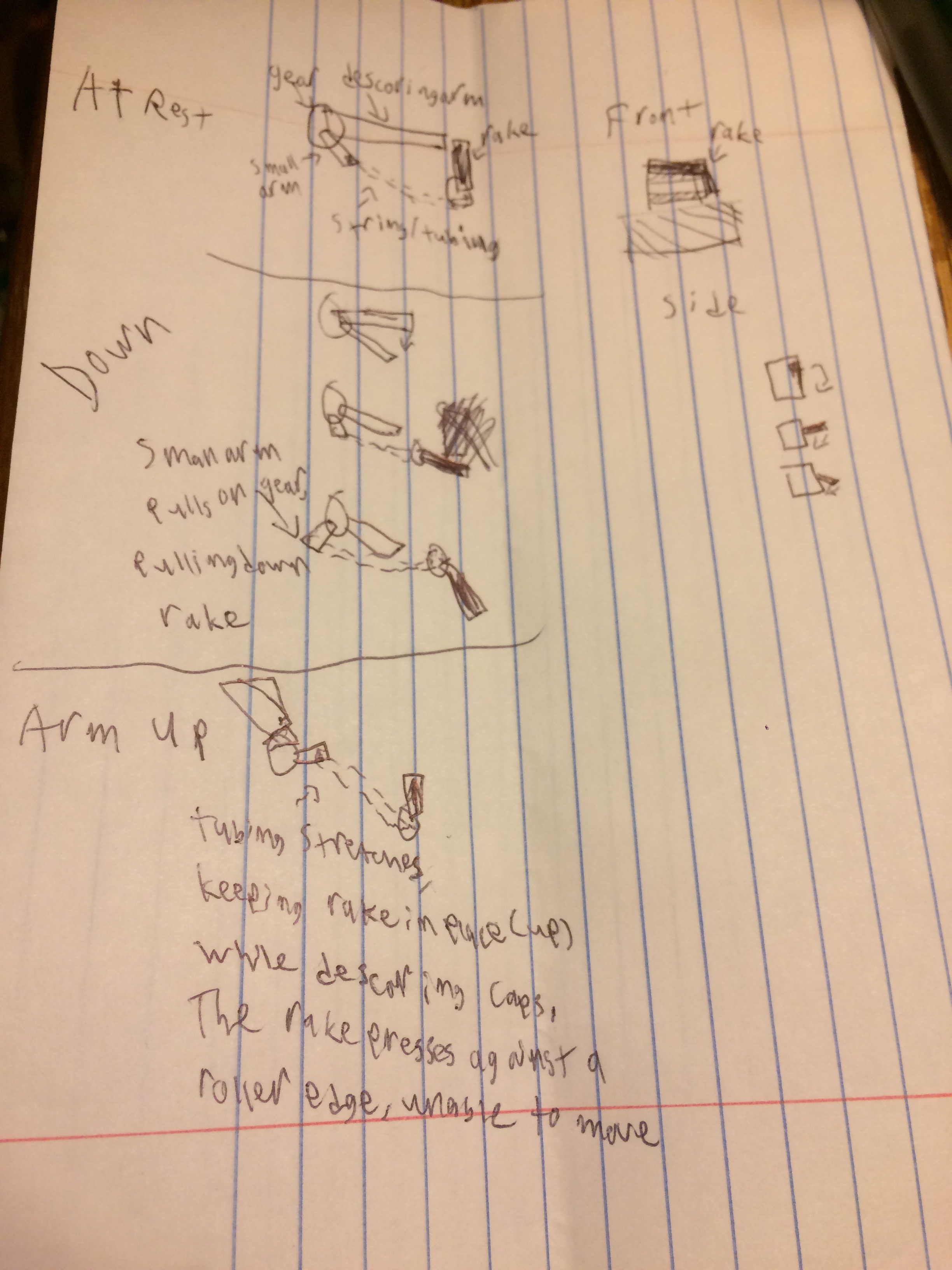

To get back on topic, I came up with a spectacularly intricate linkage for dual-purposing a descorer into a separate ball rake. Really too late to help, but I might be able to dig it up if anyone is interested.
@Got_a_Screw_Loose I’d love to see. Feel free to post it.
I think that descorers are only really great if you can also score or do some other function. Ball retrieval is turning out to be crucial to a lot of turning point, from autonomous routine to pulling balls out of the corners of the field. But caps can give you an excellent edge especially if your opponents can’t descore. It’s just that caps are so hard to score that nobody likes them. Our team has a dual purpose scorer and descorer. Works fairly well but we haven’t focused on caps for obvious reasons. I am betting now that at least three of the cap posts will be used in the finals at worlds. But the main focus will still be flags.
I forgot to draw a rubber band pulling the take back into the “up” position, but you get the point. This was an old thing I thought up, and never really put any more thought into.
