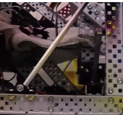

Seems like the main issue is that center gearbox. One thing that I found very helpful is to make the center gearbox as 1 large and robust piece instead of building separate sides. I will attach a picture of my ITZ worlds robot to show you what I mean but I like to build it by having 2 horizontal c-channels connected with 4 vertical c-channels to make a very sturdy frame. I like to have everything in between the pockets created by the vertical c-channels because it forces me to connect the c-channels directly to the gears (which I have found to work better, not entirely sure why) and gives a challenge of having the shortest shaft length possible. I was able to fit everything within 4 holes horizontally this year.
