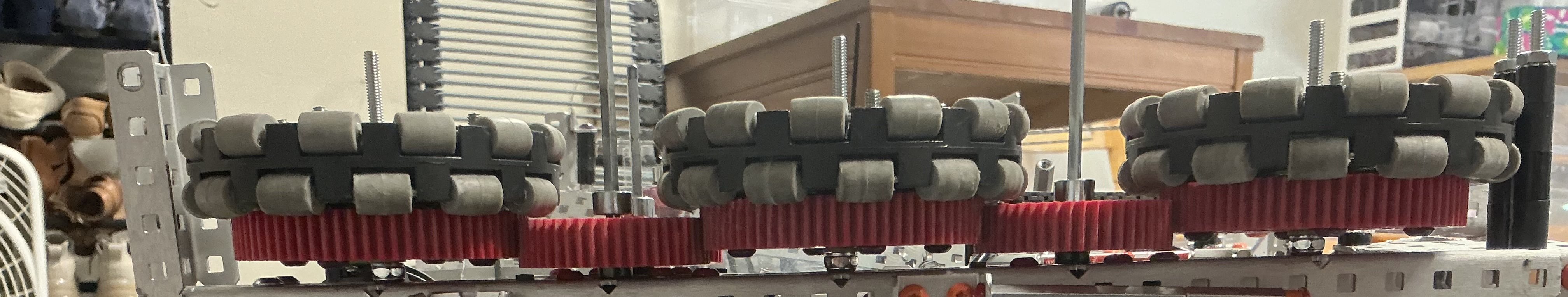

Our drivebase is really slow compared to other teams in our area. When we put in our wheels, we have to pull apart our gears a bit to fit them. how can we reduce friction on our drivebase?

here is a photo. btw we removed the c channel while troubleshooting it
Are you using shoulder screws for the screw joints? If so was the outer c-channel connected with anything other than those 2 screws in the front and that 3-wide in the back? If there were more connection points, the problem was likely with the outer c-channel.
The Outer C-Chanel did cause friction, but another problem we have is that our motor can wiggle a lot when we connect them with shoulder screws (0.04 in.)
We also only connected the outer C-Channel using the two screws and the 1x3x1 C-Channel
I meant to ask if the screws for your screw joints were shoulder screws, not your motor screws.
I would recommend 2-3 full-length braces (including back 3-wide c-channel) for better structural integrity, and it would secure the outer c-channel better than it was, which may solve your issue.
Our Screw joints are shoulder screws
