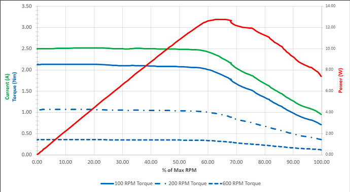

5.5W motors have significantly less torque than 11W motors. Even 2 of them will not match an 11W’s torque. (I am referring to a 600RPM cartridge torque as shown in this photo);
Take a look at this topic: Motor Torque, RPM, andPower

Is there any reason why you would like to use 5.5w motors on each side over a single 11w on one side? The max rpm of the 5.5W motors (200rpm) would not change with one on each side, but considering this is supposed to lift a heavy mechanism, I don’t believe you are trying to reach/increase that max rpm. Adding a second 5.5W motor would provide more torque than a single 5.5W motor attached to the axle, but the torque from a single 11W motor is still greater than their combined torque. If you are trying to have more torque, use an 11W motor with either the green or red cartridge. If you are worried that the axle will twist under load or that the asymmetry of having an 11W motor on only one side doesn’t fit in your design, then you should likely use the 5.5W motors on each side.

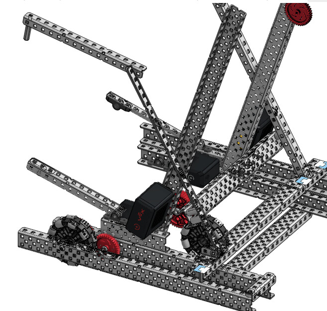

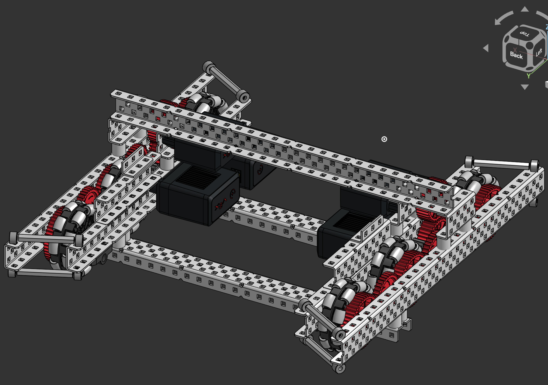

Brace your drive more, at least 2 full length braces, and here is the start of my cad for this season:

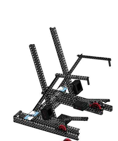

I plan to use it to rotate the clamp mechanism attached to my Cascade lift from the inside out, but I think powering it with a single 11W motor might be unstable.
What’s the point of that c-channel on the stacked motors? Can’t you just mount that on the base normally?
I could but that is for cascade
I’m mounting my cross braces flat, imo there’s not really a need but everyone’s ideal designs are different so it’s fine
slant cascade :cold_face: (20charrr)
